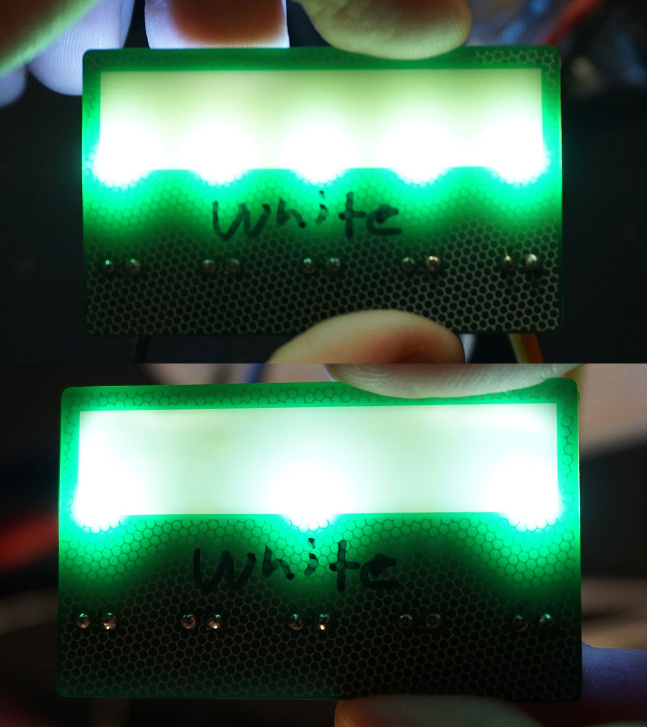

I designed a simple prototyping board so that I could get measurements and figure out how to best work with these LEDs before I put them in a project. I am very glad I did this because despite having seen other examples of Side View LEDs being fantastic drop in solution for back lighting PCBs I instead found it had its own draw backs.
- Uneven Lighting
- So this is similar to the light propagation problem before but not exactly the same. To my surprise the part of the light that actually shines on/through the board isn't nearly as much as I expected. As a result the light looks rather dim and uneven. I can handle uneven but dim is a no go
- Intense amounts of light bleed
- I expected light bleed to be an issue but this is a whole other level. These LEDs can be really damn bright and nothing is more distracting than having a LED shining directly at you in the corner of your peripheral vision. This is just a waste.
I used a Sony A5100 Mirrorless Camera to take these pictures, my iPhone X that I use for most of my photos blows out the light too much and makes it look brighter and more distributed than it actually is. My A5100 still makes it look better than it really does but it's the best I could do.

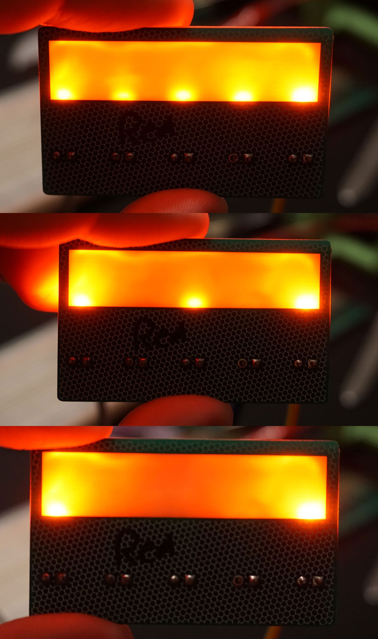

So, how can we salvage this? Simple: Hot Glue.
To control the light, make it spread out evenly, and to dramatically reduce the light bleed we need the light to have a medium to travel through so I chose Clear Hot Glue. Hypothetically you could use Epoxy too but Hot Glue is cheap, readily available in large quantities and can be easily removed if need be.
This solution worked even better than I had expected. In some cases I was able to reduce the number of LEDs from 5 to just 2 while still covering the same area and getting an acceptable brightness level. This doesn't even take into full account of positioning the LEDs in different directions. As long as the LED shines into hot glue there won't be remotely as much light bleed and it will be distributed fairly evenly.
Below you'll see a lot of examples of this technique in action. Unfortunately my Glue Gun has been used mostly with Black Glue Sticks so my results were hampered a little by black and gray artifacts that wouldn't normally be there. Even with these artifacts using Side View LEDs with some sort of additional medium can yield very impressive results.
Of course this technique isn't perfect and it's still a fair amount of work after assembling the board but I think the results justifies the extra steps. I'm looking forward to seeing future results and additional iterations on this technique, especially after a little more practice applying the hot glue itself.
