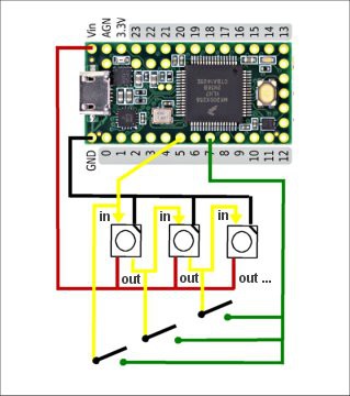

CIRCUIT BOARD

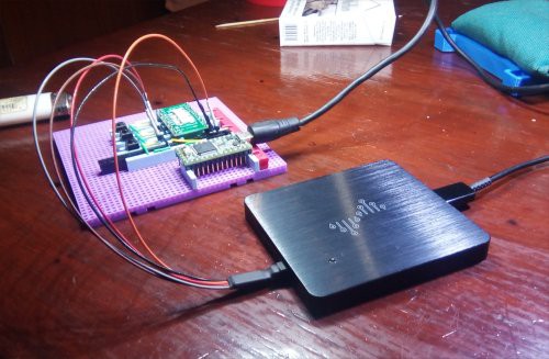

I have a couple of ws2812 arrays sitting around (an 8x32 and a 4x4), but I don’t have any strips.  That’s a shame because the strips look like you can easily cut one off and work with it.  You probably have a strip you can just cut up!  I don’t want to cut up the arrays, but I do happen to have a bunch bare ws2812 LEDs that I bought experiment with.  So I rummaged through my stuff and found a little circuit board I could solder them to.  That being about my third try to air-solder SMD’s, I glued them on with superglue, a little too much in one place, and then glommed some paste solder on em with a toothpick, and blew hot air on em.  Even though it was only 215C, I basically tortured the LEDs as I had to burn through the superglue on one of the contacts.  Nonetheless, they conduct electricity, and there are no shorts.

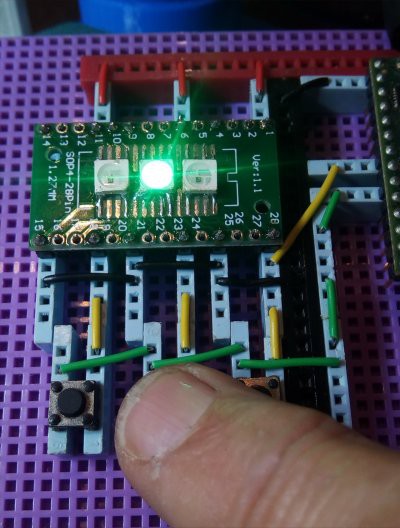

I added some pins to the board, so then I had three ws2812’s I could play with on a breadboard.   If you want to build one of these, you probably can just cut one off a strip and use alligator clips or whatever it takes to hook them up.
The first circuit I made used jumper wires.  Much to my surprise I hooked up the 5V and ground and got the Teensy example basic ws2812 test program working with my little 1x3 array of LEDS in a few minutes,.
So then I decided to try to write some code to make it work as a switch array.
THEORY OF OPERATION
As you send serial data to the LEDS (actually, to the first LED’s DIN – data in - pin) using the ws2812 protocol, each LED takes 24 bits to display an RGB value.  OK, actually it’s GRB, but that’s not important!
After the first LED “eats” the first 24 bits, it starts passing the remaining bits onto the next LED. So the second LED does not see any bits (rising edges) until the first LED is done with those first 24 bits.  Then the second LED “eats” the second 24 bits before it starts passing the remaining bits to the third LED, and so on.
The other thing worth knowing is that each bit in the ws2812 protocol, both ones and zeros, has a HIGH and a LOW part.  So, even if you send all 0’s to the LED’s, and don’t turn any of them on, you still send 24 rising EDGES to each LED.
What is interesting about all this is that it provides each LED with a unique timing signal.
If we then connect all the DIN pins from each LED, through switches, to a common wire, and we hook that wire up to a single digital input on the Teensy,  we can tell WHICH BUTTON is pressed, if any.
More precisely we can determine the FIRST (lowest numbered) button that is pressed, or if none is pressed.  This initial circuit/algorithm cannot detect multiple simultaneous presses but I believe with the addition of a minimal amount of hardware, it could.
Before we start writing the “frame” of all three pixels, we set a variable for the “current button” to zero.   Then just after we write the HIGH rising edge for each bit, we check whether or not there is a corresponding HIGH on the input wire.  If there is, and it is the first HIGH we have sensed during this “frame”, then we know that it must be the switch associated with the LED we happen to be writing the bit to.
BAD CRUDE CODE WORKS lol
Although we *could* just check once per LED (per pixel), and a lot of work could be done to make the timing more precise, and the code more efficient, perhaps even using DMA, I just rammed together some bitbang code to write to the LED’s, got that barely working, and then stuffed some digitalReads() into the sendPixel() method to see if anything would work.
When it sort-of-worked the very first time, I was so pleased I decided to make a better breadboard circuit, take some pictures, and post this page so others could see it.

I DID notice that it is wrong to hook all the dins together. If you press two buttons at once you short circuit the bit stream. A diode at each switch should solve that problem, but i still can't figure out how i would differentiate two simultaneous button presses.
