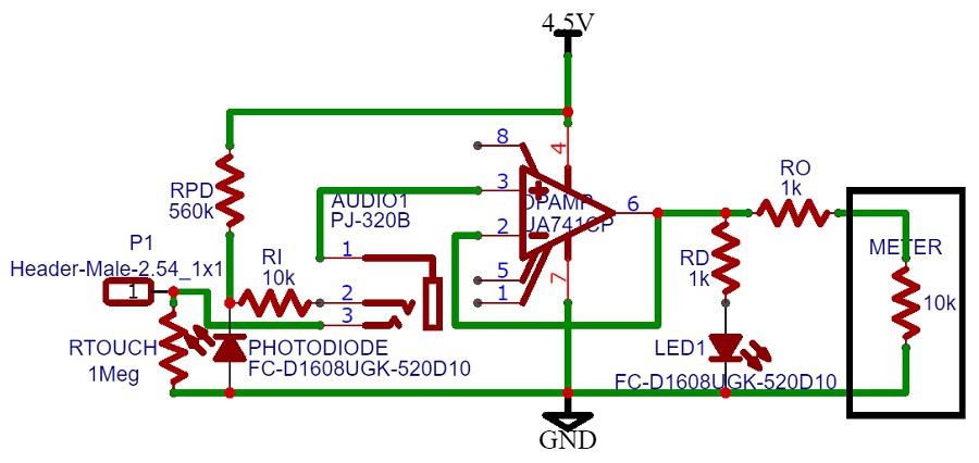

This circuit does not waste any resistor on feedback. An op-amp with zero resistance feedback does not need capacitors and has a high frequency bandwidth. A high resistor feedback will also limit the circuit applications. However, this circuit can only amplify current source inputs and does not amplify voltage sources.
I drawn the circuit in https://easyeda.com online simulation and PCB design software.
The Ro resistor is used for short circuit protection to prevent op-amp failure. Ri is used to protect the photo-diode from short circuits because op-amp input wire can be connected to power source or the photo-diode circuit output can be accidentally grounded. In both of those instances the photo-diode will fail, unless a 10 kohm resistor is placed in series (shown in the circuit diagram). A similar circuit was implemented for the infra-red receiver. Rtouch resistor is used prevent op-amp saturation due to disconnected inputs for the touch sensor. I connected to oscillator directly to the op-amp input. Than means that negative voltage was entering the op-amp.

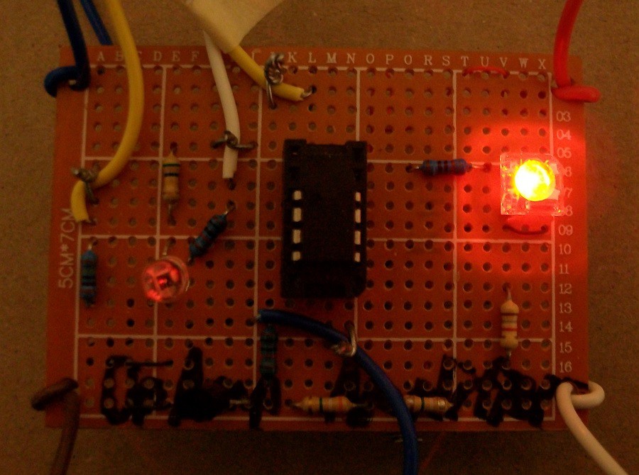

I used the well known LM741, 8 pin op-amp. However, I did not have an 8 pin wire wrap socket in stock. I used wire wrap tool and a bit of soldering. The black transistor looking component at the bottom is actually an infra-red photo-diode. The normal light photo-diode is on the right of the circuit.
The yellow wire with a masking tape is connected to op-amp positive input terminal. The white wire is connected photo sensor circuit output. The blue wire at the bottom of the photo is connected to infra-red sensor circuit output. The blue wire at the top left corner was connected to signal generator and the other end to op-amp input (the yellow wire with masking tape). The yellow wire is touch sensor circuit output. You might not need to bias the op-amp input wit the Rtouch 1 Megohm resistor if the LED is OFF. I tried touching with one finger and two fingers (the other finger connected to power supply). The circuit worked with one finger when Rtouch was disconnected.
