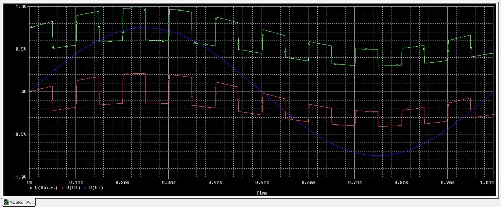

Step 2: Simulations
I used an old PSpice software for simulations:
Bipolar Junction Transistor Modulator
MOSFET Transistor Modulator
The graph above is showing that the MOSFET transistor is not saturating. There must be something wrong with the MOSFET component model in the PSpice software student edition that I used. Usually MOSFET transistors would have a higher voltage current gain than the value specified in the model.
