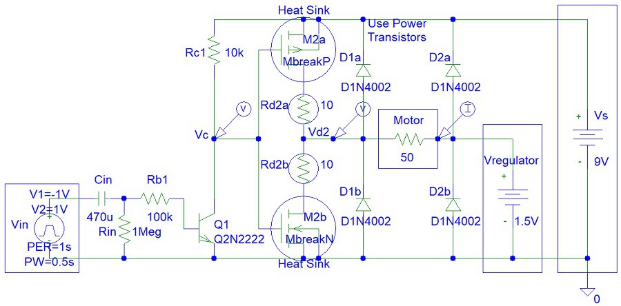

This article presents a simple power transistor inverter and MOSFET motor driver:
I designed a more simpler circuit to implement the control system in the following on Hack a Day article:

Step 1: Design the Circuit
This is my circuit drawn in the old PSpice software:
Later I modified the circuit to work with a Zener diode:
This is a well known MOSFET motor driver circuit. It is used for H-bridge MOSFET circuits. However, this circuit might cost more money. You also have to be careful to make sure you not exceed the maximum gate voltage, the MOSFET input voltage.
I also replaced the capacitors with a voltage regulator. Some voltage regulators might have a minimum input voltage above 3 V that I specified as a power supply for this circuit. Thus you might need to increase the power supply voltage.

I used Enhancement Type MOSFET.
Step 2: Make the Circuit
I used a 3.3 V Zener diode instead of 4.3 V Zener diode because this is what I had in stock. The use of a voltage regulator will prevent power loss caused by the 100 ohm Rz resistor.
