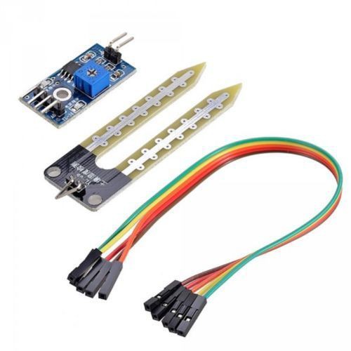

There are many different types of Soil Moisture Sensors but their working principle is the same. All of these sensors have at least three pins: VCC, GND, and AO. The AO pin changes according to the amount of moisture in the soil and increases as there is more water in the soil.
Connections
  1. Connect the two pins from the Sensor to the two pins on the Amplifier circuit via hook up wires.
  2. Connect the Vcc from the Amplifier to the 3.3V pin on the Arduino and the Gnd pin to the Gnd pin on the Arduino.
  3. Now connect the Analog Data Pin to the A0 pin on the Arduino.
