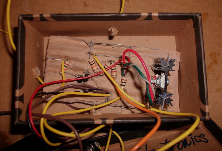

Step 2: Make the Circuit
I only used a soldering iron for the power transistor. I used an old BD140 PNP power transistor from an old VCR (Video Cassette Recorder). It must have been used to drive the tape motors.
I did not implement the power supply filter. This circuit is optional.

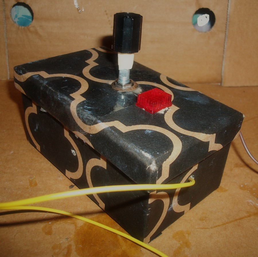

Step 3: Encasement
I used a nail to create the hole and widened with scissors:

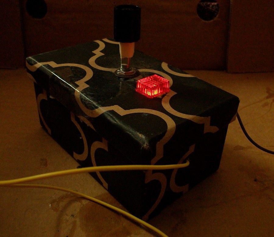

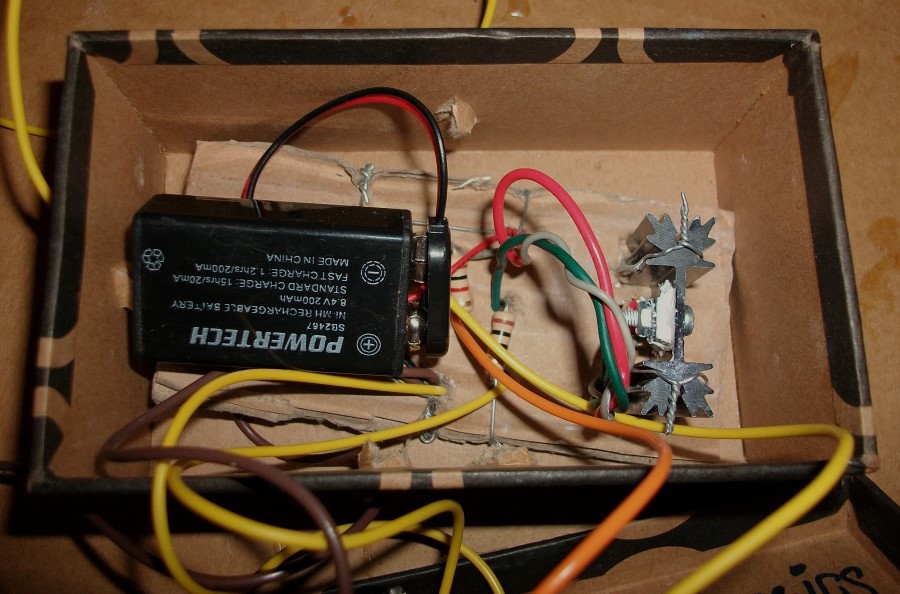

Step 4: Power Source
9 V battery proved to be sufficient for the 12 V light motorbike signalling bulb.
Step 5: Testing
My circuit has good control over the bulb brightness because I used only two transistors instead of three.
