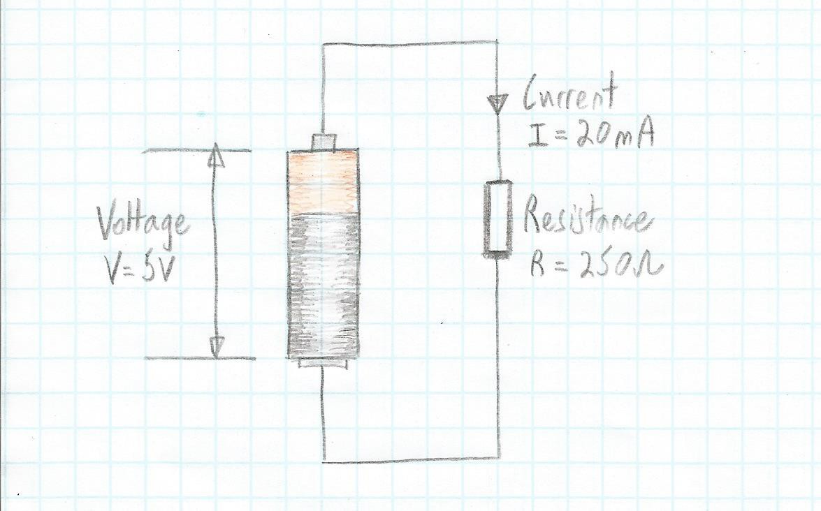

A simple circuit comprising a battery, a resistor, and two pieces of wire (Image source: Max Maxfield)
At the end of the column, we noted that we qualified the resistors shown in the first image as being “0.25 watt resistors.” (We might also write this as “1/4 watt resistors;” in conversation, we would say “quarter watt resistors”.) Well, now it’s time to explain what we meant by this.

As an example, let’s consider the circuit we showed earlier, remembering that we have to work in units of volts, amps, ohms, and watts, and that 20 mA (twenty milliamps) equates to 0.02 A.
      P = I * V
      P = 0.02 * 5
      P = 0.1 W or 100 mW
As we see, in this case, the amount of power that has to be handled by the resistor is 0.1 W or 100 milliwatts (mW).
Why don’t you try performing similar calculations for yourself, but instead of using V and I, first use V and R, then use I and R. Obviously you should see the same 0.1 W (100 mW) result in all cases.
