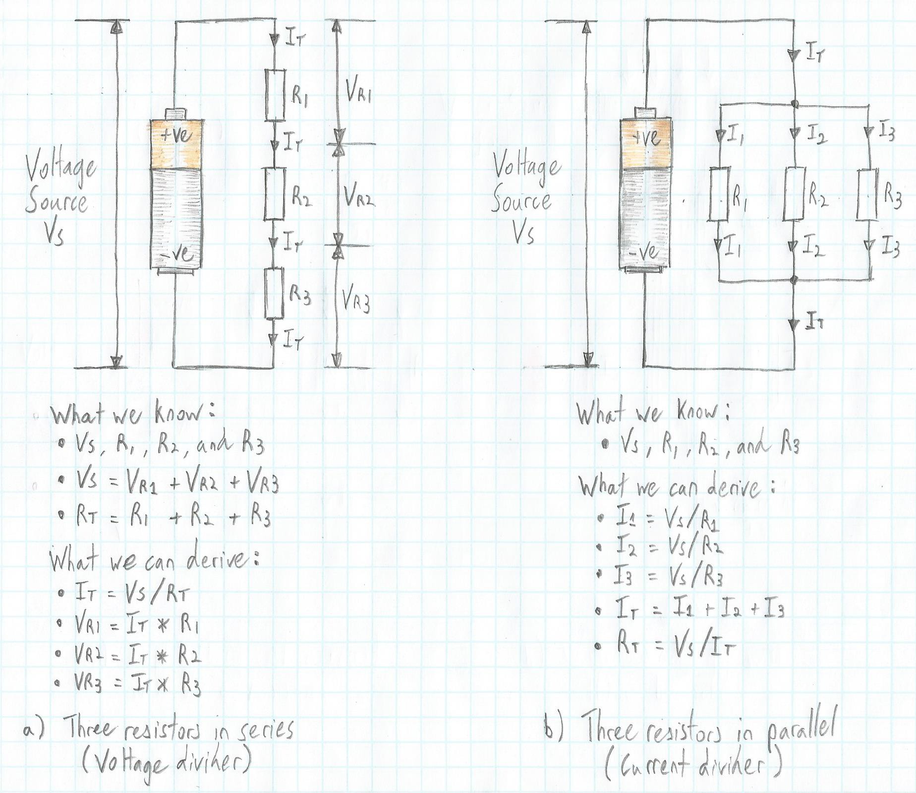

OK, now let’s compare our series and parallel circuits in a little more detail. Let’s start with the series circuit shown as (a) in the diagram below.
Comparison of circuits with three resistors in series and in parallel (Image source: Max Maxfield)
Let’s start by assuming that we know the values of VS, R1, R2, and R3. We also know that, neglecting any tiny voltage drops associated with the minuscule resistance of the wires, the sum of the voltages across the resistors, VR1, VR2, and VR3, will equal the value of the source voltage VS. Last, but not least, we know that the total resistance of this circuit, RT, equals the sum of the individual resistances R1, R2, and R3. Apart from anything else, this means that the value of RT will be greater than the value of any of the individual resistors (I know this seems obvious, but we are setting the scene for what is to come).
Since we know the value of VS and we know the value of RT, we can use Ohm’s law (see Part 5) to calculate the current: IT = VS/RT.
Even better, since we now know the current, IT, we can again use Ohm’s law to calculate the voltage drops across the individual resistors: VR1 = IT * R1, VR2 = IT * R2, and VR3 = IT * R3.
One final point regarding the resistors in series is that, since the current is the same throughout the circuit while the voltage is divided across the individual resistors, this is known as a “voltage divider.” By comparison, in the case of the parallel circuit shown as (b) in the diagram above, the same voltage, VS, is presented to all three resistors while the current is divided between the individual paths, so this is known as a “current divider.”
With regard to the parallel circuit, let’s assume once again that we know the values of VS, R1, R2, and R3. From this, using Ohm’s law, we can derive the currents in the individual branches: I1 = VS/R1, I2 = VS/R2, and I3 = VS/R3.
But wait, there’s more, because – based on our water analogy at the beginning of this column – we can calculate the total current: IT = I1 + I2 + I3. And the fun just keeps on coming because knowing the values of VS and IT means we can use Ohm’s law to calculate the total resistance of the circuit: RT = VS/IT.

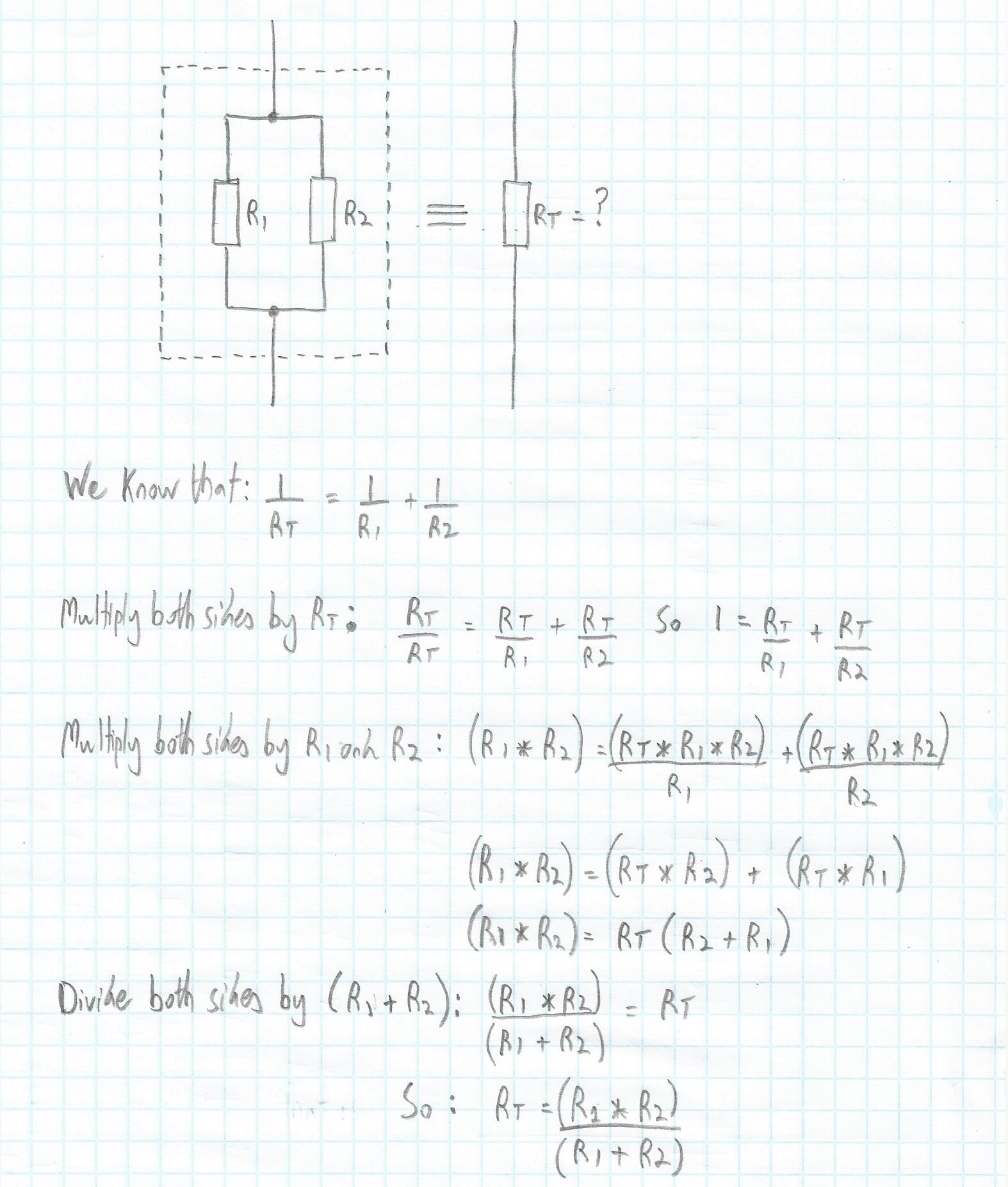

Hang in there, we’re almost at the finishing post. As opposed to the general case for ‘N’ resistors in parallel, there’s also a special case for two resistors in parallel as illustrated in the diagram below.
Special case for two resistors in parallel (Image source: Max Maxfield)
You can follow our derivation in the above image. The bottom line is that, for two resistors in parallel, RT = (R1 * R2)/(R1 + R2). But wait, there’s more, because if two resistors have the same value, R, then the total resistance of these two resistors in parallel is R/2.
What? You don’t believe me? Well, let’s give this a whirl using our generic equation for two resistors in parallel. Let’s suppose that both resistors have a value of 120 ohms (120 Ω). In this case, RT = (120 * 120)/(120 + 120) = 14,400/240 = 60 Ω. I know, it’s like magic, right? (Observe that at no time did my hands leave the ends of my arms!)
