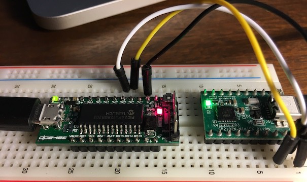

I decided to design and produce a small embedded machine with Forth preinstalled. I selected FlashForth, written by Mikael Nordman, as the Forth environment. The first hardware version was in a DIP form factor, similar to an Arduino.
I quickly came to the conclusion that the breadboard wasn't always necessary, and so the form factor of the machine changed. By using a single inline connector on the underside of the PCB, modules or devices could be wired in directly.
The addition of a pin strip allows it to be inserted into a breadboard. Alternatively, it can be mounted into another PCB as a Forth-based compute engine.
