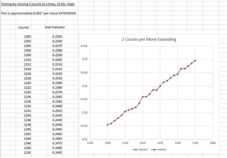

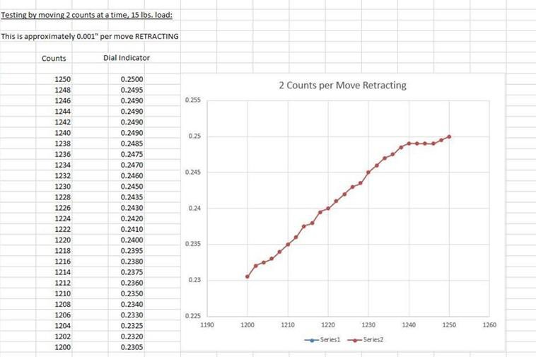

We had an independent test performed on our PA-12 actuators to calculate its movement precision. The test was to accurately execute two servo counts per movement command, which would amount to 0.001074” per move. Measurements were gathered using a precision laser position indicator and the actuator also had a 15 lbs load attached to it for both extension and retraction. The results can be seen in the graphs below.
Most common instruments cannot accurately perceive a change in position that small. If the actuator were moving in larger increments, the results would have been even more precise. This movement is based on two factors – high precision from the built-in potentiometer and a properly calibrated PID controller. The parameters for PID control can optionally be changed through the digital commands but it is not recommended.

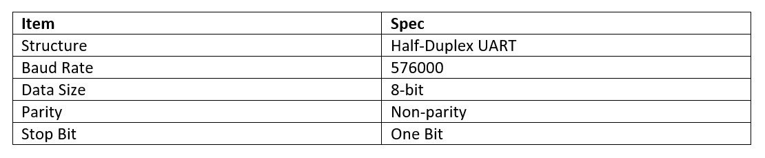

Both TTL and RS-485 represent standards in serial communications. They provide a framework to develop a set of commands and responses in 8-bit format that could be used to interface with the on-board microcontroller in PA-12.
The communication parameters for serial data connection for both TTL and RS-485 are shown below:

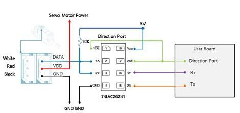

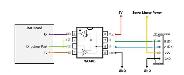

The data structure for communication with the PA-12 on-board microcontroller is half-duplex UART. A full-duplex communication system allows both devices to transmit and receive data simultaneously. In the case of PA-12, the system is half-duplex, also known as semi-duplex. This means that the devices can communicate to each other, but not simultaneously. At any time during communication, one device must transmit while the other one receives, and vice-versa.
For this reason, if you are trying to communicate with a PA-12 through a full duplex serial com device, you will need to use a buffer in between.
For TTL/PWM communication between a full duplex device and PA-12, we recommend implementing a 74LVC2G241 chip to act as a buffer. A full-duplex device can be something like an Arduino microcontroller. For detailed information on how to set this up, you can take a look at our article on getting started with Arduino and PA-12.
For RS-485 type actuators, we recommend using MAX485 chip as a buffer between a full duplex controller and the half-duplex PA-12 device. Of course, communication devices that are themselves half-duplex would have no problem communicating with PA-12 directly. For example, Allen-Bradley 1769-ASCII PLC module can communicate with the PA-12 directly.

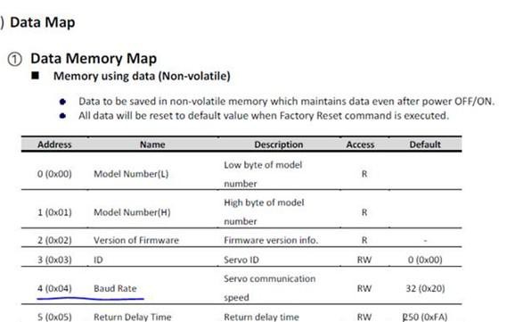

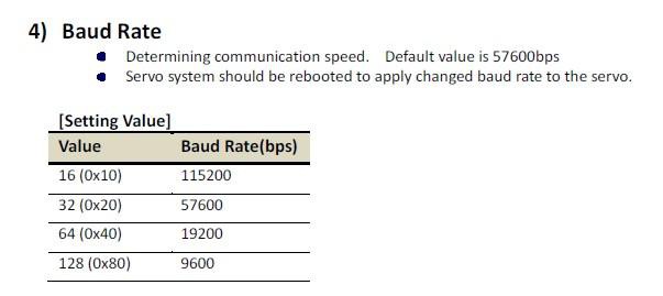

Baud rate represents the speed of communication between devices over the data channel. The default baud rate of PA-12 actuators is set to 57600 bps. If your communication device uses a different baud rate, then there are two ways of changing it. The easiest way is to connect the PA-12 to a PC through our LC-12 interface controller and make the changes through the app. Alternatively you can also set the baud rate through the RS-485 write command. This will require you to do the following:
1. Set the baud rate for the communication module to 57600.
2. Write the desired baud rate in memory address 0x04.
3. The value for the baud rate in address 0x04 must be set to one of 4 specific values, with 32 corresponding to 57600 being the default.
4. The PA-12 must be rebooted for these changes to take effect. You will have to turn the PA-12 off, then change the baud rate on your communication device and turn the system back on.

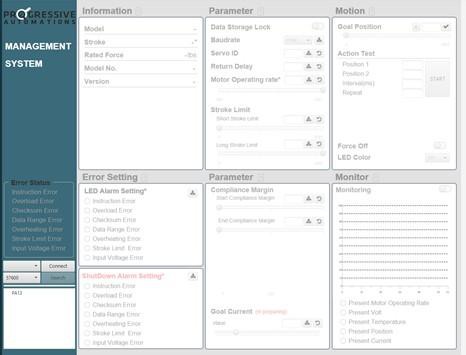

The easiest way to communicate with the PA-12 internal computer is through the LC-12 PC interface controller. It can be used to connect to both TTL/PWM and RS-485 actuators. The LC-12 is also required to download and install firmware upgrades.
The interface controller can be used to conveniently set operation parameters for the PA-12 actuators. For examples, in particular applications you may want to set extension and retraction limits, baud rate, maximum temperature, maximum current, maximum allowable position error, and so on. In large quantities, Progressive Automations will pre-program all the units but if you are dealing with production quantities of 50 or less, it may be easier to set the parameters through the interface.
LC-12 can be used to test the motion of the actuator without having to get bogged down trying to set up the TTL and RS-485 communication. The LC-12 will always be able to connect to the PA-12 actuator if there are no hardware issues. This could be useful when monitoring the parameters set in the memory data map to make sure nothing is out of place and fix the errors if necessary.
The PA-12’s internal computer will be able to self-diagnose issues and display error codes during operation. It may be difficult to tell exactly what is wrong with the actuator when simply receiving the feedback signals. The LC-12 PC interface would be able to search and display the errors that the actuator generates and make it easier to tell how to fix the issues. For example, if the actuator is not reaching the goal position, you can take a look at the error display and the current monitor on the interface and determine that there is an obstruction in the way.
Finally, the LC-12 PC interface controller has two important functions for the PA-12 actuators that make it an essential companion for initial sampling and troubleshooting. The LC-12 is the only way to reset the actuator back to default factory settings and to apply firmware updates.
