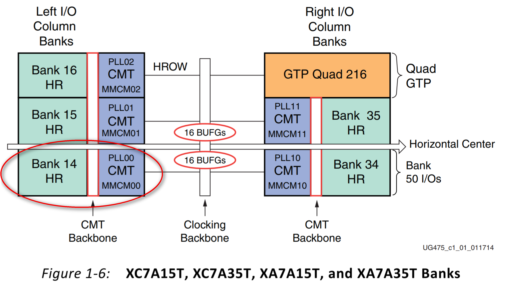

The external connections to the XC7A35T FPGA are divided into 6 banks, labeled 14, 15, 16, 34, 35 & "GTP Quad 215". The numbered banks are of the "HR" type (see below). The GTP Quad bank is a collection of high speed serial transceivers, supporting line rates between 500 Mb/s and 6.6 Gb/s, that can be used to implement protocols such as PCI Express, SATA, SDI and others.
These FPGA architectural banks are not to be mixed up with the "A", "B", "C" and "D" bank connectors on the Au circuit board.
On the FTG256 package, Only banks 14 and 15 have their I/O pins fully exposed to the world. Bank 34 is only partly exposed. Bank 16 and "GTP Quad 16" are not exposed.

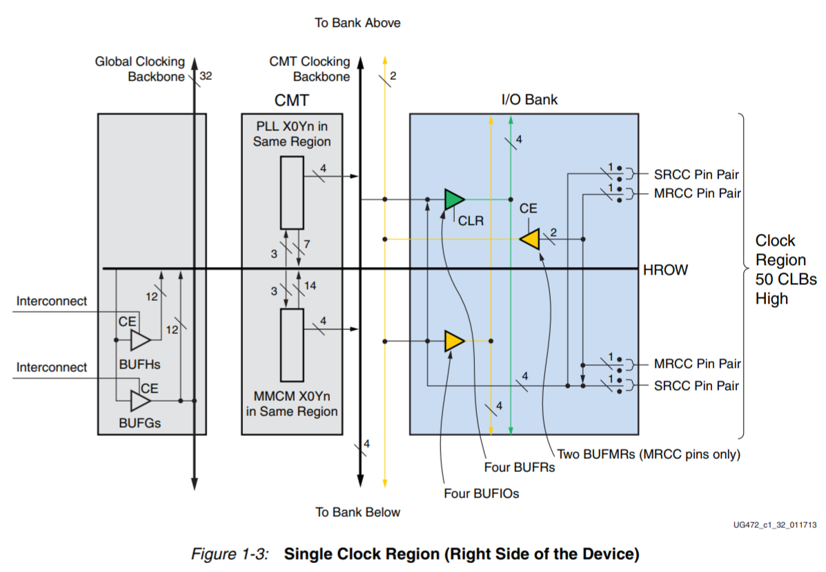

Each numbered bank has a Clock Management Tile (CMT) with two clock connections that can be either single ended, or differential inputs. The MRCC connections can be connected to the GLOBAL clocking network of the FPGA.

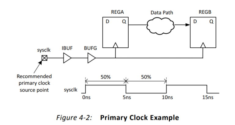

Because this is a primary clock, it will be connected by the synthesis tools to the GLOBAL clock tree through an input buffer and a GLOBAL clock tree buffer.
In summary, N14 is defined to be the clock input and the constraint files tell the synthesis tools how it's connected.

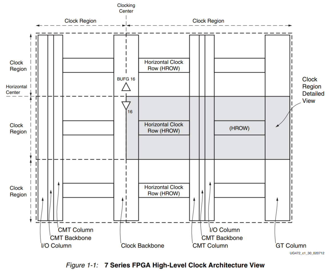

Like all Series-7 Xilinx FPGAs, the XC7A35T used on the Au board is divided into regions. The the clocking backbone divides the device into left and right sides while the horizontal center line divides the device into top and bottom halves.
The resources in the clock backbone are mirrored to both sides of the horizontally adjacent regions, thus extending certain clock resources into the horizontal adjacent region.
All horizontal clock resources are contained in the center of the clock region horizontal clock row (HROW), and vertical, non-regional clock resources are contained in either the clock backbone or CMT backbone.
The top and bottom division separates two sets of global clock buffers (BUFGs) and imposes some limitations on how they can be connected. However, BUFGs do not belong to a clock region and can reach any clocking point on the device.
Our 100Mhz master clock is connected to pin N14, which is in Bank 14 and can be connected to CMT0 (and it's MMCM or PLL modules) via the CMT backbone.
From there, the MMCM (or PLL) output can be connected back to the clocking backbone by a GLOBAL buffer (BUFG) along an HROW and distributed to the rest of FPGA.
The clock input pin is routed through an input buffer (IBUF) and a BUFG.

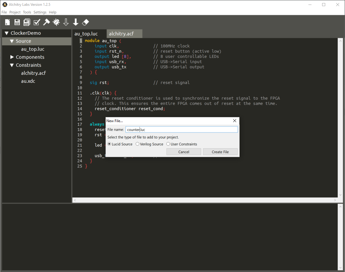

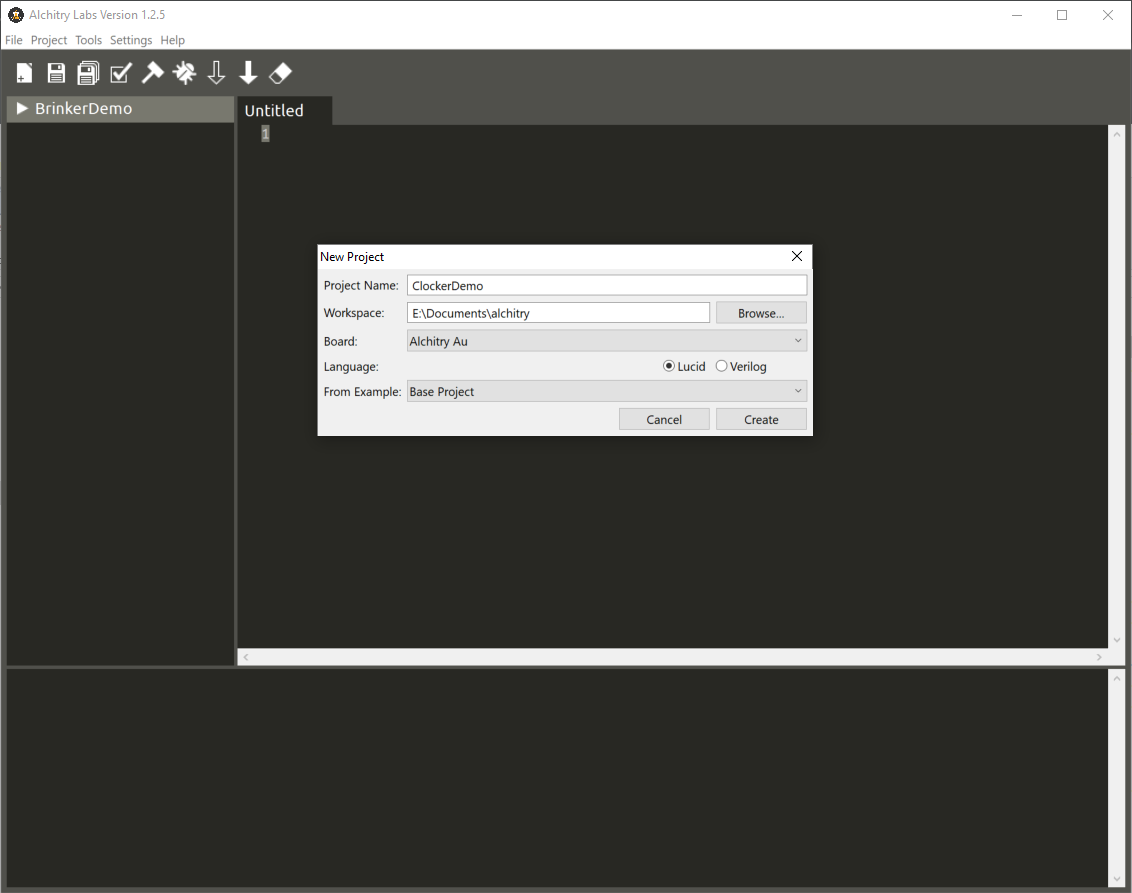

So here is where the rubber meets the road from a practical standpoint. We'll start off by creating a new base project in Alchitry Labs - I'm calling it ClockerDemo.
Next we'll create a new counter module to be driven by the clock of our choosing. This one I'm just calling "counter".
The code for the counter module looks like this, and is a 32 bit counter, driven by the clock of our choosing with the 8 most significant bits being returned for later display on the Au LEDs.
The top module declares an instance of the counter and connects to the LEDs.
Build the project and upload to the Au. You should see the counter display on the LED's at a fairly good rate, since it's being currently driven directly by the 100MHz primary clock input.

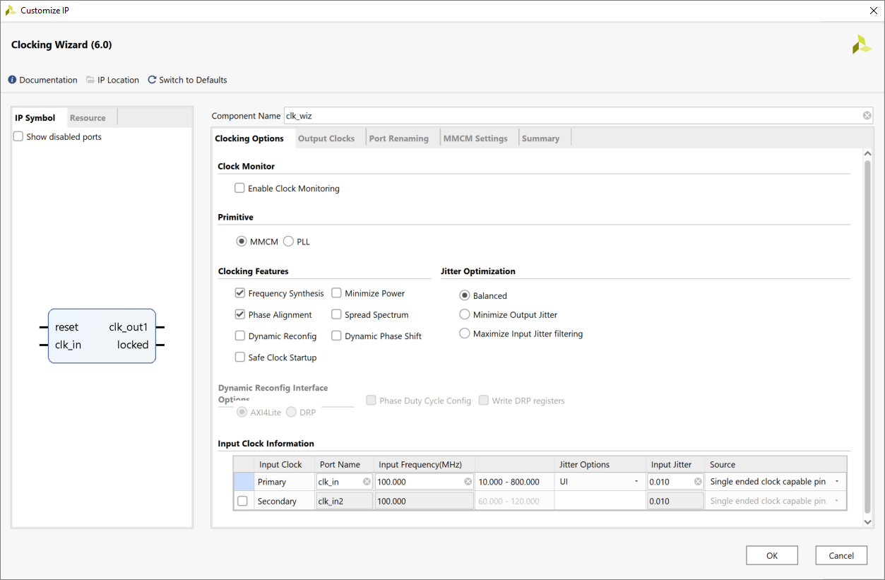

MAKING THE NEW CLOCK

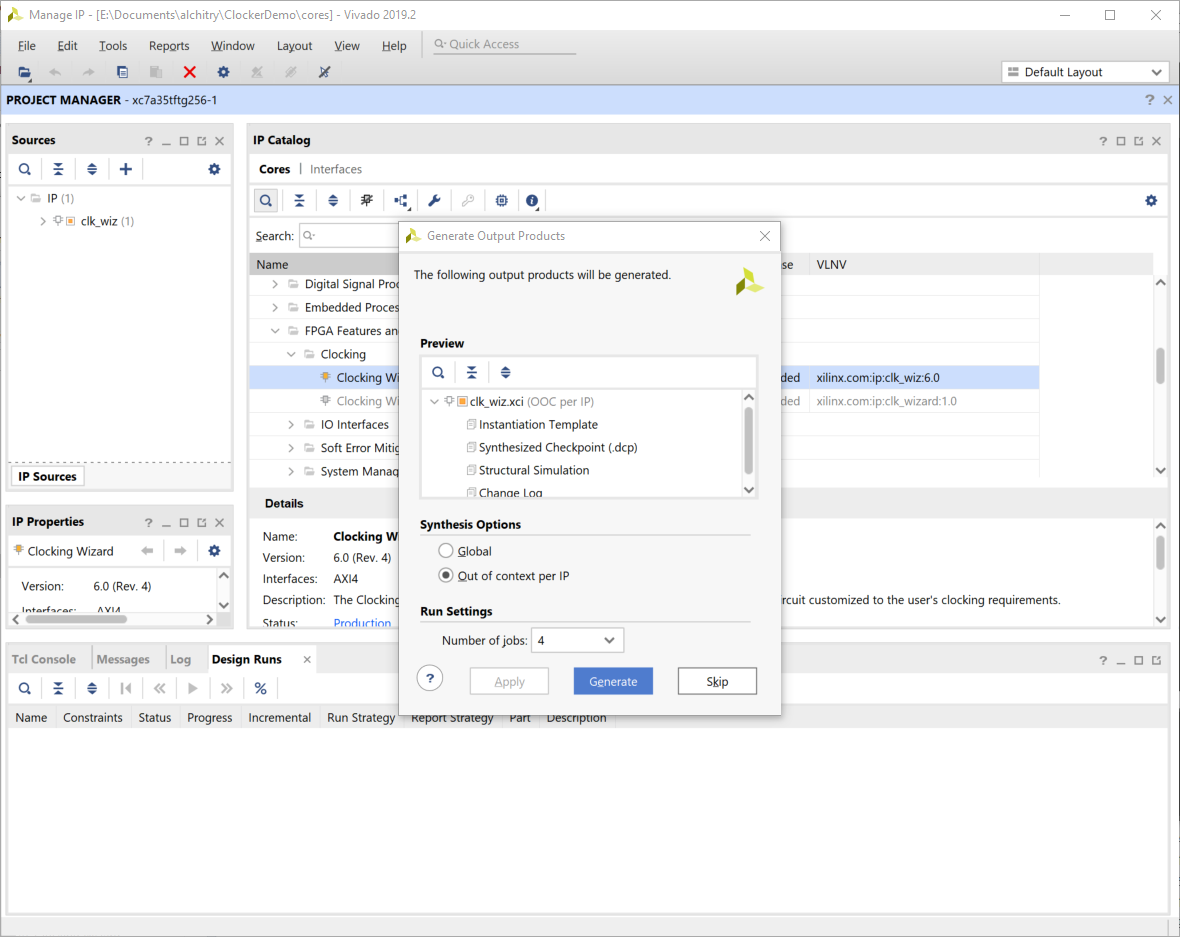

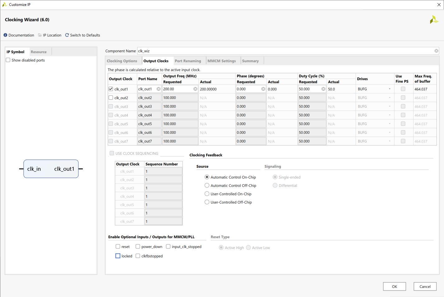

We're going to create a new clock component that uses one of the CMTs (Clock Management Tiles) to generate a new clock from the primary clock input. To do this we're going to launch Vivado from AL's Project --> Vivado IP Catalog menu.
Vivado should launch and show it's IP catalog. Scroll down to FPGA Features and Design, choose Clocking, then double click Clocking Wizard to launch.
The first thing to do is to name you're component. Although you can come back to edit later, the initial name is a one-shot deal. You won't be able to rename the component after it's been initially generated.
For this demo, I just chose to get rid of the "_0" suffix and call it "clk_wiz".
On the Clocking Options tab, just leave the selections alone. You can choose between using the MMCM or the PLL module - both have some minimum frequency differences - and I'll leave that for your to explore on your own. We are doing Frequency Synthesis, so leave that checked. Phase alignment with the input clock is not important for this demo, so leave that checked as well.
The Input Clock Information is also set up for us, however I'm going to edit the port name for the Primary Input Clock to just "clk_in". The MMCM module will be expecting a 100MHz input signal, and is coming from the Single-ended clock capable pin, N14
We'll be driving the GLOBAL clock bus, so leave the drive set to BUFG.
At the bottom of the screen we can delete the optional RESET input and LOCKED output.
There are no ports or pins to rename, so nothing to do on the Port Renaming Tab. Likewise we're not going to override any of the Wizard settings in this example, so leave MMCM Settings alone as well. If we used the PLL, this tab would give us the opportunity to override the PLL configuration as well.

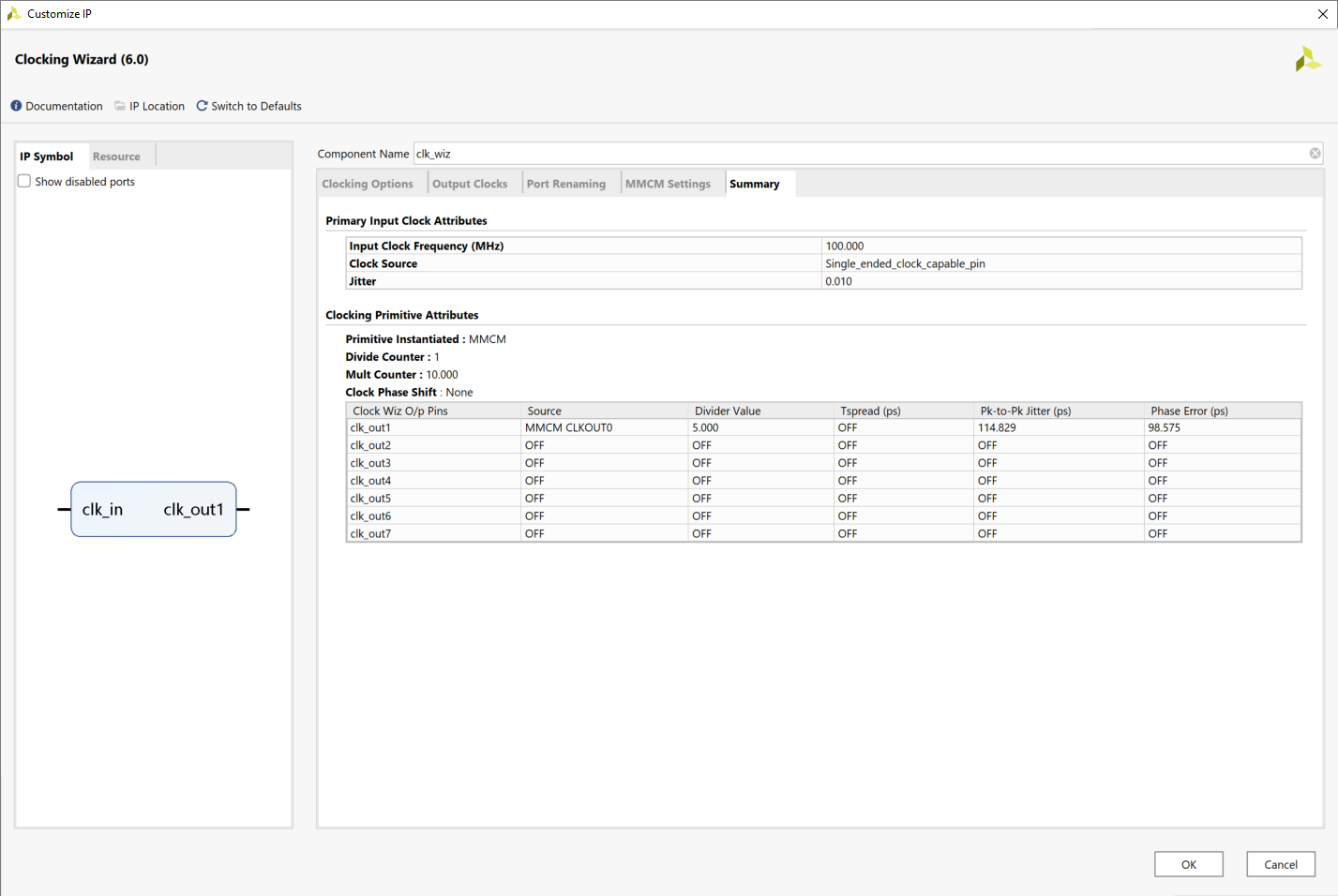

Finally, the Summary Tab will show the final results of our configuration.
- Based on the options chosen, the Clocking Wizard automatically chooses the correct clocking primitive for a selected device and configures it based on user-selected clocking features.

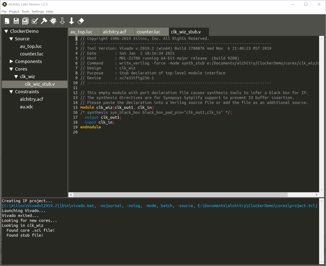

Hit OK , then Generate in the pop-up to build the files for our shiny new clock module. I will take a little while, so wait for the process to finish - then just close Vivado.

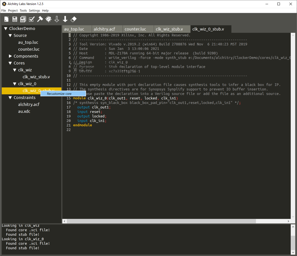

After returning to AL, you'll see that a new core has been generated that defines our new module "clk_wiz".

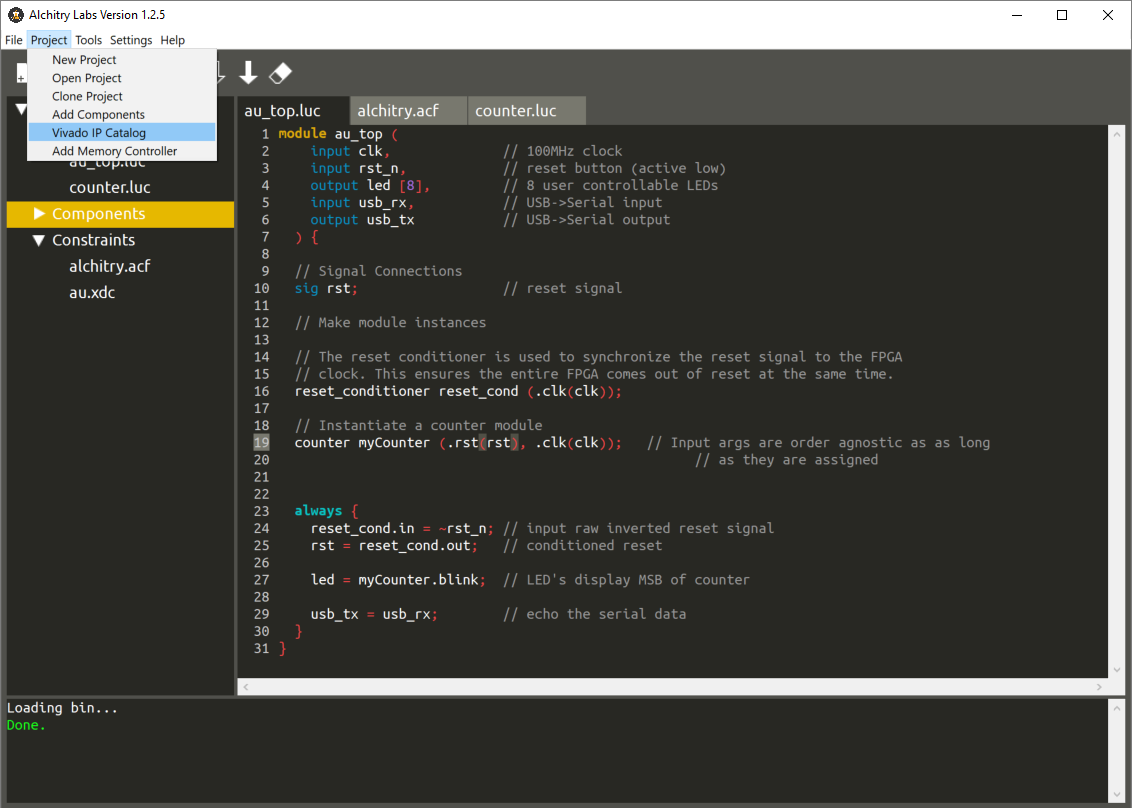

Now - lets connect that new clock module into our project.
Since the new clock module's input is driven by "clk", which is the primary clock input connected to N14 of clocking region 14, it can be presumed that the MMCM00 module of CMT0 will be chosen by the synthesis tools to drive the module.
Build and upload these design revisions and you'll see that our counter is going at twice the rate it was.
You can right-click on the clk_wis_stub.v file in the cores list to re-launch Vivado and edit the clock configuration in case you need to make changes. Just be sure to re-generate the clock module IP in Vivado and rebuild the design in Alchitry Labs.
