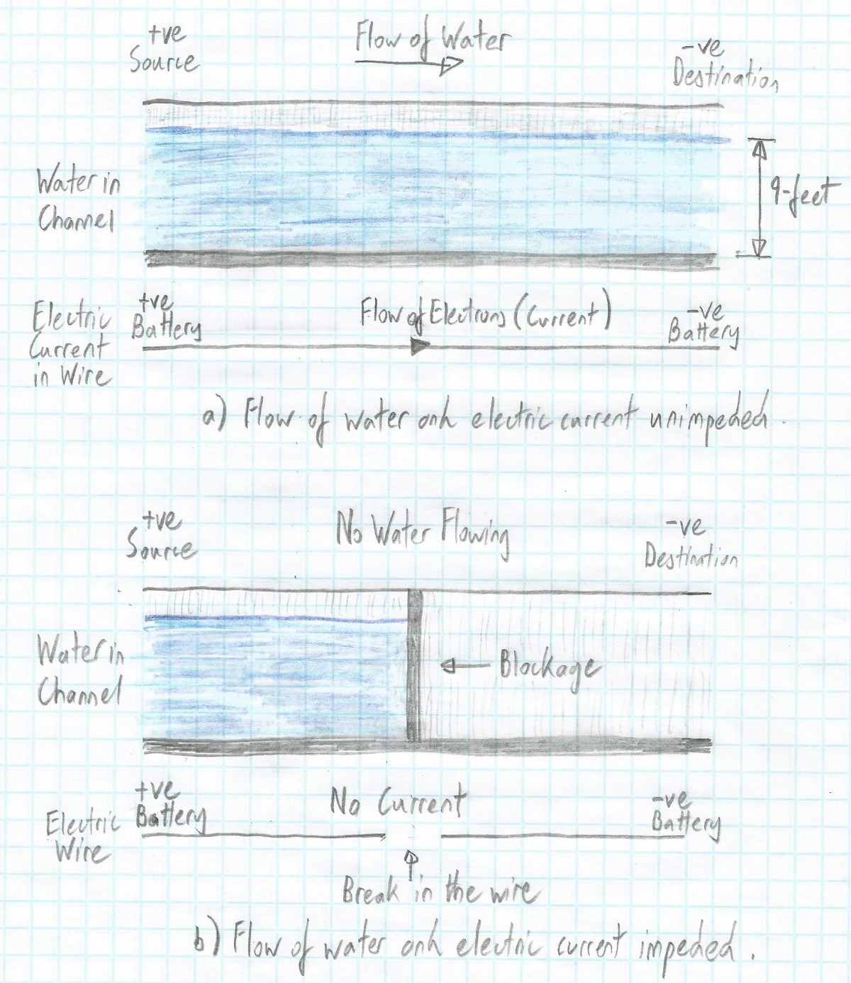

Let’s assume we have a channel conveying water. Let’s also assume that the water in the channel is 9-feet deep (thereby cunningly corresponding to our 9 V battery). Let’s say that the source of the water is positive (+ve) and the destination of the water is negative (-ve), so the water is flowing from positive to negative.
Obviously, we are using the water flowing through the channel to represent electricity flowing through a wire. Generally speaking, we represent electricity as flowing from +ve to -ve, and that’s certainly the way we are going to think about it in these columns. Having said this, it’s good to remember that -- as we discussed in Part 4 -- electrons in the real-world flow from -ve to +ve, but we don’t need to concern ourselves with that here.
Consider the diagram below. In (a) the water is unimpeded, which is like having electricity flowing through a low-resistance copper wire. By comparison, in (b) the channel is completely blocked, thereby preventing the flow of water, which is like having a break (open circuit) in our wire.
Water analogy of electric current in a wire (Image source: Max Maxfield)

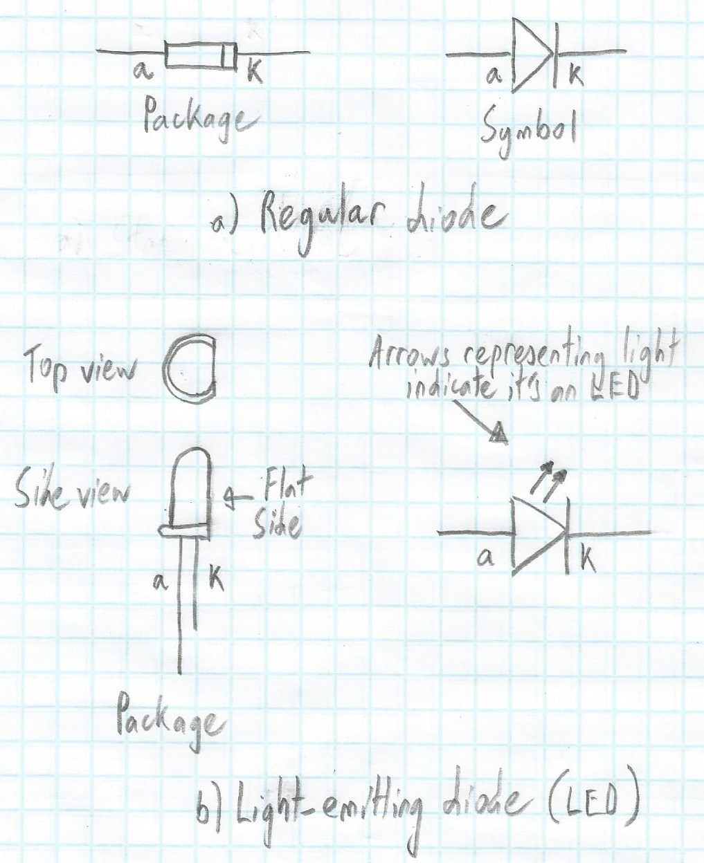

Regular diodes come in a wide variety of shapes and sizes. A very common component is the 1N4001 general-purpose diode, which -- as shown in its lead through-hole (LTH) axial package in (a) below -- is cylindrical in shape, approximately 0.2 inches (5 mm) long and about 0.1 inches (2.5 mm) in diameter.
The end of the diode that’s connected to the positive (+ve) supply is called the anode (symbol ‘a’), while the end that is connected to the negative (-ve) supply is called the cathode (symbol ‘k’). As an aside, we use ‘k’ instead of ‘c’ because the latter is reserved for the “collector” terminal on a bipolar junction transistor (BJT). Beginners sometimes become confused by the white band on the regular diode indicating the cathode because they assume this band should reflect the positive (+ve) connection. A better way to think about this is that the band indicates the “pointy” end of the symbol, which -- in turn -- indicates which way the diode has to be oriented (pointing) for current to flow.
Regular and light-emitting diode symbols and packages (Image source: Max Maxfield)
As an aside, since the term “current” refers to the “flow of electrons,” it’s technically incorrect to say things like “flow of current” (which would be equivalent to “flow of flow of electrons”) or “current flow” (which would be equivalent to “flow of electrons flow”). In the real world, however, even professional engineers may say things like “current flow” and the world continues to turn, so this isn’t something we need to lose any sleep over.
Like regular diodes, LEDs also come in a tremendous variety of shapes and sizes, but the traditional type, which has been around since the early 1960s with billions upon billions produced, is illustrated in (b) above. In this case, the transparent plastic has a flat side, and this is the side associated with the cathode terminal. Also, when the device is new (before you’ve done anything to it), you’ll see that the two leads are of different lengths, with the anode being longer than the cathode.
