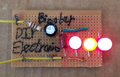

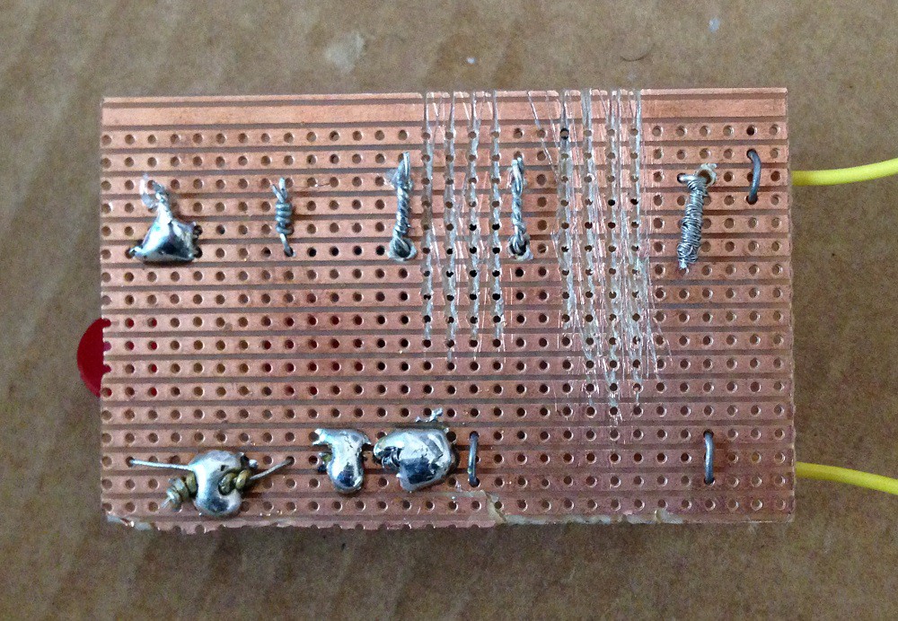

Step 3: Make the Circuit
I used a soldering iron because I modified the circuit a few times, replacing the 10 uF bipolar capacitor with 470 nF pillow capacitor:
I used the following Veroboard.
However, you should try using a matrix board instead where each hole is separate.
