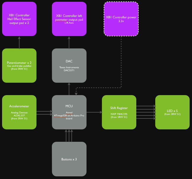

The project relies on a few basic hacks; feeding the controller the right voltage levels at the right points. Ill get into the details of steering and gas/brake later, but in general I knew the hack needed a micro controller. I opted for an Arduino - this is my go to platform for rapid prototypes in many cases; development is fairly straightforward, the platform is pretty forgiving if you mess something up, but most importantly; there is a huge open community.
Because this project is powered off the XB1 controllers battery, it was important that the micro controller worked on 3.3 V. This is an easily sourced voltage on the controller. I had an Arduino Pro (basically a Duemilanove with ATmega328, but rigged to run on 3.3V instead of 5V) around, that i thought would be great for reading the accelerometer and controlling the outputs.In order for everything to be connected nicely, i did a little pegboard with pin headers to act as a connection hub for almost everything. I like doing it this way, instead of connecting things directly to the Arduino board.
Block diagram
Power
I wanted to make the steering wheel wireless. This is something that i have wanted since i first tried the SRW-S1. The design of the wheel (no base, no pedals) basically screams out COUCH CONTROLLER. This meant that i had to drive everything, off the XB1 controller’s battery. As most digital electronics start acting wonky when the power gets too low, i searched the controller PCBA for a regulated 3.3 V source. I found one, but actually ended up using another, due to power constraints on the first one. The batteries got put in a battery case, and connected to the battery terminals on the XB1 controller. I did a simple perfboard that served as power terminals, as well as basic connections and some resistor wiring. During firmware development/uploads i turned the controller, and thereby the Arduino off, and powered it thru the Sparkfun AVR programmer. The Arduino Pro has a switch that switch between “batt” and “ext” but i found that having it in “batt” position worked for both battery and AVR programmer operation.
Steering
On the XB1 controller, steering is normally handled by a single potentiometer built into the left joystick. I figured that I just had to disconnect the original potentiometer and then feed the right voltage level to the to the output pad of the original potentiometer. Instead of removing the original potentiometer, I decided to just cut the power trace, so it was no longer connected. Before cutting, I measured the output voltages of the potentiometer - left was 0 V, center was 0.9 V and right was 1.7 V.
The plan was to have the steering controls handled by the original accelerometer from the SRW-S1. The accelerometer is the Analog Devices ADXL337. A simple device with three axis analog outputs. I only needed X and Y so I connected those to a pair of analog ports on the Arduino.
Reading the values using the build in ADC on the Arduino is very straightforward. I apply a bit of algorithms to handle the main calculation of the rotation angle, and also in order to calibrate sensitivity as well as overall sensor mounting angle.
I had a DAC lying around, and decided that this would fit the purpose just fine. It has an I2C interface, and basically I just map the rotation angle to a voltage level on the DAC - between 0 V and 1.7 V. The DAC I had, is an SMD type component, so I used a little SMD adapter/mounting board in order to wire it. The DAC was then connected to the output of the original turn (left) potentiometer of the XB1 controller,, and basically the XB1 controller has no idea that its a DAC feeding it instead of the original potentiometer.The green board on top of the Arduino Pro is the accelerometer.
Gas & Brakes
Gas and brakes is controlled by the right and left trigger respectively. on the XB1 controller. These are build using Hall Effect sensors and a pair of magnets which are mounted on the triggers. This gives for a very simple mechanical design, and a very high degree of durability. Hall effect sensors basically just measure the magnetic flux level and outputs a voltage level based on that. I measured the sensors to have an output voltage of 0.4 V to 0.8 V. depending on the trigger position; from fully pressed, to fully released. The hall effect sensors were removed, and it was time to start looking at the paddles on the SRW-S1.
The gas and brake paddles on the SRW-S1 are based on two simple potentiometers, and a couple of springs. The potentiometers are 10K Ohm, so for me to end up with 0.4 V to 0.8 V from a 3.3 V supply, there was a bit of resistor calculation to get done. Basically I built a two step voltage divider where the first divider gives me 1.8V, and the the next step that includes the potentiometer outputs 0,4 - 0.8 V depending on the position of the paddle.
The output of the left and right paddle then got wired to the original output pads of the (now removed) hall effect sensor. Again, the XB1 controller does not know that it is being fed through a plain resistor network instead of the original hall effect sensor.
