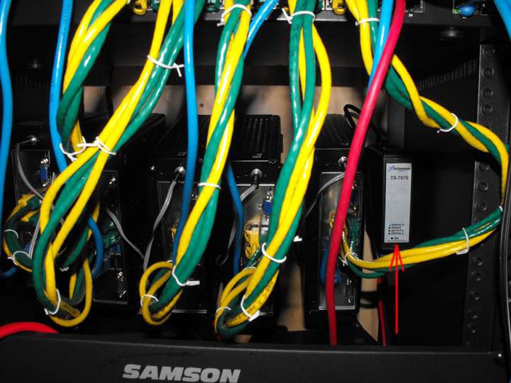

I could have rigged up a UPS to the TS-7670, but I already have one, and it's in the very rack where it'll get installed anyway.  Thus, no time like the present to install it.
I'll have to configure the switch to present the right VLANs to the TS-7670, but once I do that, it'll be able to take over the role of routing between the management VLAN and the main network.
I didn't want to do this in a VM because that means exposing the hosts and the VMs to the management VLAN, meaning anyone who managed to compromise a host would have direct access to the BMCs on the other nodes.
This is not a network with high bandwidth demands, and so the TS-7670 with its 100Mbps Ethernet (built into the SoC; not via USB) is an ideal machine for this task.
Having done this, all that's left to do is to create a 2GB dual-core VM which will receive the contents of the old server, then that server can be shut down, after 8 years of good service.  I'll keep it around for storing the on-site backups, but now I can keep it asleep and just wake it up with Wake-on-LAN when I want to make a back-up.
