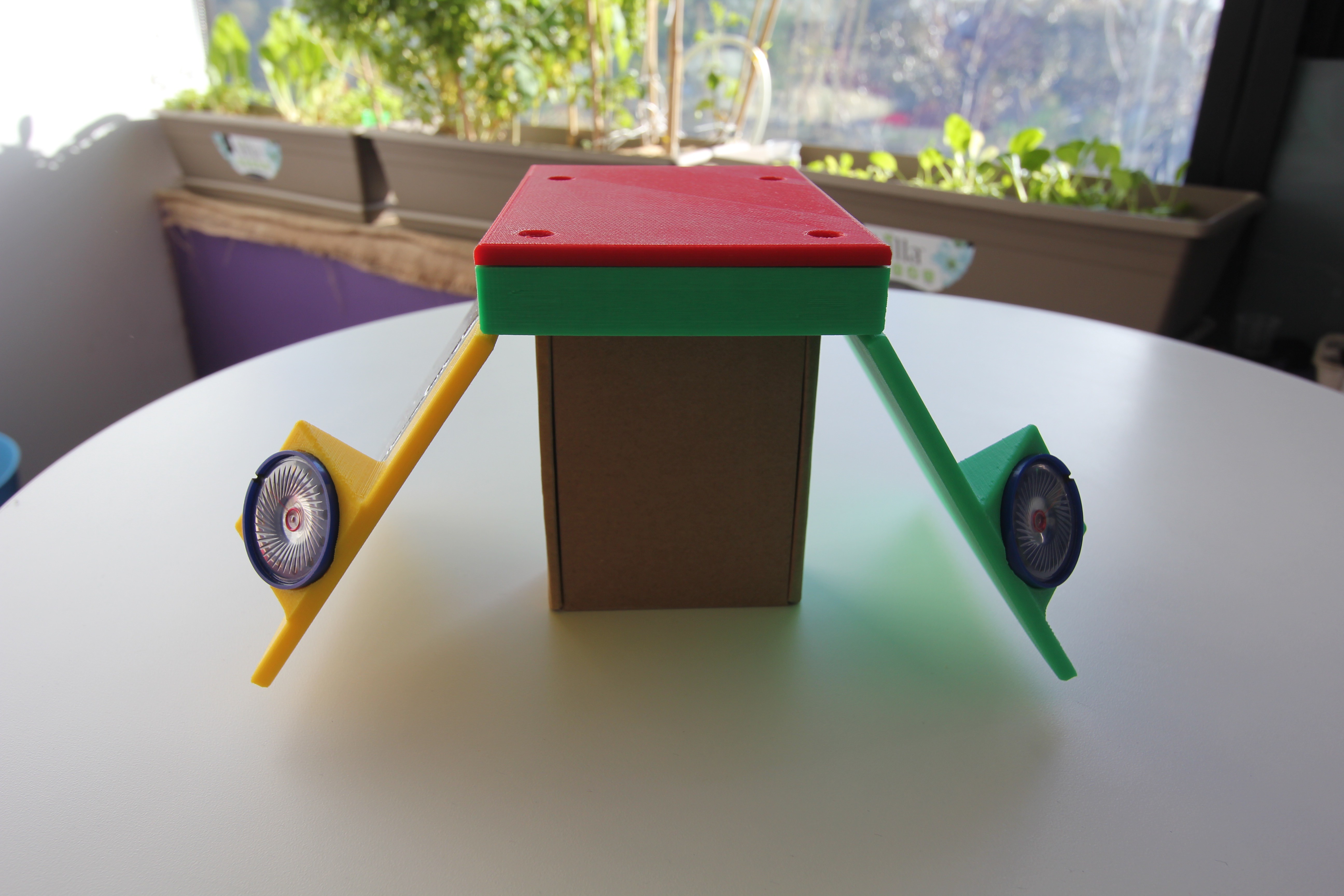

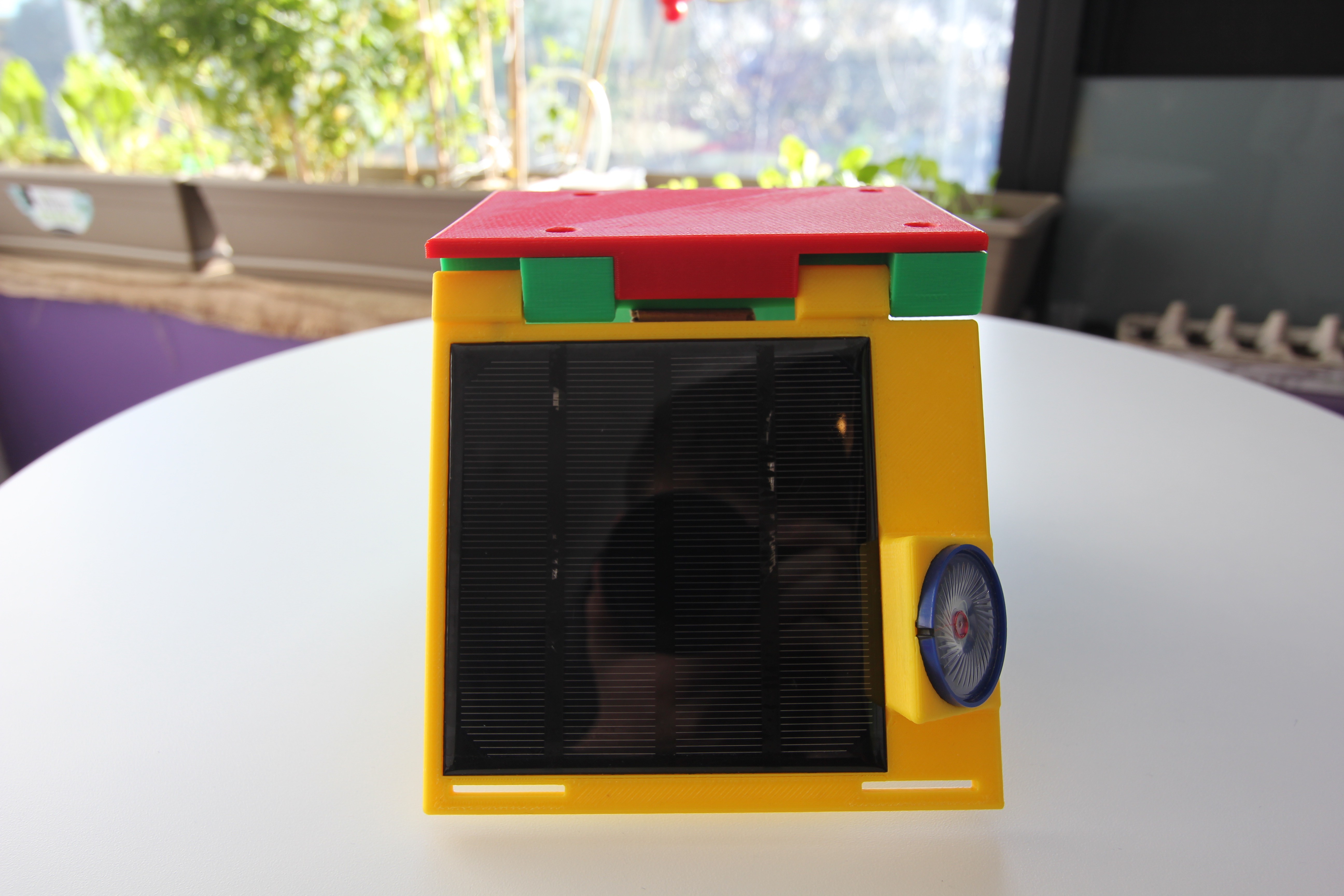

  • 3D Printed Enclosure
    Alex Muir08/13/2016 at 23:40 0 comments
    Haven't updated this for a while so here comes a whole bunch of posts in a row!
    An initial prototype of the enclosure has been printed. Whilst everything works fine with the enclosure, I'm not sure that it is ideal for actual use, it seems quite bulky, and the hinge would likely not be strong enough for actual use. Possible changes to the design would be to remove the centre section, and have one side contain the PCB and the other side the battery. Will look into this over the next few weeks, however I have limited time before the project is due to be completed and since most of my marks will be for the electrical and software design it will be a lower priority.

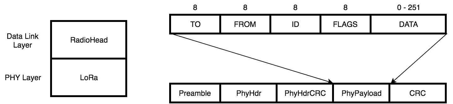

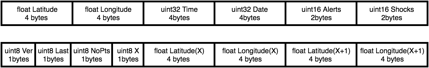

    1. Wireless Communications
      Alex Muir06/27/2016 at 07:33 0 comments
      An important feature of the OpenFence system is the ability to update the fence position remotely and to be able to track the animals’ movements over the day. This requires some sort of wireless communication. As was mentioned in the component selection above, LoRa has been chosen for the physical layer of the system. The HopeRF RFM95W is a 915MHz module, which has the ability to transmit over long distances with low power consumption, and is available in relatively cheap modules.
      The network will use a star topology with the collar nodes only looking to receive packets after they complete a transmission. This will reduce the power consumption significantly by not having the module always looking to receive data. The star topology was chosen over the option of a mesh network, as it would require the collar nodes to be always receiving and then sometimes retransmitting messages, consuming much more energy. Another flaw with using a mesh network for this application is that the position of the animals will be constantly changing, making it difficult for the network to find the most efficient path to a particular end node.
      The “RadioHead” library (GNU GPLv2) is available for the RFM95W that is being used for this project. This library provides the ability to transmit and receive reliable (acknowledged) packets to up to 255 nodes as standard, with the possibility of altering this to allow more node IDs. It supports broadcasting to all nodes, and has the ability to classify messages into 16 different categories using 4 bits of flags in the header. The complete message format is shown below.
      Currently there are two types of messages that are being sent between the base station and collar. The first is a position update from the collar to the base station and contains the location, time, date and number of alerts and shocks so far today. The second is a fence update from the base station to the collar and contains the fence version, number of corners, and the positions of these corners. Both of these two packets are 20bytes as can be seen in below.

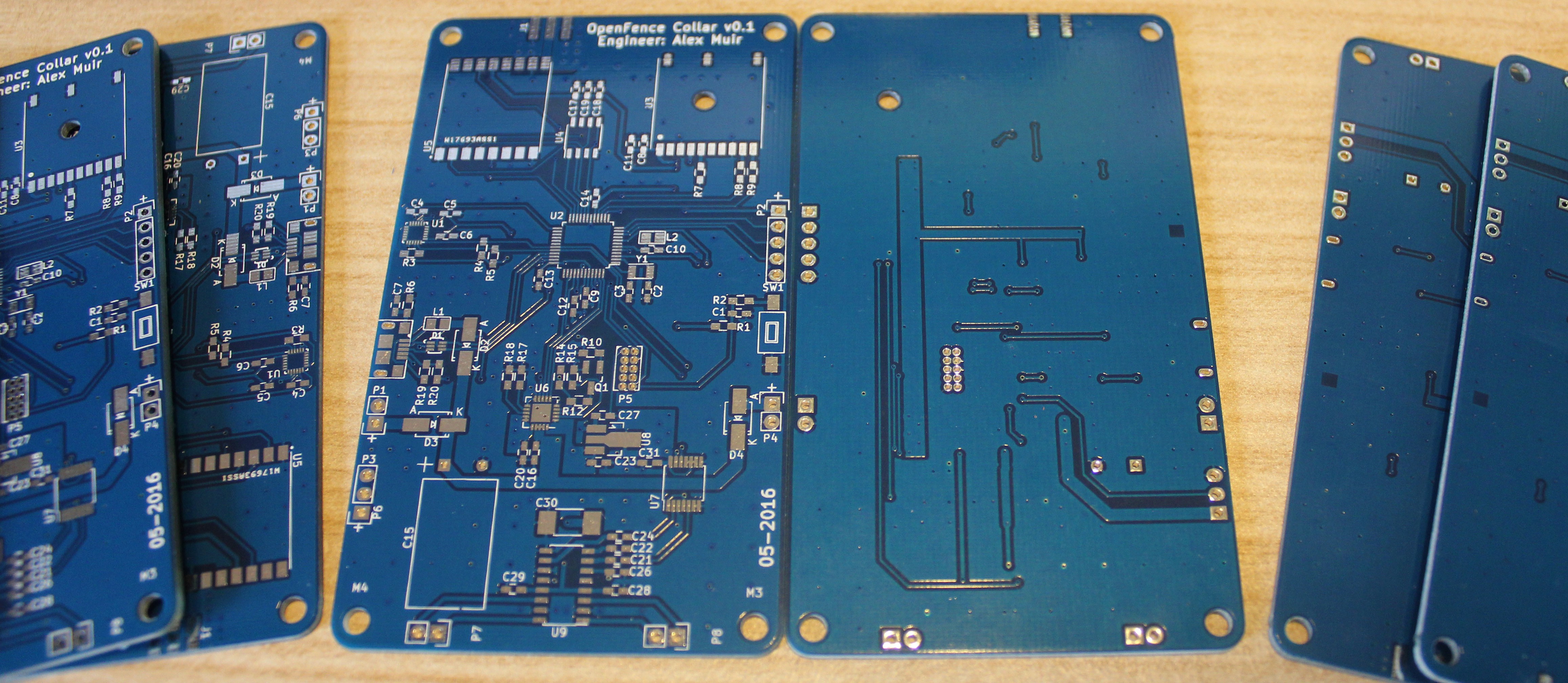

    2. PCB Manufacture!
      Alex Muir05/26/2016 at 06:21 0 comments
      After completing the PCB design I sent off the Gerbers to PCBWay for manufacturing, a week later they are here! The quality is excellent for the price and the service was really easy to use.
      Components are starting to arrive. Soldering the components will be started once I have them all.
      Software has been progressing with LoRa communications working well (next post will be on that).
    3. PCB Design
      Alex Muir05/19/2016 at 05:59 0 comments
      PCB has been laid out in KiCAD, Gerbers generated and sent for manufacturing. The following are renders of the front and back from GerbLook. It is a two layer design, with a board size of 97mm x 57mm.
      The design has tried to minimise opportunities for noise and interference. The high frequency components are towards the top, digital and power circuitry in the middle, and audio at the bottom.
      To ensure the antenna output was matched to 50 Ohms, Saturn PCB Toolkit was used to design the coplanar waveguide. 50 mil with an 8 mil gap to the surrounding ground plane on 1 ounce copper was determined to provide 50 Ohm impedance.
      Wasn't quite as impressed with KiCAD's PCB design tool, not being able to easily stitch the ground planes together and not being able to drag tracks were the biggest peeves. Still for a completely free program it does a good job!
      As always if you want to look at the original Gerbers or KiCAD files they are available on GitHub.

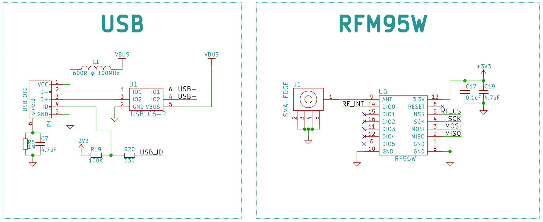

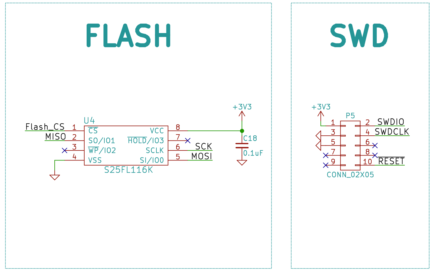

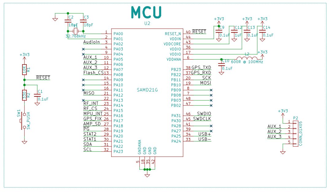

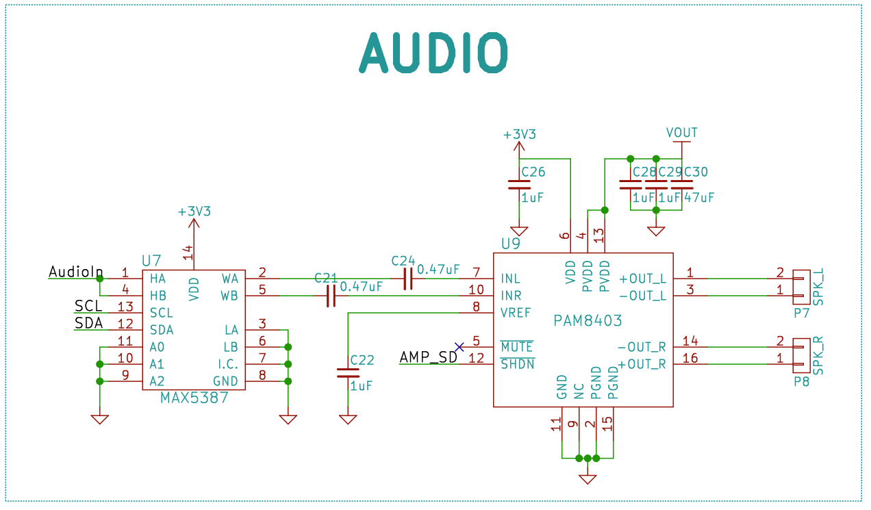

    4. Schematics
      Alex Muir05/10/2016 at 11:34 0 comments
      Schematics have been basically finalised, although check the GitHub one for the most up to date version. I have been using KiCAD for this project, having moved from designing in Altium for another project over the summer. Really impressed with the functionality and keyboard shortcuts of KiCAD, everything is just what you expect it to be.
      Most of the circuits are based off each devices application circuit, along with comparisons to the breakout boards I have for many of them. If you have any feedback or questions, pleasedon't hesitate to comment!
      MCU
      Power Management
      RF and USB
      Audio
      GPS and IMU
      Flash and SWD

    6. Enclosure Design
      Alex Muir04/22/2016 at 23:51 0 comments
      I have spent a bit of time improving the design of the collar enclosure in Solidworks, so I can start 3D printing some test versions once I receive and measure the last few components (speakers and solar panels) that I am waiting on.
      In order to make the collar fit many sized animals I have made the two sides such that they can rotate up and down. This adds some difficulty in getting the wires from the solar panels, speakers, etc to the main circuit board and keeping it weatherproof. I have designed the hinge such that the wires can go through them, however this will require testing as to whether it reduces the strength of the pin significantly.
      There are still a few things to add, but for now I will keep working on the electronics with final component choices being made (next log) and PCB design to begin.
