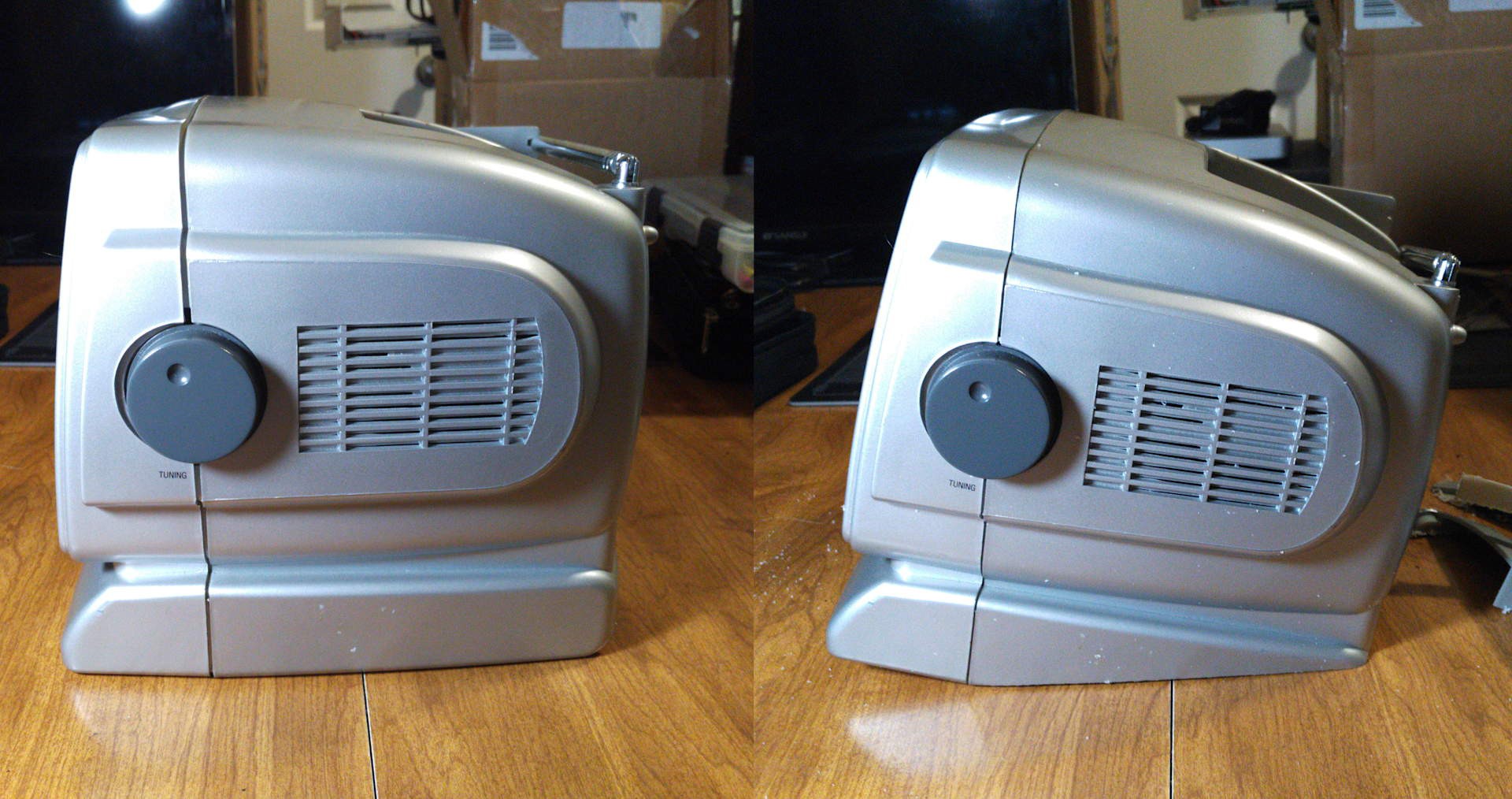

After verifying the screen was good to use I did a test fit in the cabinet. The entire TV fit without an issue, but the angle of the tube didn't match the angle of the panel removed from the cabinet.
I looked at the TV for a long bit contemplating whether I should tear it apart like I did with the RCA. I decided to keep the TV in tact so that it would be safer to work around and be more shielded to the environment. I did want to change the angle of the screen so I took a hacksaw to the battery compartment to adjust the TV's sitting angle.
The change isn't extreme, but it's enough to make the screen feel much more natural. The hacksaw cuts weren't perfectly aligned on both sides, but this was easily fixed with some 40 grit sand paper.
I also removed a small bit of wood from the bottom of the opening in the cabinet. This made it possible to push the TV against the opening in the cabinet without interference from any of the front-panel controls.
