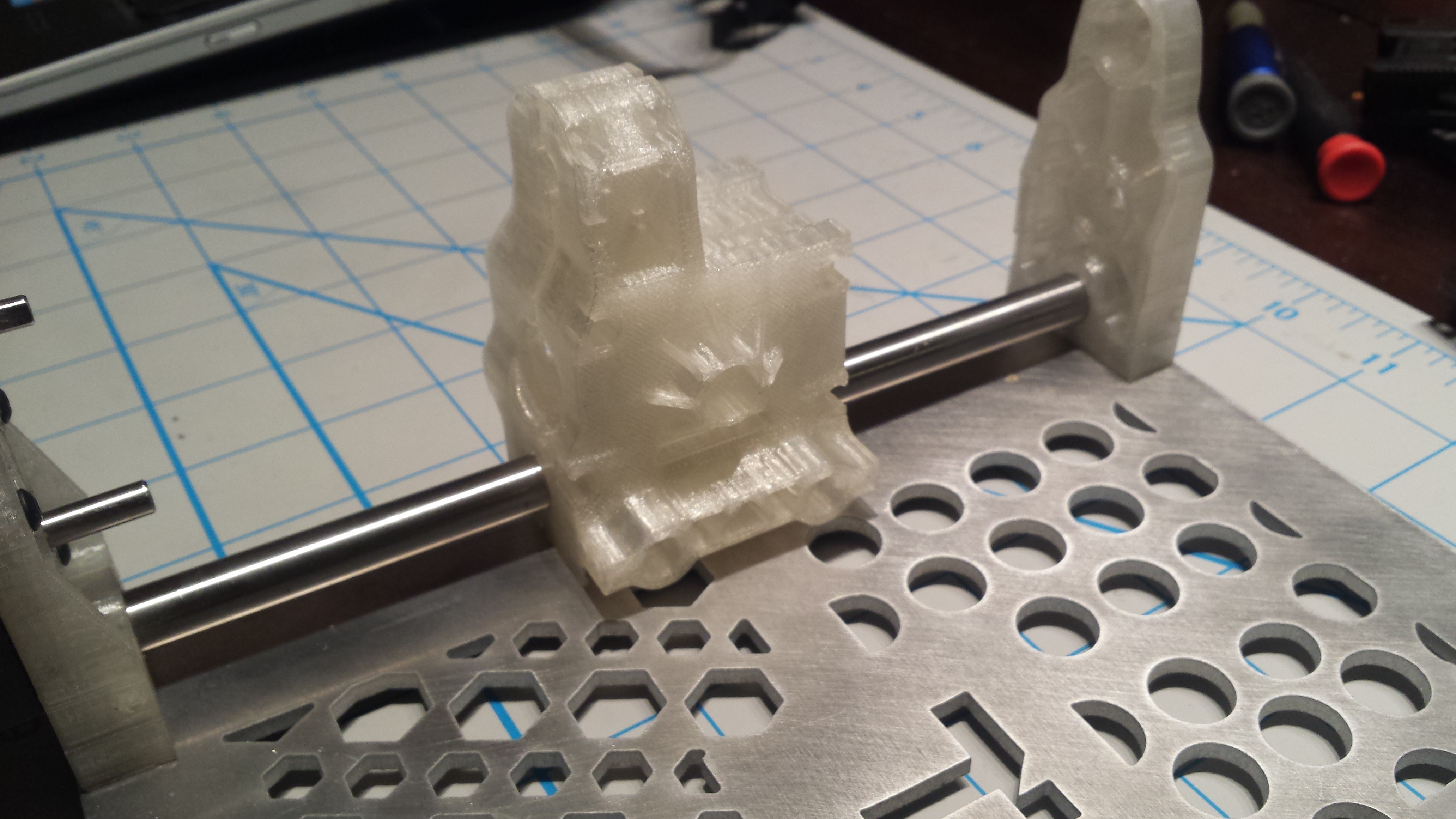

  • TOME Test Rig
    Philip Ian Haasnoot08/27/2014 at 08:31 0 comments
    I was able to pull myself away from my other projects to give the TOME some love tonight. I've had this makerbeam sitting around for quite some time, generally I use it for quick test stands or supporting rigs for projects that i'm working on. The TOME rear plate will be re-cut in order to attach to the frame properly (Zip ties are temporary). I feel that attaching the backpane assembly to a rigid test fixture will enable us to perfect the mechanism and get great prints. Once we fine tune the motion mechanism we will make the TOME fold, this will help narrow down causality if our print quality degrades once the folding mechanism is instituted.
    The StepperStack 2's arrived today and are currently wired up on the test board below. We are using an Arduino Uno, with a spare Joystick breakout from Sparkfun to drive the StepperStack 2's. The goal is to have a very rudimentary drive setup just to test the mechanism, the first prototype will then transition over to the Sanguinololu once we are ready to start printing. The goal is to spin our own board for the first portable prototype, for now our effort needs to be focused on finishing the XYZ Drive mechanisms.
    The FDM 3D printer we are using to prototype parts is printing everything undersize, and any hole is oblong making it tricky to get our parts to fit properly. We are discussing SLS printing with a local company here in AZ, if all goes well we will have more accurate parts to work with. Currently you can actuate the Z-axis carriage (with spindle installed) by turning the Z-axis lead screw, however due to tolerance issues caused by the 3D printer we are using we cannot spin the X-axis spindle just yet. I'm going to adjust the spindle model to give us some clearance just for this test print so we can get one half of the drive mechanism moving under power. Stay tuned!

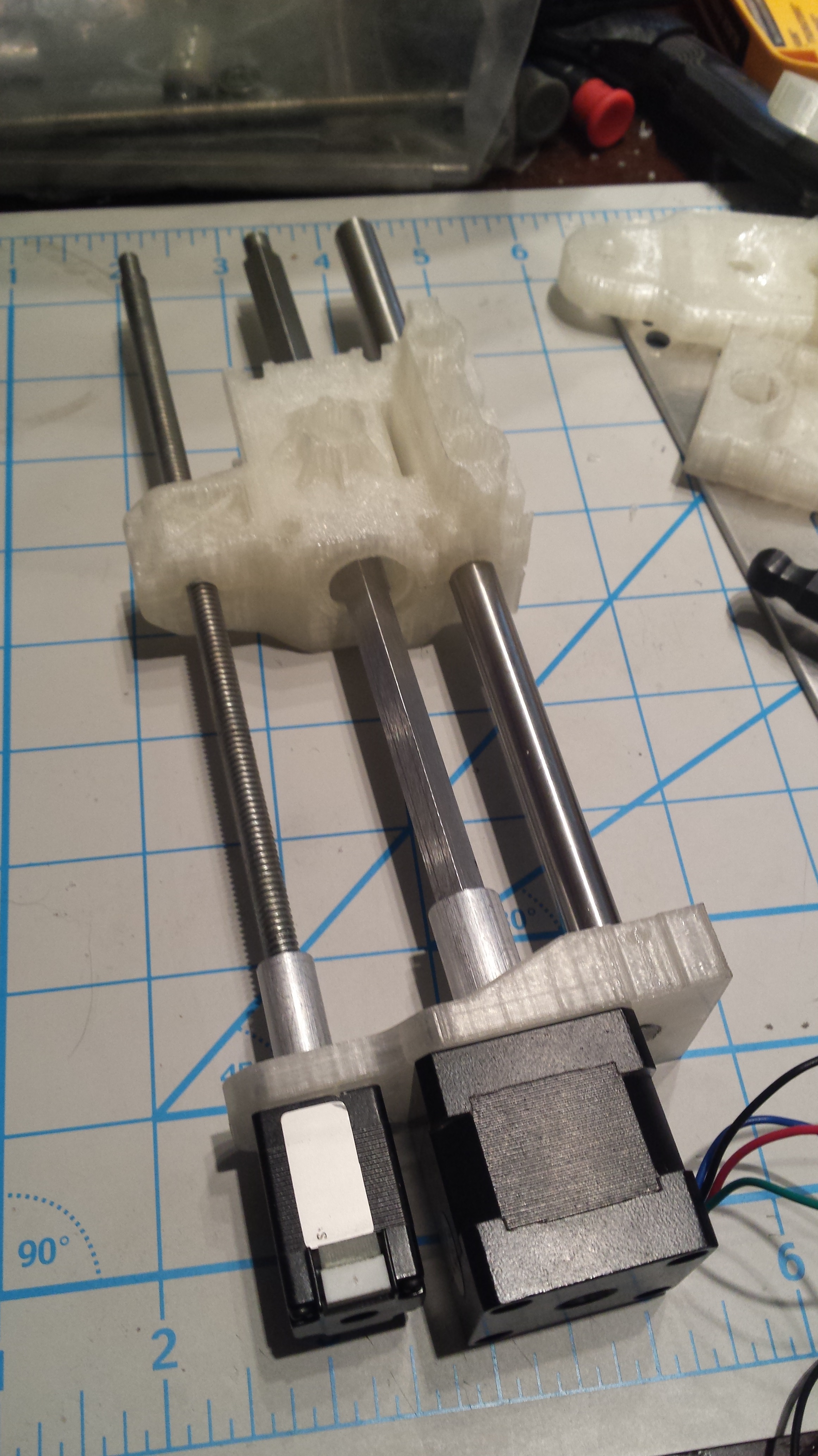

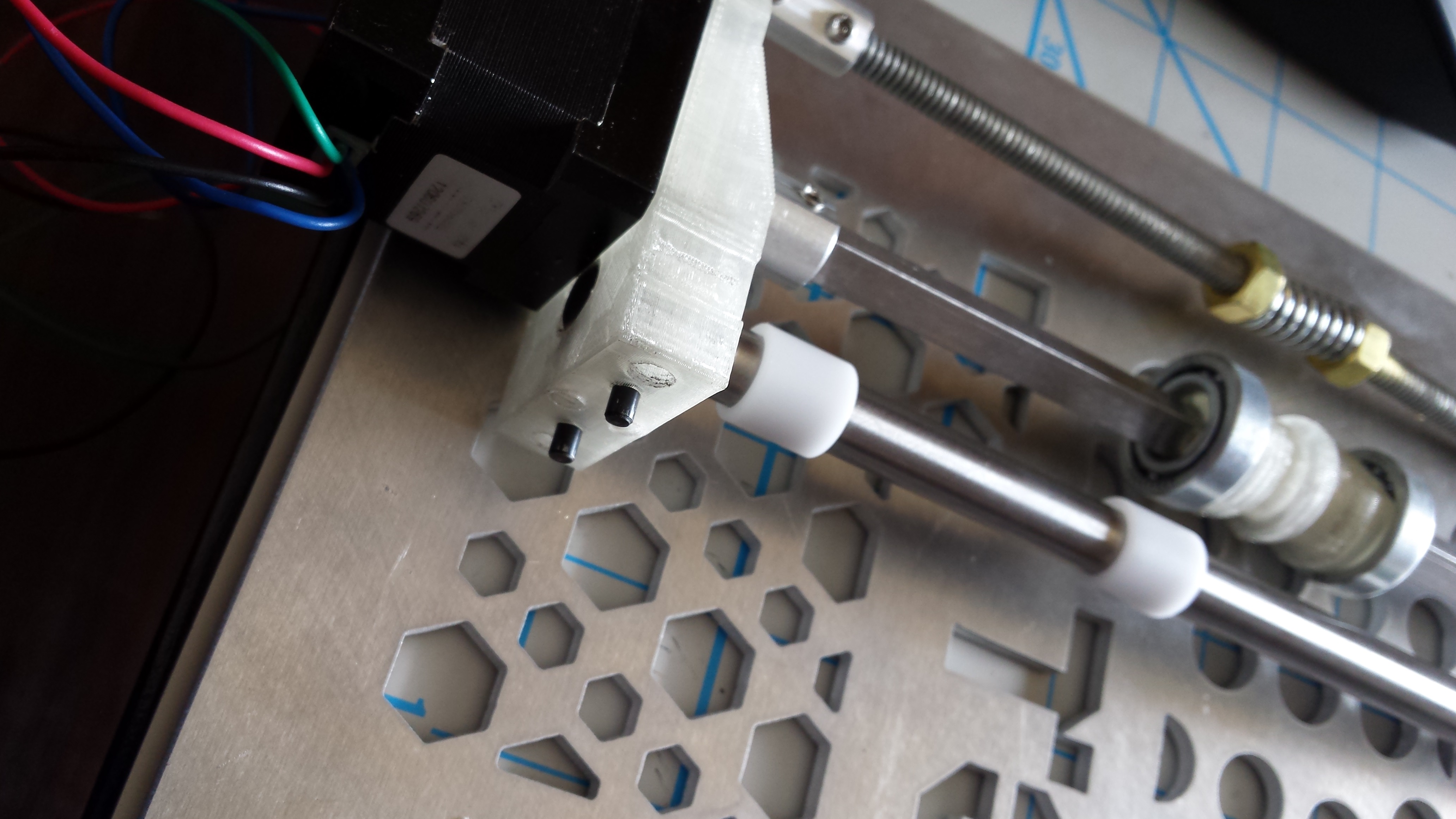

  • NEMA 14 issues
    Philip Ian Haasnoot07/14/2014 at 05:22 0 comments
    So I worked on assembling one full side of the Z-axis today and ran into a few issues. The first is that our NEMA 14 steppers that were purchased from Pololu have a slightly longer shaft than the original batch from an alternative supplier. I should have measured them prior to any machining but didn't think to do so. The model has been updated to reflect the new shaft length, the only major change is that the X-axis square drive has a slightly shorter engagement with the coupler. Once the parts are modified I can install the last bearing and begin assembling the clamshell prototype.
    Here is the full assembly with the backpane, the top bearing mount appears to be floating in this image because I had not yet opened up the dowel pin locating holes to the right dimension.
    And here you can see the dowel pins inserted. This backplate is the original one I cut which is why it does not have holes to provide access to the guide rod clamping set screws from the back. I hate wasting material so I'll be adding these tomorrow on the drill press, the model has already been adjusted.

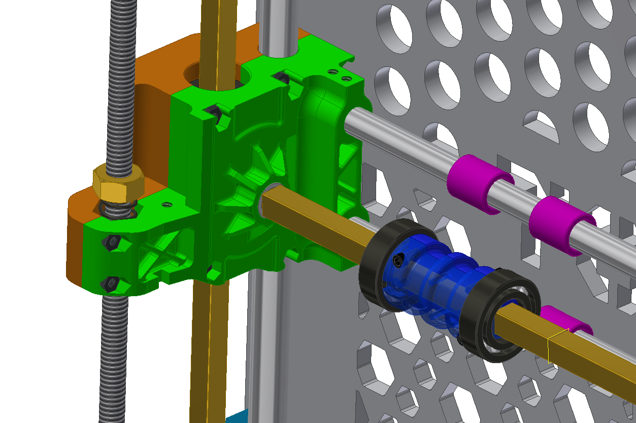

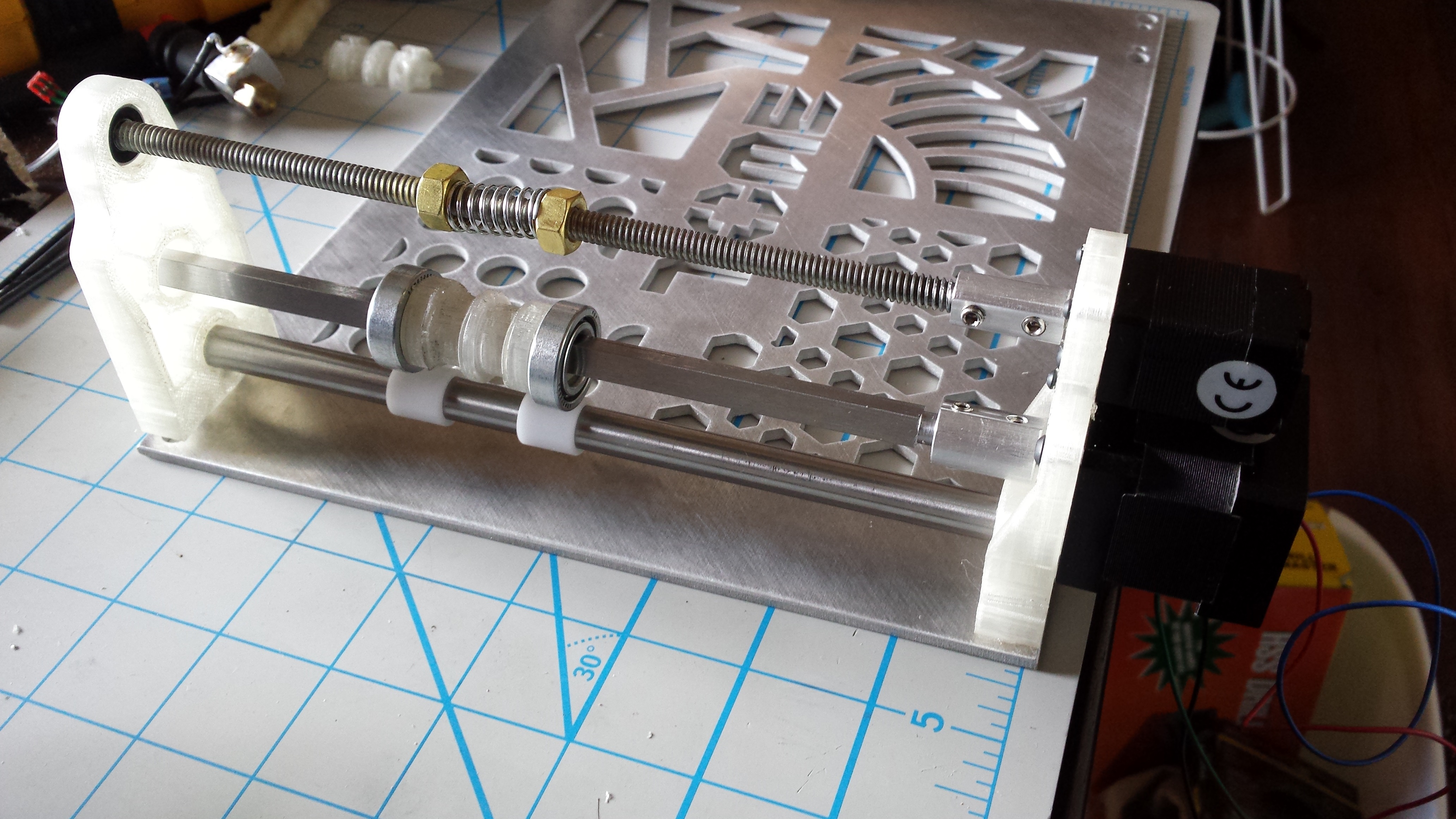

  • Z-axis Parts Finished
    Philip Ian Haasnoot07/12/2014 at 06:09 0 comments
    Preliminary prototype parts for the Z-axis (X-axis drive side) were completed today. I need to swap out the upper bearing mount and lower motor mounts as they were modified since the initial print. The goal for tomorrow is to have this side of the Z-axis running back and forth, with the ability to also run the X-axis spectra line pulley.
    Progress has been slower the past few days than I was hoping, family and work tends to get in the way of projects. I'm hoping to have the opposing side of the Z-axis finished this weekend so that I can focus on the Y-axis truss that is causing so much controversy.
