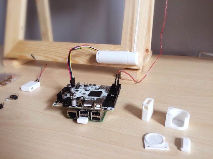

Assembly
The elements of the enclosures are 3D printable and available on github here. The other components are listed above. When assembling mechanism to your roller blind window, follow this instructions:
1. Put DC motor in the "Roller_Motor_Enclosure" part and tighten it with two M3x6 screws.
2. Close the motor with "Roller_Motor_Enclosure_Bottom", make sure that the wires are outside the box and tighten it with two M3x10 screws
3. Attach "Roller_Shaft" on the motor's shaft and tighten it with M3x6 screw.
4. Wrap a string of a roller blind on the shaft and cover it with "Roller_Shaft_Enclosure", then tighten it with two M3x30 screws.
5. Put microswitch in the "Roller_Endstop_Enclosure" and cover it with "Roller_Endstop_Enclosure_Top".
6. Solder some wires to the "C" and "NC" connectors of the microswitch, make sure you can plug it to the CORE2 hSens1.
7. Close the loop of the string and attach motor mechanism, so the string is tight. Then attach the endstop mechanism on the top of the frame of the window. The glue or the tape is the best option.
Optionally you can cover screws with "Roller_Hiding_Screw" elements.
