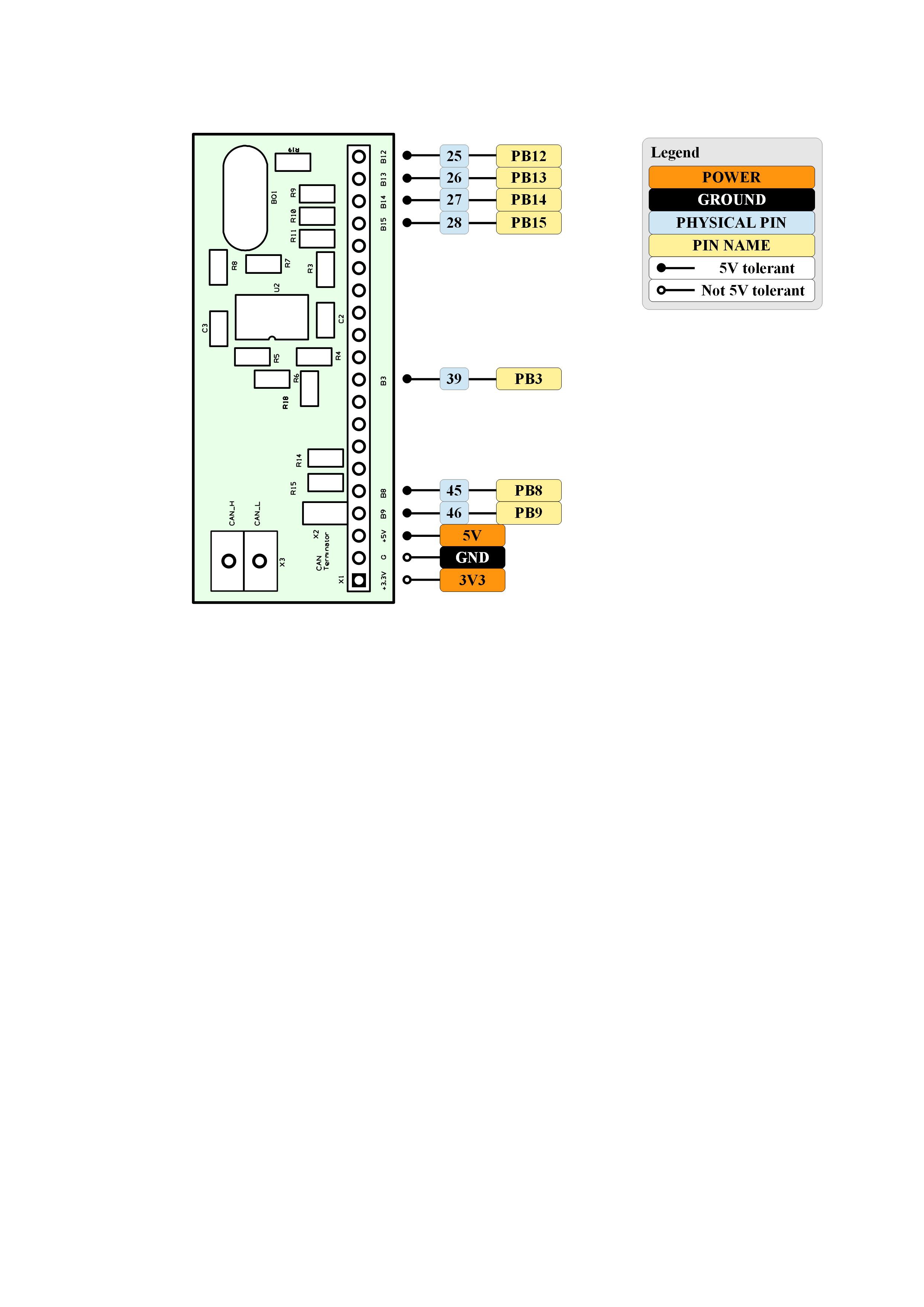

Therefore, this board was designed. The board can be used in various configurations for slave modules.

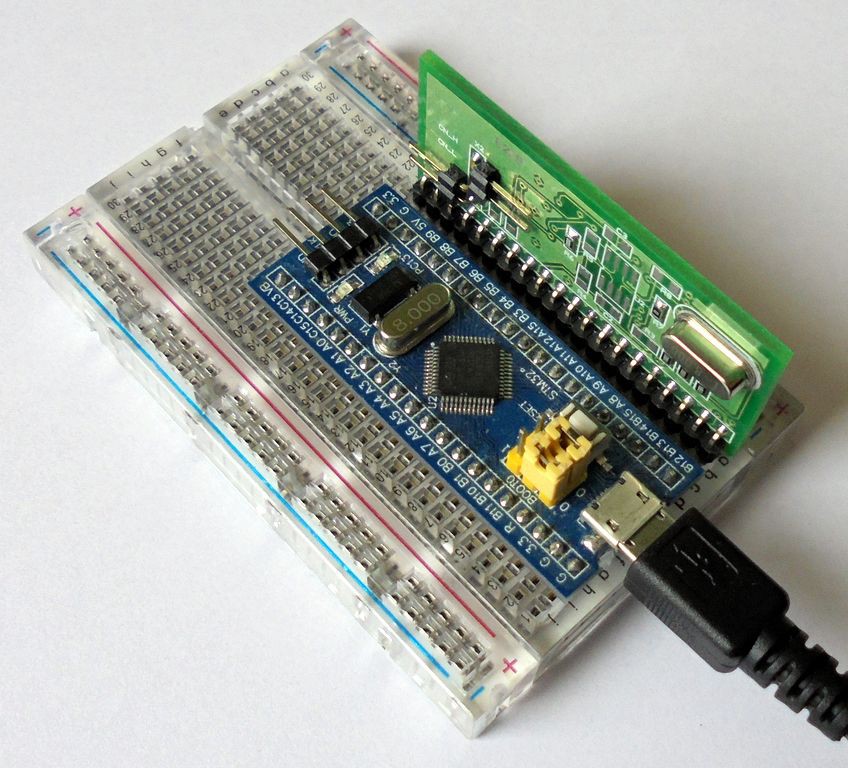

The board can be used in conjunction with a classic breadboard:
