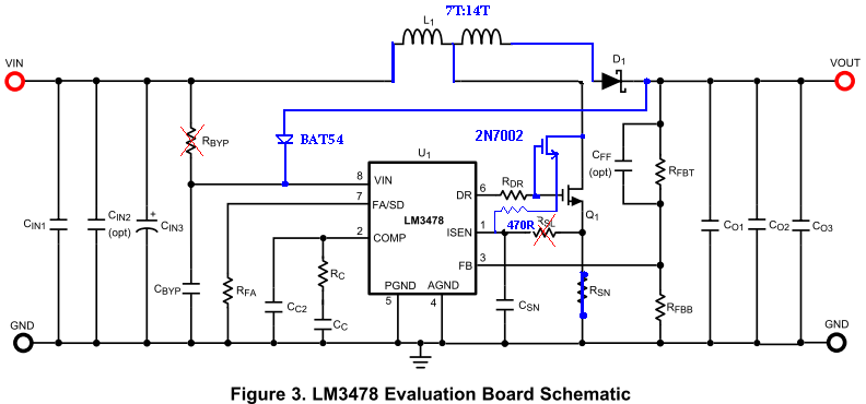

I modded a LM3478 (3V to 40) eval board for low voltage boost.  With the modifications, I am hoping it would work for lower voltages once the output is running at 5V.
There are a few changes:
Part list
Q1: I am using Si7806ADN (30V, 12A, 0.013R).  It is just a small N-MOSFET that I have - nothing spectacular.

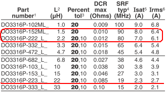

L1: Coilcraft DO3316T-223.  There are 22 turns on the core.  I made a tab at the 7th turn.  7T:14T

To create small island of copper fill on the PCB for the mods, I use Polyimide tape (aka Kapton tape) for insulation and overlay small piece of copper tape.

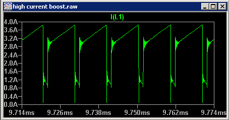

 I did a LTSpice simulation with a slightly different part: LT3758, but with same power components.  The simulation thinks it can supply 250mA, but that doesn't happen here.

The "0R" resistor increased the voltage drop across Q1 fooling the PWM circuit to limit the duty cycle which limits the power.  As the resistor is remove, there is an issue going below 0.42V with this load as the PWM duty cycle increases and current drawn beyond my 5A bench supply.
I'll need to adjust the 470R series resistor into Isense pin as that can be used to inject a DC offset to limit inductor current.
Inductor current peaks around 4A for the 150mA load at 0.4V in LTSpice simulation (file here) .  I pick 5A as a limit. The duty cycle starts to drop below 100% when Current sense >75mV.
Q1 RDS(on) = 0.0054R,  0.0054R * 5A = 27mV as the target.  By setting RSL = 1K, VSL adds an additional DC offset of ~50mV and that makes 75mV.   The PWM controller would start to reduce duty cycle when the inductor current starts reaching 5A.
The majority of the current flow through the 5.5 turns winding of the tabbed 22uH inductor.  The inductance value is around 1.5uH, the saturation current for the same magnetic core is good for 7-8A.
They used AWG 26 for the 22uH inductor.  I rewinded the first 5.5 turns with AWG 24 as that's where the maximum current flows when the MOSFET is on.   The remaining turns sees less than rated current.  There is a limit on the copper wire thickness as the secondary windings need to be on too., so AWG24 was a reasonable compromise.
