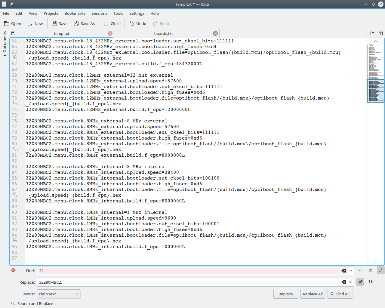

Now you have to change every occurrence of the string "32." at the beginning of the lines with the string "32Z80MBC2." (mind the dot!). Do not use a "change all" approach, but check every change carefully.
At the end the temp.txt file should be like this one:
