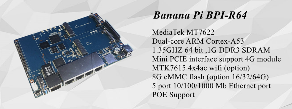

The Banana Pi R64 is a router based development board, which can run on a variety of open source operating systems including OpenWrt,Linux. It has 4 Gigabit LAN ports, 1 Gigabit WAN, and AC wifi AP function. use 64 bit chip design
==Key Features==
  • MediaTek MT7622,1.35GHZ 64 bit dual-core ARM Cortex-A53
  • 1G DDR3 SDRAM
  • Mini PCIE interface support 4G module
  • built-in 4x4n 802.11n/Bluetooth 5.0 system-on-chip
  • MTK7615 4x4ac wifi on board
  • support 1 SATA interface
  • MicroSD slot supports up to 256GB expansion
  • 8G eMMC flash (option 16/32/64G)
  • 5 port 10/100/1000 Mb Ethernet port
  • (1) USB 3.0
  • Slow I/O:ADC, Audio Amplifier, GPIO, I2C, I2S, IR, PMIC I/F, PWM, RTC, SPI, UART
  • POE function support
Hardware interface:
we design PoE function for BPI-R64 ,so easy to add PoE module to support PoE function,PoE modue can support 12V/3A to power BPI-R64
