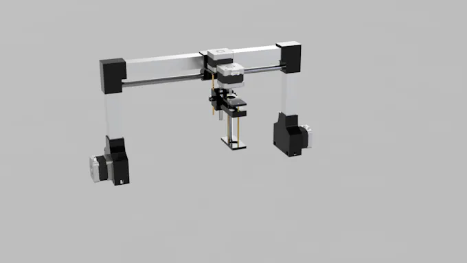

I started by thinking of a free-wheeled machine that could have an infinite Y-traverse, but it proved to be too cumbersome and inaccurate.
So I chose to use V-slotted rails with wheels instead. I then went on Fusion and designed several parts, including the entire X and Z axis parts.

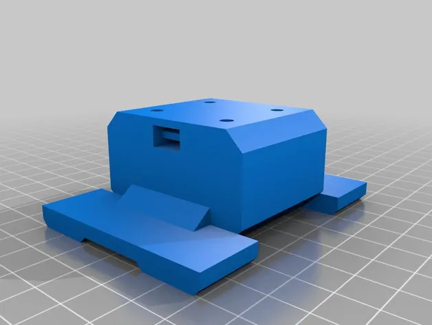

The bed (Y axis) is comprised of two 500mm or 800mm V-slot rails arranged in parallel. There are four plastic pieces that hold two wheels each, allowing for easy travel of the bed along the rails. I also ran a timing belt across the Y axis under the bed, so that when the Y axis stepper rotates the belt moves.

The X axis is comprised of a single rail that holds a 3D-printed piece with four wheels. The timing belt slots into the sides of the plastic piece that pulls it either direction.
5Making the Z Axis
The Z axis is based on a pulley system, so that when the stepper rotates the Z block can get pulled or lowered.
