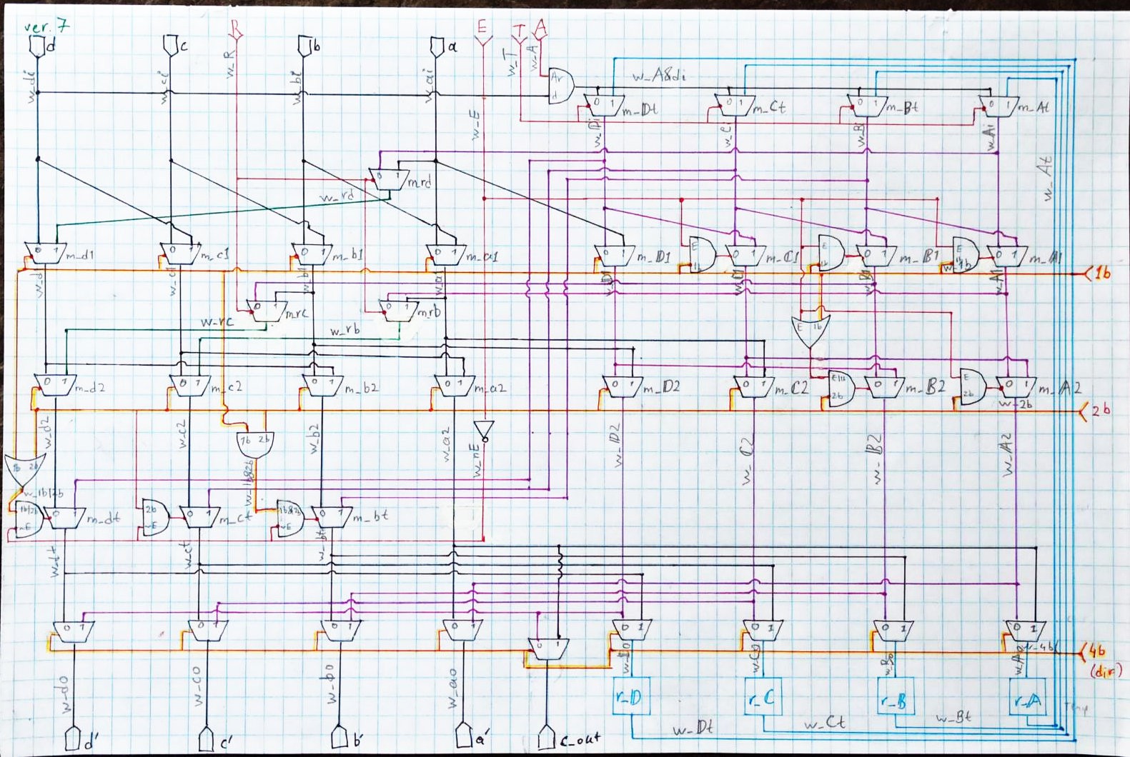

    In previous post I wrote about planning to add a funnel shifter (an extended barrel shifter) to this CPU design. Now, I have designed a 4-bit prototype, and implemented it in FPGA, it has all the needed control signals, and performs all operations I intended it to perform. The 16-bit version would have more bits controlling shift amount, but other control signals will stay the same.
    What is the Funnel Shifter?
    This is an extension of the Barrel Shifter, in a sense that it is 2 times wider than machine word (barrel shifter usually is the same width as word), and can manipulate data on 2 consecutive registers as if was one double-sized register, and extract the arbitrary word-sized bit field. Thus, it takes two words as input, and outputs a single word. In my implementation, there are some additional functions, and caveats.
    Here is the schematic I drawn (it is final, 7th version), which helped me in writing Verilog description:
    On the schematic, there is the funnel shifter itself, comprised of a bunch of 2:1 muxes with a little sprinkling of AND and OR gates,  as well as temporary register represented as 4 data flip flops r_A through r_D (blue squares). This register holds shifted-out bits that could be retrieved later, with special MOV operation, or used in consecutive operation to facilitate multi-word shifts/rotates.
    There are 5 types of shifting operations this circuit is capable of:
    1) regular shifts to the left or right;
    2) arithmetic shift right;
    3) rotate word right;
    4) rotate through N bits of temp register*;
    5) rotate double word.
    *This is expansion of Rotate Through Carry, but can use several bits from temp register.
    There are 4 control lines defining general operation (red, with inputs on top):
    A: Arithmetic shift;
    R: Rotate (for single-word rotation);
    T: Use the Temporary register;
    E: Extended rotation (rotate double-word, has effect only with T).
    There are also 3 control lines (golden-red, with inputs on the right) defining shift amount and direction (1b, 2b and 4b).
    The temporary register is supposed to be updated only for operations that have T signal high.
    As there are 4 control lines, there is 16 possible combinations, but not all of them are useful, and some of them are functionally duplicates. Out of them, 5 combinations are selected to provide 5 operations listed above. Of these, arithmetic shift and single word rotations need to be only to the right.
    Rationale for using special temporary register instead of second general purpose register:
    there is just not enough bits in instruction for encoding second source register address. I need to provide the source, the destination, and shift amount (or third register containing shift amount), and this is already 9 or 10 bits out of 16-bit instruction, 6 bits that are left are opcode. There is no way to have another 3 bits for yet another source register address.
    With global structure of this shifter proven on 4-bit model, the next now is to scale it to 16 bits.

  • Updated State Machine
    Pavel11/10/2022 at 17:07 0 comments
    As I tested the operations in simulation, I encountered the error in the design of Jump instructions, and thus the part of State Machine that is responsible for orchestrating execution of  Jump instructions was not right. Here is updated state machine diagram with corrected error:
    List of states:
    01 - F1 -- Fetch 1 state, loads 16-bit word from memory at address in PC into Instruction Register, advances PC by 2; it is a common start of any instruction execution cycle.
    02 - F2 -- Fetch 2 state, loads 16-bit word from memory at address in PC into Memory Data Buffer Register, advances PC by 2; it is used for 2-word instructions, second word containing some immediate value.
    03 - F_i -- Fetch Interrupt state, loads hardcoded JSR (SP) [r0] instruction into Instruction Register. The execution is modified so that [r0] value is ignored. This state is entered when IRQ signal is set, and current instruction is executed fully.
    04 - ALU -- ALU state, perform any of the 29 ALU operations on GPR. This state is normally staggered / concurrent with F1 state. In case there is an IRQ signal active, the next instructions Fetch state is entered only after current ALU state is executed.
    05 - MOV -- MOV state, Copy data from one register in CPU to another, can be repeated several times for multi-word transfers.
    06 - MAB load -- during this state, the 32-bit Memory Address Buffer is loaded with sum of value from MP and offset;  for loads/stores with pre-ncrement the Memory Pointer is also updated with this value.
    07 - LD/ST (MP) -- load or store value from memory at address in MAB to register, advance MAB by 2; can be repeated several times for multi-word memory transfers.
    08 - MP Post incr -- Updates 32-bit Memory Pointer Pair with sum of  its current value and signed 16-bit offset.
    09 - LD/ST direct -- Loading/storing 16-bit value from memory at immediate address (provided from combination of low byte of Instruction Register and Memory Data Buffer register).
    10 - LDi -- Loading of 16-bit value from Memory Data Buffer register into one of the GPR, or sign extended 25-bit value from combination of low 9 bits of Instruction Register and Memory Data Buffer register.
    11 - Addr Arithm -- Address Arithmetic, Loading 32-bit MP with sum of its current value and signed 16-bit offset.
    12 - Misc -- Any of 8 unsorted instructions that are executed in one clock cycle.
    13 - JMP -- Jump, Loading 32-bit PC with sum of its previous value and signed 16-bit offset.
    14 - SP-4 -- Loading 32-bit SP with its current value minus 4, also storing this new value to 32-bit Memory Address Buffer.
    15 - Push PC -- Store PC register pair to memory at current address in MAB, update MAB with its current value plus 2. This state is repeated 2 times, storing high and low halves of PC.
    16 - EINT -- Enter Interrupt, or Jump to Interrupt Service routine, Loads PC with current value from Interrupt Vector register, clears IRQ signal.
  • Update on simulation; rethinking Jumps
    Pavel11/06/2022 at 16:33 0 comments
    With my new rudimentary assembler, I wrote a series of test routines for the instructions used in CPU. This is a great help for the debugging the simulation in systematic way, and using them, to date, I tested all instruction types except Jumps and Miscellaneous.
    During the testing several wiring bugs were found and fixed.
    As I started to test the Jumps, I found that I thought out them in an erroneous way.
    The way I designed the microinstruction sequence, the jump address is being loaded from memory, which is not how it should work:
    Old (wrong) Jump instruction sequence:
    0    Fetch1        // load IR <-- Mem:PC;       PC <-- PC+2
    0'    (Fetch2)    // load MDB <-- Mem:PC;   PC <-- PC+2
    1    Set 2w flag
    2    Load MAB <-- MP+offset  // offset may be GPR or MDB
    3    Load PCH <-- Mem:MAB; load MAB <-- MAB+2
    3*   Load PCL <-- Mem:MAB; load MAB <-- MAB+2
    This sequence is loading direct address for jump from somewhere in memory.
    How should jumps work:
    The way jumps should work is by loading the address from some Memory Pointer pair, with possible offset, into PC pair. This can be readily done using Address Arithmetic instruction for unconditional jumps. But for conditional jumps, there need to be a special kind of instruction anyway, one that encodes condition. When using the PC as base address, such jumps facilitate position independence of the piece of code.
    So, the jump instructions have quite a lot in common with Address Arithmetic instructions while also having some resemblance to Indirect Memory Accesses, but not almost identical to the latter, as I thought earlier.
    If there is a need to load direct jump address from memory (i.e. in case of returning from subroutine), it can be done with 2-word load via address pointer into the PCH and PCL registers.
    Here is revised sequence for regular jumps:
    1    Load PC <-- MP+offset  // offset may be GPR or MDB. The offset is signed value.
    Sequence for Jump to Subroutine:
    This is a jump combined together with storing of current PC value to memory, at address pointed by Stack Pointer (with some offset).
    The store part has the same microinstruction sequence as regular indirect store with pre-increment, only difference is that it is hardwired to store the PCH/PCL pair, and pre-increment is always -4. The base pointer can be any of the four memory pointers, but convention is to use the second one (PC). The following jump part is the regular unconditional jump. This combination makes possible to store the address which when loaded into PC again allows the program readily proceed with execution without further modification of PC value.
    mnemonic for Jump to Subroutine instr.
    JSR (SP) [offset]
    The offset is distance in bytes from current PC to start of subroutine, it is used in later, "jump" part of sequence.
    1    Set 2w flag
    2    Load MAB <-- SP-4, Load SP <-- SP-4 // most common MP will be SP
    3    Store Mem:MAB <-- PCH;  MAB <-- MAB+2
    3*   Store Mem:MAB <-- PCL;   MAB <-- MAB+2
    4    Load PC <-- PC+offset  // offset may be GPR or MDB. The offset is signed value.
View all 49 project logs

Have you considered using a 74HC283 4 bit full adder with carry lookahead?  Or do you want to implement the adder at the gate level?  Using 4 bit or 8 bit wide parts would make the schematic simpler to read and the board easier to build.
Pavel wrote 01/26/2021 at 07:59 point
This chip is nice of course. But I tried to use the individual gates as much as possible. It also was interesting for me to develop such circuit by myself.

Hi, great project!! how did you the transfer from Digital software to schematics and PCB design? Any tools, or made by hand?
Pavel wrote 12/26/2019 at 05:33 point
All by hand. Digital has library of DIL shapes for chips, so I start with replacing conventional logic element shapes with these, and then use it as reference when soldering the thing. I do not make or order custom PCBs, all is point-to-point soldering on perfboard.
