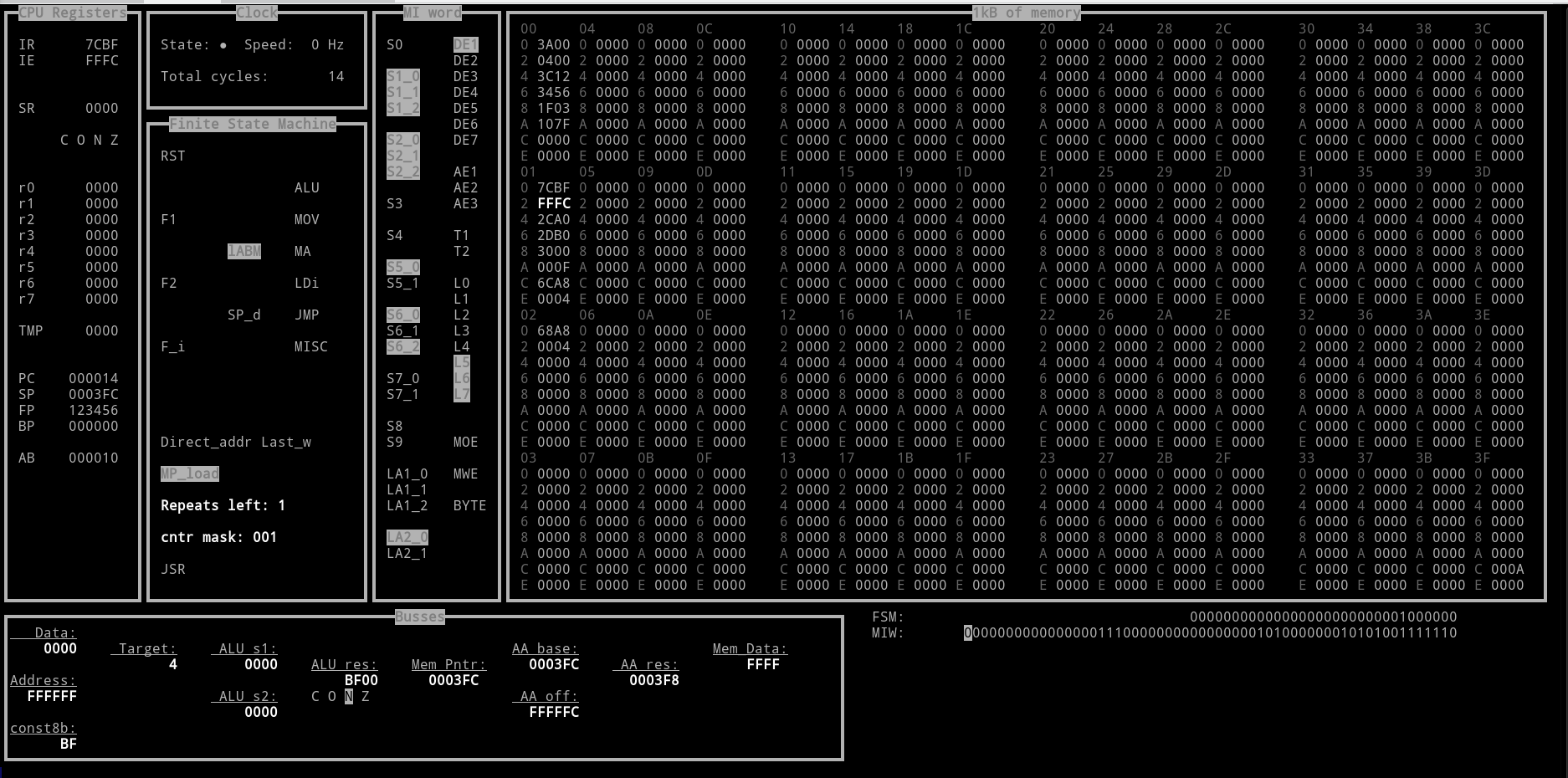

    A month ago I decided to create a small rtl emulation of my CPU design, to better grasp high-level view of it, and test some design changes and instruction sequences faster. This simplification was needed, because the model in Digital simulation became too complex and had some bugs with timings that I couldn't fix. Also this complexity would make revision of micro-operation sequencing very difficult.
    I thought the task would be simple, and take a week or two, as first idea was to make a list of registers and write some functions that would juggle around values between them. Turned up that it took more time, mostly because I ended up with more thorough simulation, with data structures for registers and busses, and sequential logic for data propagation which itself is often a parallel process. The ALU is just a functional description, but all the plumbing (busses, selectors) between functional blocks are accounted for in this emulation.
    Fair bit of time took the re-drawing of RTL scheme, and figuring out the correct data transfers for microinstructions. While doing so I found similarities between several states, and attempted to condense them. This made FSM to contain fewer states, but state transition logic became more complex.
    Here is part of the process of figuring out correct paths for data between registers for particular microinstructions:
    During this process, I also updated instruction encodings somewhat, and the RTL scheme itself, though marginally.
    I wrote the emulation in C, and for the interface used ncurses library, which proved to be very easy to use, and made me able to concentrate mostly on the workings of emulated CPU, and not spend too much effort figuring out the presentation.
    As of the time of writing, current emulation implements most of the instructions, in particular, ALU, memory accesses with all modes, MOVes and jumps (including JSR). Yet to be added are Address Arithmetic, interrupt related instructions and some other miscellaneous ones.
    Currently, running emulation looks like this (screenshot):
    I think in time I will make it slightly more colourful, but for now it is already very informative. It exposes most of the CPU insides, like register values, a selection of bus values, the control logic state, and control line activation pattern (microinstruction word), and all of the memory (1kB) at a glance. This proved very helpful in troubleshooting this emulation, as well as the little test programs I wrote for it.
    It is trivially possible to make the emulation with any memory size up to 16 megabytes, but more than 1kB will be hard to impossible to show at once. And for testing purposes current memory size is quite adequate.

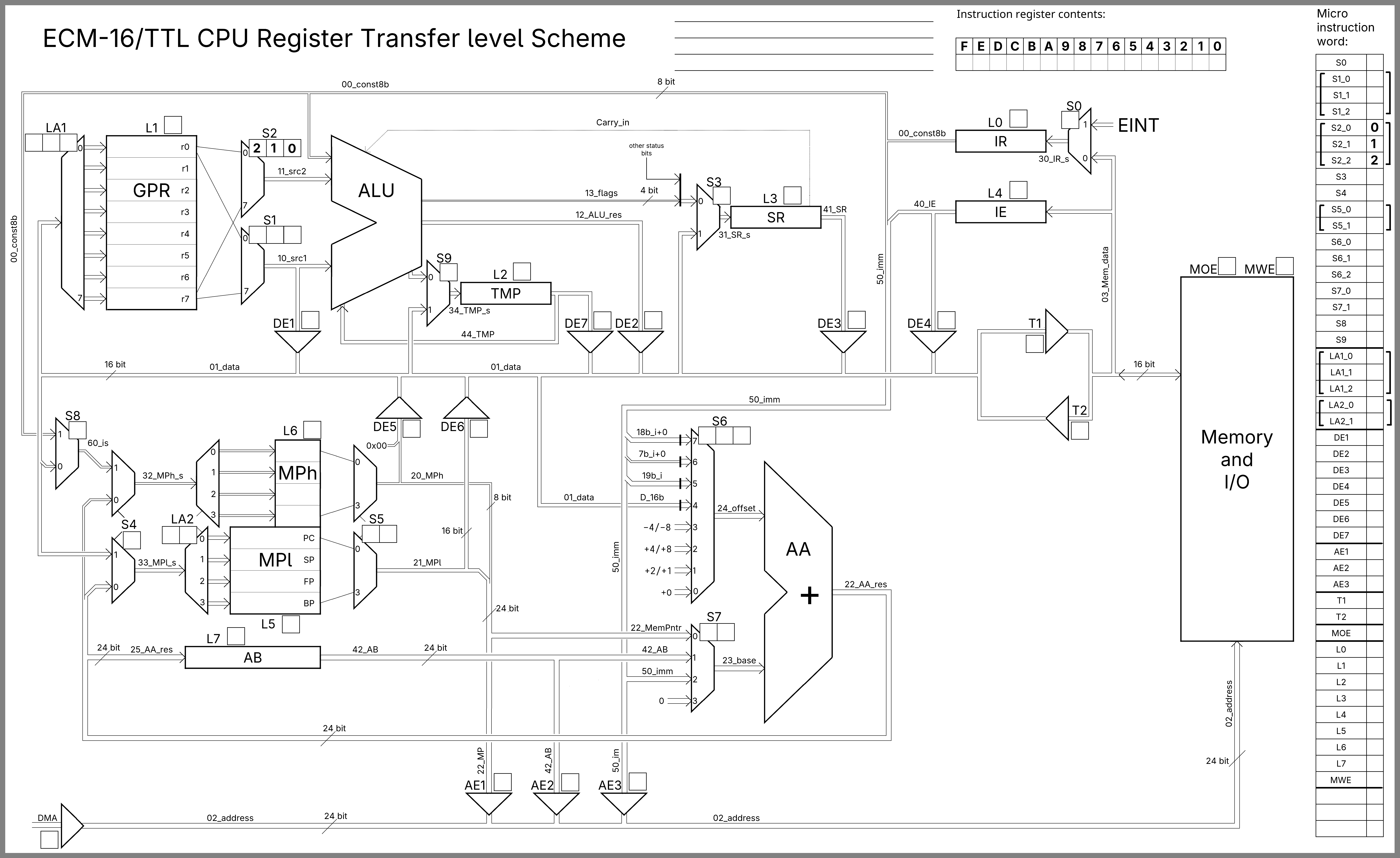

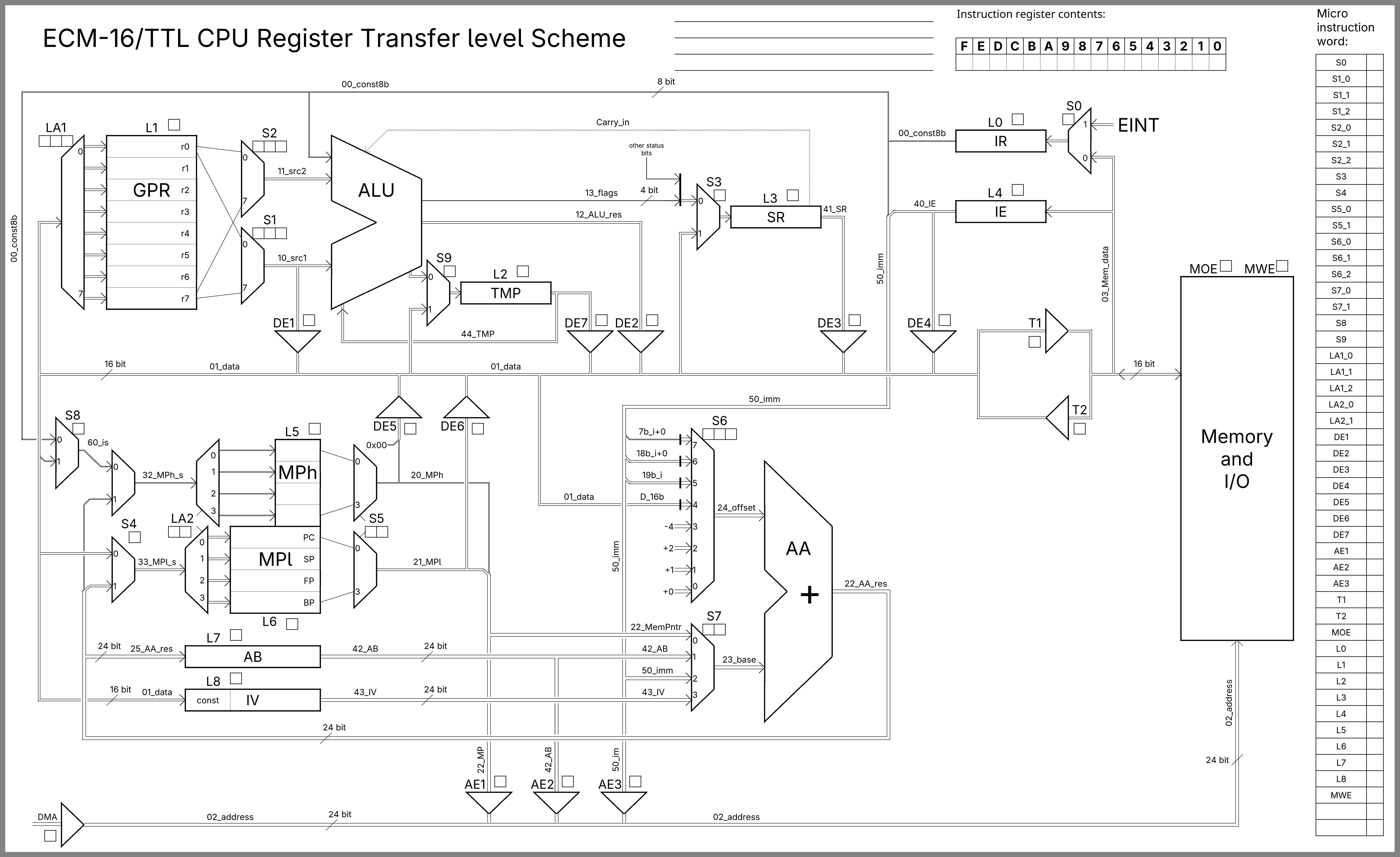

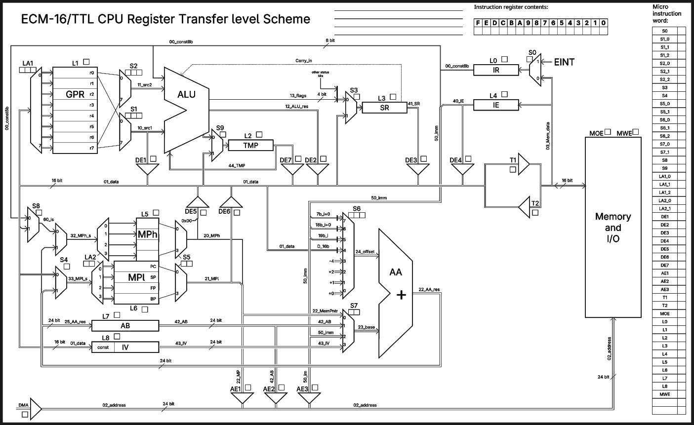

  • Update to RTL scheme
    Pavel05/16/2026 at 12:22 0 comments
    While trying to accomodate the features provided by funnel shifter, and changing address bus width to 24 bits, I started to look closely into the current Register Transfer scheme, and started to update it. I shuffled around parts of it for more clarity, and for including new features -- I've redrawn the scheme several times by hand, and after having a good variant, I drawn the scheme in Excel (this provides grid, and thus it is easier to make aligned drawings using different cell borders and applying different border styles to them).
    Here is the result:
    Compressed version:
    Full resolution:
    This is quite a detailed scheme, it is advisable to click full-scale by click on the above image.
    This updated scheme is also part of the effort to create an emulation of this CPU, about which I'll write in the next log.
    Such scheme makes for easier understanding of CPU inner workings, and devising microinstruction sequences for all the different instructions. The image presented is intended to be printed out in several copies for tracing out data propagation and capturing the proper pattern of micro instruction bits. I did the same thing 4 years ago on previous version of RTL scheme, but as I modified it, I need to redo this thing again.
