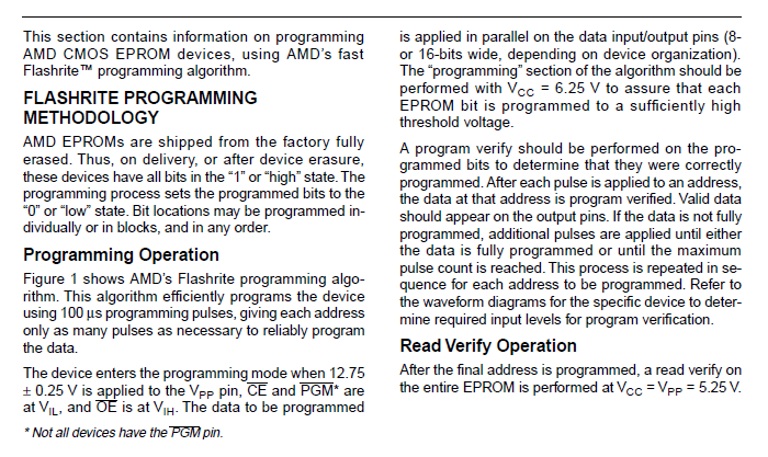

In order to build the memory-card, we need EPROMs. In most cases those EPROMs are UV-EPROMs, or EEPROMs, which stands for electrically erasable/programmable read only memory. In case of UV-EPROM, ultaviolet based erasable/programmable read only memory. Which means, the EPROM can be programmed once, but then needs an ultraviolet erasable device to clear the memory for further usage. This is not as convenient as the first one, but still quite easy to handle. One can buy such devices in electronics shops. Those EPROM's are very fast and mostly handle access times of at about 45 ns. Ideally suitable for micro-controller fast read/write cycles. They utilize the parallel interface which do require some amount of GPIO of the microprocessor. In my case, as one can see from pictures above, I have plenty of those AMD CMOS UV-EPROMs available brand new. So its suits perfect for creating memory card, where several of those IC's can rest, and thus making ideal solution for bigger memory projects without SPI or other types of memory cards and hassle and complexity which they do bring with them.Beside the CMOS EPROMs, a copper/epoxy based prototyping board is need, size may vary depending on how many of the EPROM's one plans to embed. The higher the number, the better for capacity. Next thing would be (green) smd LEDs, and one tht LED (red). Low power, low current (c.a. 20mA) should be fine. One needs resistors for each of those led's (R=150-180 Ohm) for smd leds and (R=470 Ohm) for tht led will do the work. For more convinience I recommend using headers to male the hole card plug-able module, (on solder-less breadboards or anywhere else), size of the headers also depend on the amount of embedded IC's. Jumper wires are needed if you plan to connect them by hand and not on PCB. Each CMOS EPROM require 16 x 10KOhm resistors for address bus data lines and 8x 10 KOhm for data-bus data lines.Each AMD EPROM has 8 ports for data lines and 17 for address lines. So a lot of jumper wires should be available.

The assembly starts by checking that all the EPROMs are erased and empty.
