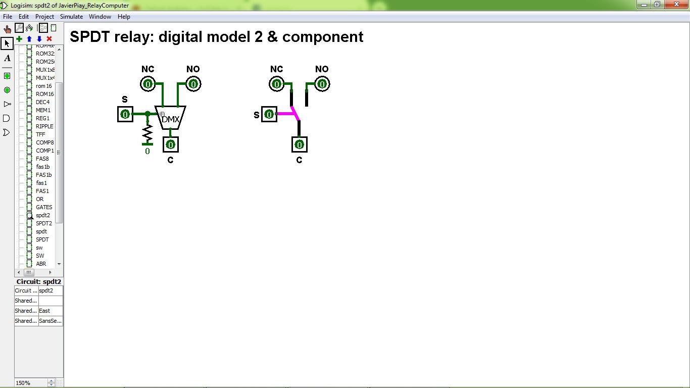

My ultimate goal is to build a relay-based version of my SANX-I microcomputer:
https://hackaday.io/project/162186-sanx-i-microcomputer

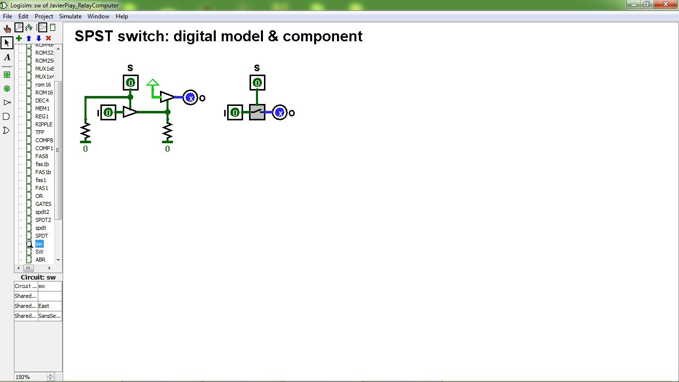

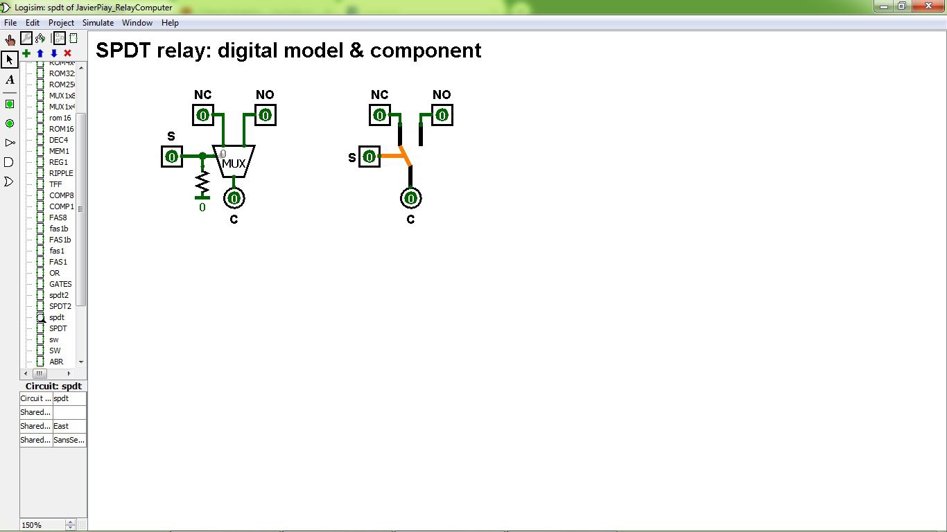

SPDT relay: digital model & component for simulation.
1-bit gates.
AND, OR, XOR, NOT
1-bit full adder.
S = NOT A * (NOT Ci * B + Ci * NOT B) + A * (NOT Ci * NOT B + Ci * B)
Co = NOT A * Ci * B + A * (NOT Ci * B + Ci)
Note:  (NOT Ci * B + Ci) = B + Ci
Phase #1: design & simulation.
Full adder/subtractor.
N-bit comparator.
T flip-flop.
Asynchronous (ripple) binary counter.
1-bit register connected to a bus.
When WRITE changes from 1 to 0, the value on the bus is stored in the register. When READ is 1, the value stored in the register is transferred along the bus.
1-bit memory: MEM[X,Y].
4 to 16 decoder.
Note: requires SPDT digital model 2.
4x4 ROM / LUT (lookup table).
Note: X1X0 requires SPDT digital model 2.

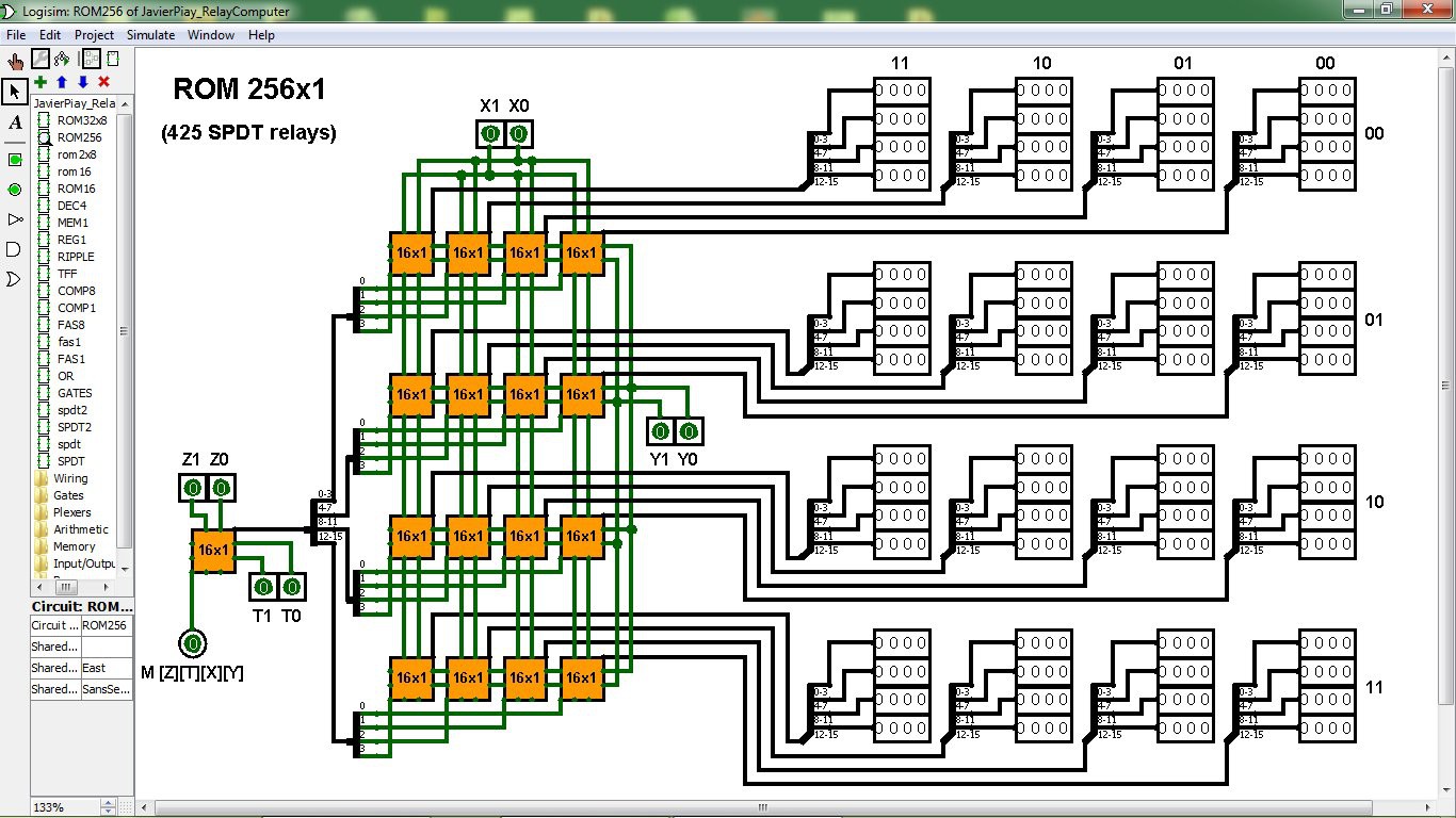

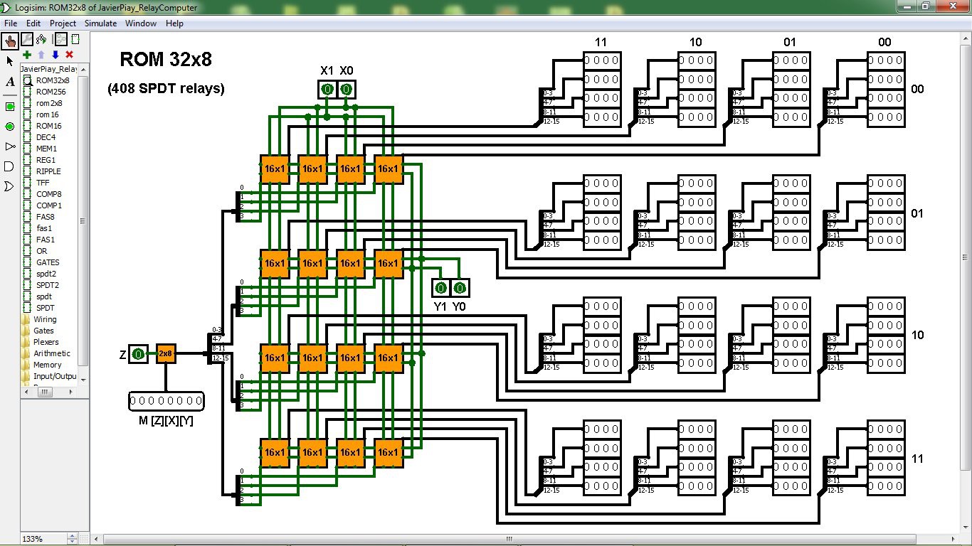

ROM (256x1 & 32x8).
  • SPDT solely
    Javier Piay (PROPHYCOM)01/10/2019 at 11:08 0 comments
    I'm aware of other great relay computing designs using multi-pole relays and/or other components like resistors, capacitors and diodes. I will try to use SPDT relays solely and avoid race/hazard conditions. I use pull-down resistors for simulation purposes and to couple relays with electronics, but these resistors are not part of the logic circuit.
    Let's see how far I can go...

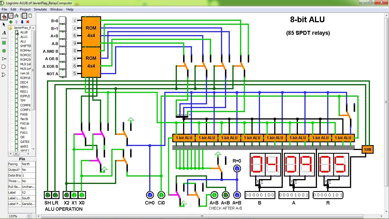

What about the computer architecture?
Well, that's the easy part ;)
#SANX-I MICROCOMPUTER
Yann Guidon / YGDES wrote 01/12/2019 at 21:17 point

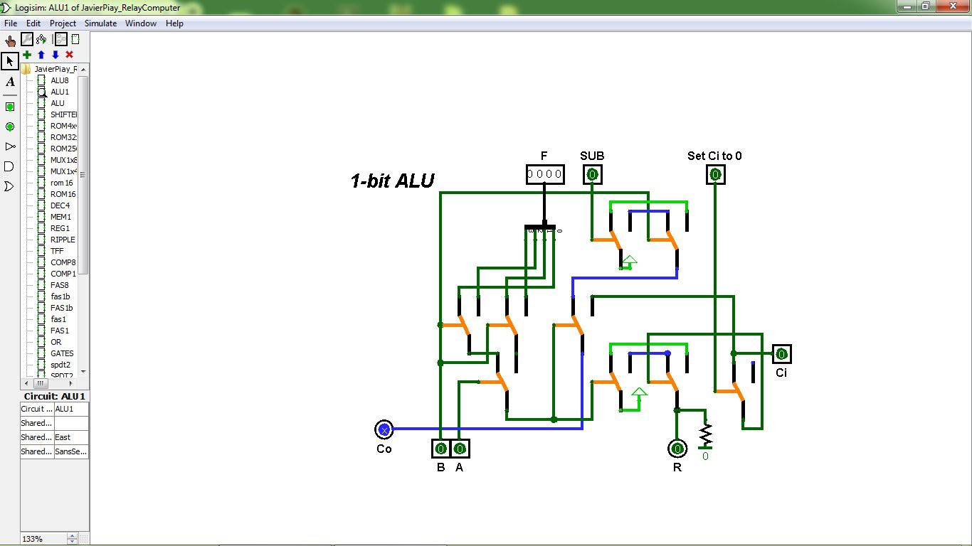

For the ALU, have a look at   #Simple Relay ALU  :-)
it uses diodes but it's pretty smart !
Javier Piay (PROPHYCOM) wrote 01/12/2019 at 21:43 point
I'm already aware... Thanks!
