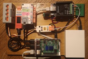

I live in a rented flat and didn't want to shell out ~£200 for a Nest thermostat, so I decided to build my own.
A smart thermostat that can be retrofitted to an existing boiler setup, using off the shelf components and lightweight networking protocols.
This project is designed to be a fully featured smart thermostat that will control the heating within my flat. I live in a rental, so there were a few constraints that otherwise would not apply to a heating control system.
Firstly it had to be able to be integrated into the current heating system, as I am not buying a new heating loop for a rental property. Secondly it had to be easily reversible, so that when I move out the flat I am able to remove all traces of the system and get my damage deposit back.
With respect to the actual features of the thermostat I wanted it to be able to give full daily granularity over different heating schedules and the ability to change settings (such as desired temp) without going into the actual code. This project is in active development, so I aim to add features as I am able to.
Until the project is complete, all further information will be included in the project logs. Once it is "completed" (as if any maker project is ever really completed) I will condense all the project logs into a main report that I will put in this section. I will also write full step-by-step instructions, including all code and software elements, so that anyone can emulate it.

    For this project I decided to go for a star network topology to build my smart thermostat, this is a system where there are a number of nodes, all connected to a central hub (see below).
    Star network topology
    This model brings various benefits and can be described as the status quo for  IoT project architectures (I am super original). It's benefits include the fact that it is modular and can be easily extended via adding in new nodes and functionality as required. Finally this network topology lends itself perfectly to the use of the Message Queue Telemetry Transport (MQTT) protocol for intra-device communication. This is an extremely lightweight protocol that works on a publish/subscribe model and is already implemented in many home automation scenarios.
    Turning a Model Into Reality
    Now I had the desired topology, I had to find components that would work well with MQTT and the node/hub architecture.
    Some people decide to use a full home server as their hub, but that would almost certainly defeat the point of building this system to save myself money, not to mention it would be ridiculously under-utilised. Instead I decided to use a spare Raspberry Pi 3B that I have. Not only does this run 'full' versions of Linux, but it also uses very little power.
    For the node elements of the network I will be utilising the NodeMCU development board. This is a board based on the ESP8266 WiFi module, however it has components attached that allow programming directly from the Arduino IDE (in fact any IDE that has Arduino plug-ins available; I use VSCode).
    To summarise, I plan to use a Raspberry Pi as a hub and the nodes will communicate via the hub using the MQTT protocol. Currently I am planning to utilise two nodes, one that will sense the temperature and another to control the heating system. There will be logic running on the Pi to parse the temperatures that are sent to it and the same program will decide whether to turn the heating on or off as a consequence of the inputs. This signal will be sent via MQTT to the node that controls the boiler.
