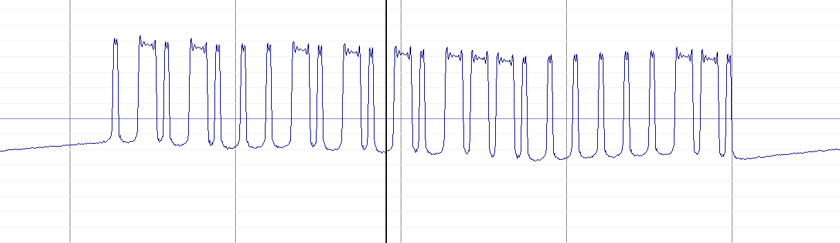

I fired up GQRX with an RTL-SDR dongle and recorded audio of AM-decoded transmissions from the light-control transmitter. They look like this:
I ended up writing python code to trigger on the leading edge of this pattern and average a number of them because I need that functionality for another project. Then, I thresholded the result, and calculated the run lengths of the on and off times. The dwell times are in a 3:1 ratio, so I called them "dit" and "dah" in the code, because the timing reminded me of Morse. Rather than coming up with some fancy encoding for the bitstream, I had the python code dump out in-lined C++ that I could paste right into arduino-land.  It's terribly ugly, but it works, and looks like this:
