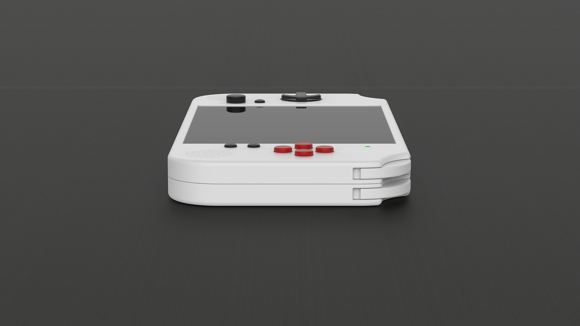

This is my Raspberry Pi 3-based portable console, I designed and built from scratch.
The system is built around emulation and plays classic consoles like the Sega Megadrive, Super Nintendo, Game Boy Advance, PlayStation and many more.
 Specifications:
DimensionsWidth: 277 mm (10.9 in)
Height: 134 mm (5.3 in)
Depth: 21 mm - 25 mm (0.83 in - 0.98 in)
SBCRaspberry Pi 3 A+
Display7.9-inch in 4:3 aspect ratio, 60 Hz 2048 × 1536 IPS LCD
AudioTwo 3 W speakers Ø28.5 mm (1.1 in), 3.5 mm headphone jack
BatteryLi-Po battery/8000 mAh (3 to 6 hours of game playing)
Power LEDWith low, charging and charged battery indicator
Storage16 GB MicroSD card
Size comparison:
  • 1 × Raspberry Pi 3 Model A+
  • 1 × LG Display 7.9" 4:3 aspect ratio, 2048 × 1536 IPS LCD.
  • 1 × Red & Green LED (3mm)
  • 1 × NeoPixel LED
  • 1 × Heat sink For the Raspberry Pi.
View all 20 components

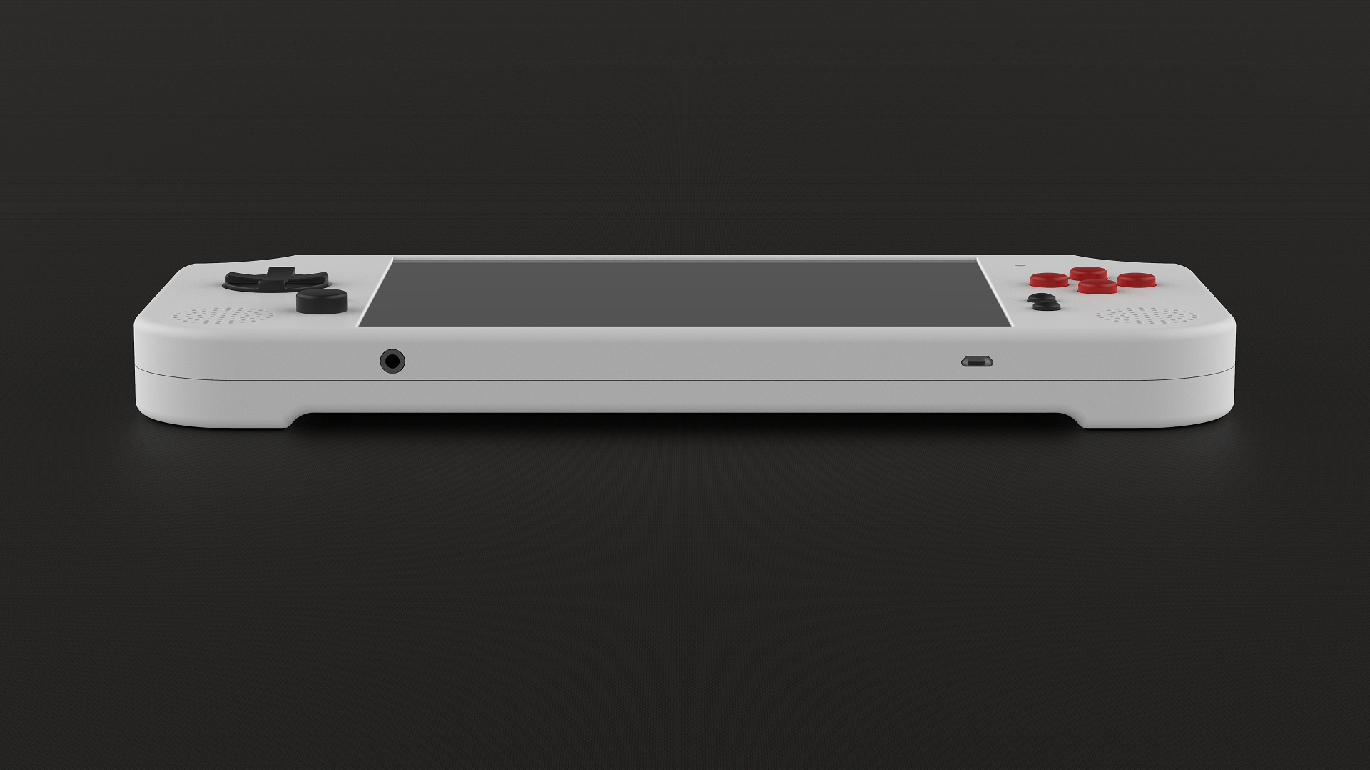

fabian wrote 4 days ago point
nice but .....
1. i need usb c
2. i need small hole for rope
3. how writing wifi password? beybe add normal usb A?
4. how long this device working? if i can play 5h i dont but this device. I need 12h minimum
5. meybe put fpga for reducing power
6. where are rotor potenciometer? tell me how play in tempest with keys, impossible
James Hall wrote 4 days ago point
You don't need much do you?
c wrote 4 days ago point
1.
Maybe later.
2.
Sometime, maybe.
3.
You don't need to connect a keyboard to write the password to the Wi-Fi. There's an on-screen keyboard that pops up when you want to write, so you just use the buttons on the console ;)
4.
12 hours will be pretty hard to achieve with a display this big.
It would have to be around 20 000 mAh, and a battery of that size won't fit at the moment.

A L wrote 05/16/2019 at 22:34 point
How are you driving an eDP panel from HDMI?
c wrote 6 days ago point
With an adapter ;)
