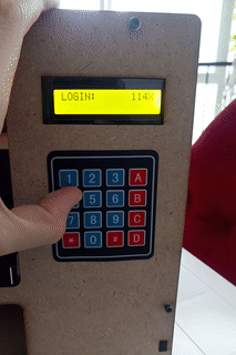

What I have so far is a simple vending machine, 2 rows by 2 columns 3 products per cell, payment by rfid or login/password.
The offline version is done, now I'm looking for some online features to aad users and check their identity over the internet.
Current status
Currently I have a full offline working version as following:

  • 2 rows by 2 columns and 3 products per cell, every product allocated in 3cm threads;
  • No motor apparent from outside;
  • A "lockable" front door;
  • Arduino uno and WorldSkills STM32L boards compatible;
  • Login/password to "buy"
  • RFID to "buy"
  • Mechanics reliable and digitally fabricated.

    Mechanical assembly
    An image says more than 100 words, so I'll post some images about the proper order to assembly it, but isn't hard at all.
    1. Start by the middle wall, pay attention on the parts orientation, is quite easy to assembly in the wrong side.

    15. Stick the keypad, put some good quality double faced tape in the RFID. I also preferred to extend the cables at this point, later will be hard to put the hand inside the machine to connect it.
    16. Use some washers as spacers to add some tolerance for the sliding door, then screw the front mdf place using M3x20 screws, nuts and washers.
