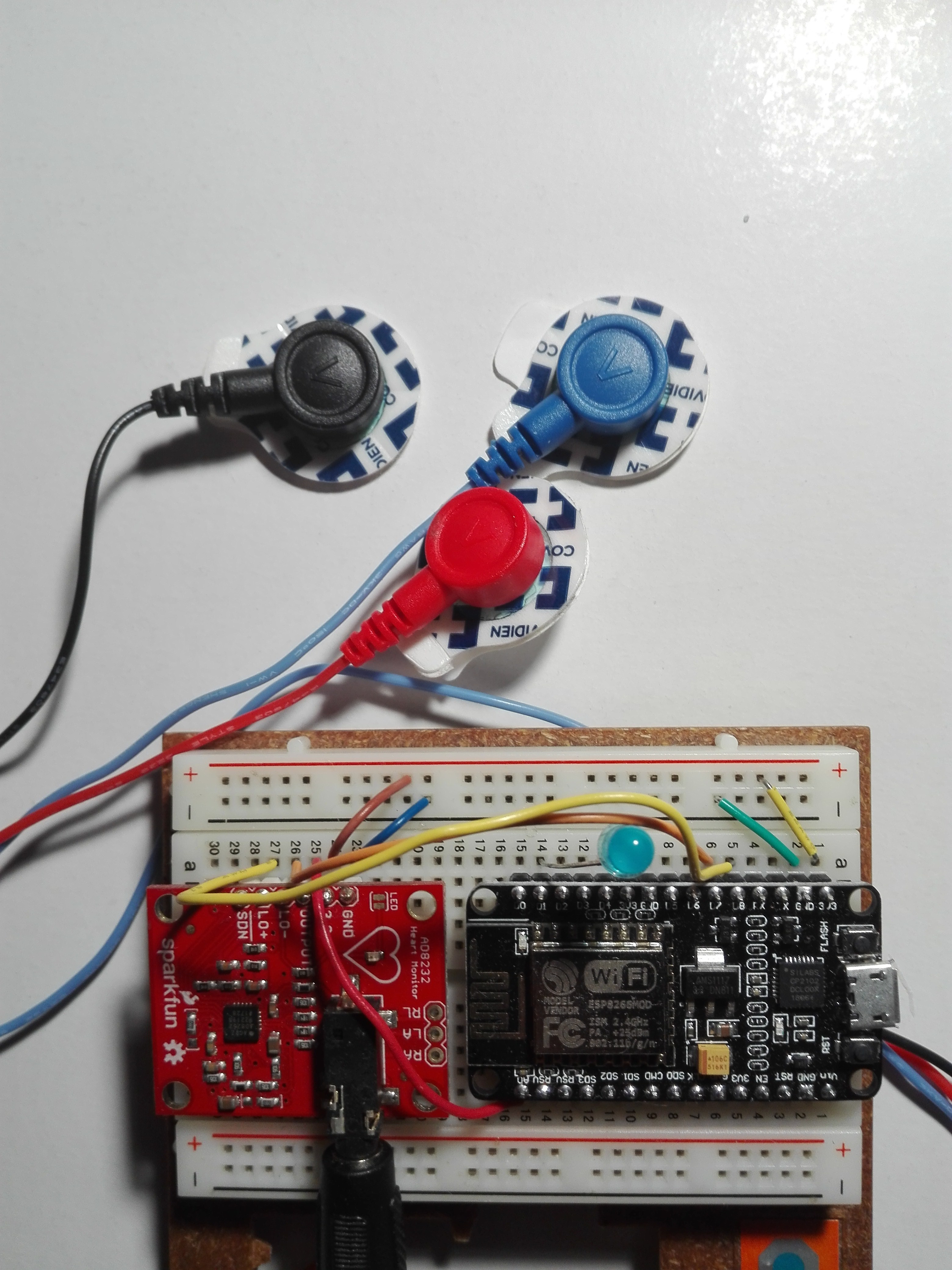

Send ECG Data with MQTT
A project log for Clintelli
Clinical Intelligence: modular IoT wearable and AI for clinical data monitoring
Alex KaradimosAlex Karadimos 07/21/2019 at 18:500 Comments
In the next step of our prototype development, we replaced the simple temperature sensor with the ECG module and made the necessary changes in code to send ECG data with an MQTT publisher via the RabittMQ MQTT broker.
#include <ESP8266WiFi.h>
#include <PubSubClient.h>
#include "secret-config.h"
WiFiClient espClient;
PubSubClient client(espClient);
String msg;
char payload[50];
unsigned long lastMicros = 0;
const int analogInPin = 17;
float getECG(void) {
	float analog0;
	// Read from analogic in.
	analog0 = analogRead(analogInPin);
	// binary to voltage conversion
	return analog0 = (float)analog0 * 3.3 / 1023.0;
void setup_wifi() {
	// Connecting to a WiFi network
	WiFi.begin(ssid, password);
	while (WiFi.status() != WL_CONNECTED) {
		delay(500);
		Serial.print(".");
	Serial.println("WiFi connected");
	Serial.println("IP address: ");
	Serial.println(WiFi.localIP());
void reconnect() {
	// Loop until we're reconnected
	Serial.println("In reconnect...");
	while (!client.connected()) {
		Serial.print("Attempting MQTT connection...");
		// Attempt to connect
		if (client.connect("Arduino_Gas", mqtt_user, mqtt_pass)) {
			Serial.println("connected");
		else {
			Serial.print("failed, rc=");
			Serial.print(client.state());
			Serial.println(" try again in 5 seconds");
			delay(5000);
void setup() {
	Serial.begin(115200);
	setup_wifi();
	client.setServer(mqtt_server, 1883);
void loop() {
	char msg[8];
	// Desired sample rate T=7812microseconds
	if (micros() - lastMicros > 7812) {
		lastMicros = micros();
		// float temperatureC = getTemperature() ;
		float ecg = getECG();
		sprintf(msg,"%f",ecg);
		// Serial.print("temperature read");
		if (!client.connected()) {
			Serial.print("trying to reconnect...");
			reconnect();
		client.publish("mq2_mqtt", msg);
		//Serial.print("Payload: ");
		Serial.println(msg);
