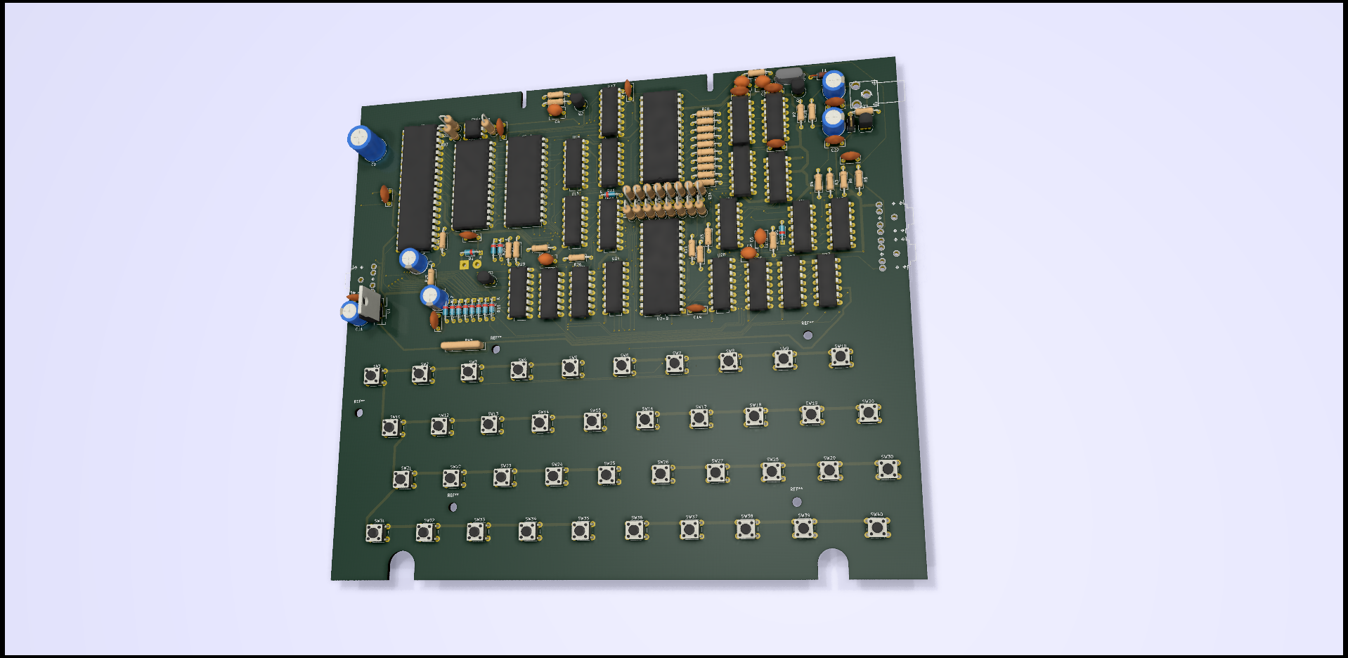

The PCB
Though it's possible to create the exact PCB replica using Grant Searle's PCB foils, that is not what I wanted. I did want to make some minor changes on the EPROM and RAM connections, and use standard mini switches for the keyboard. Also if the PCBs have to be made by a cheap Chinese shop, it's essential to have Gerber files. So, all in all a good incentive to replicate the schematics again, but now in KiCad. For years KiCad has been a bit troublesome to use, but over the last few years it has improved significantly and is now a serious EDA package. It's free, open source and multi-platform so it is becoming the de-facto standard for all open-source hardware projects.
My board (on the right), next to the replica board of Grant Searle

    After half a day of soldering, the board looks like this:
    Everything fits like a charm, and it really starts to look like a Jupiter ACE. So it's time to start testing, and carefully insert all chips.

 I tried to quickly import into my KiCad 6 app, and after I ran some checks in the PCB traces, I got around 37 errors, mostly overlaps.
I inspected, and it really looks like there are overlaps.
I wonder if that was because I imported it into KiCad 6 - which version did you use?
Thanks for this great work. I will try to build it if I get all the clearances errors cleaned up in KiCad.

I think Cees started the project before v6 was released. If you had to do an import then he did it with v5. You're lucky only clearances are involved. Do feed back the updated project to Cees.
Cees Meijer wrote 10/25/2022 at 11:47 point
Thanks for the praise. Glad you like it, and I always find it exciting when other people decide to build it too. If you finish it I'd love to see the results.
Regarding the import in KiCad 6: I think this probably causes the issues that you see. I did the whole project in version 5. I did try 6 as well, last year, but soon found that most of my designs had issues after importing them so I reverted to 5 again.
