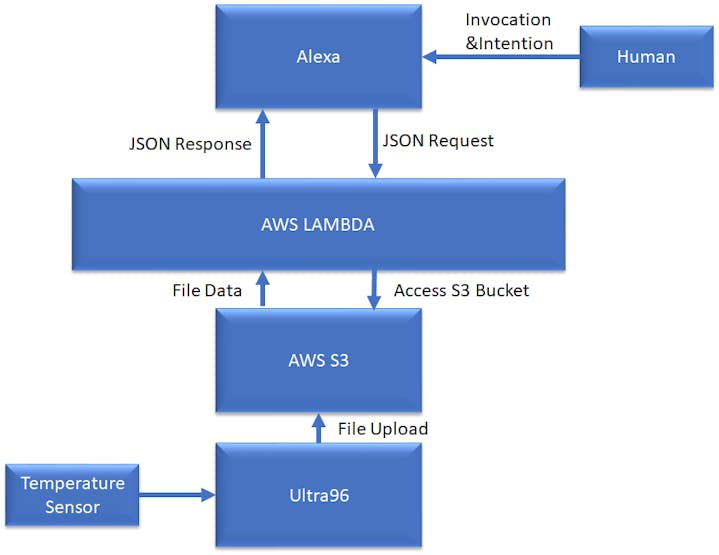

This project will use a number of AWS functions both at the edge and in the cloud. The architecture of the solution is outlined in the diagram below:
Architecture of the Solution
Once Alexa receives the invocation and intent word, we will configure the Alexa skill to send a JSON request to a AWS Lambda service. AWS Lambda will then access a AWS S3 bucket and read a file which has been uploaded by the Ultra96 with the current measured temperature.
AWS Lambda will then process the file and generate a JSON response which Alexa interprets and voices the temperature.
Of course while this example shows the communication path in one direction, we could use the same approach to control actions in the Ultra96.

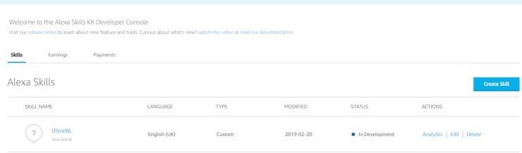

The first thing we need to do is create a Alexa skill we do this by going to the Alexa developer console here:
https://developer.amazon.com/alexa
Once logged into the console we need to create a new skill - click on the Create Skill button.
Creating the Alexa Skill

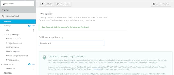

Click on the created skill and we can step through the skill creation process, the first step is to create the invocation word. This is what we say to Alexa to start the interaction with our Skill - I used "Ultra Ninety Six" for this application.
Invocation word
Invocation word

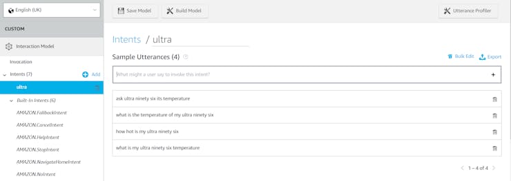

The next step is to configure the intents, we can have multiple intents but for this example we will have one which is the intent for requesting the temperature.
Intents
Intents

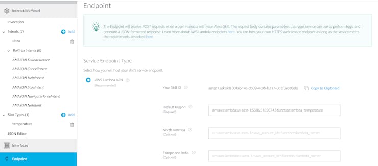

Once we have set up the invocation and intents, the next step is to set up the end point.
This is where we set up up the interface with AWS Lambda here will, use the skill ID and the AWS Lambda settings.
Integrating a end point with AWS Lambda

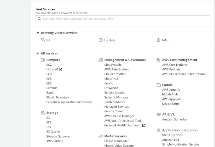

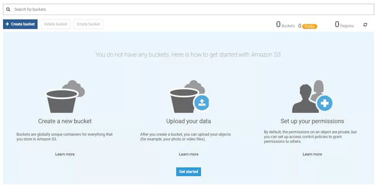

Setting up the S3 Bucket
Before we set up the AWS Lambda we need to be able to store files on the S3 Bucket. If we do not have a S3 bucket we need to configure one, sign into the AWS console and from storage select S3.
AWS Console
AWS Console

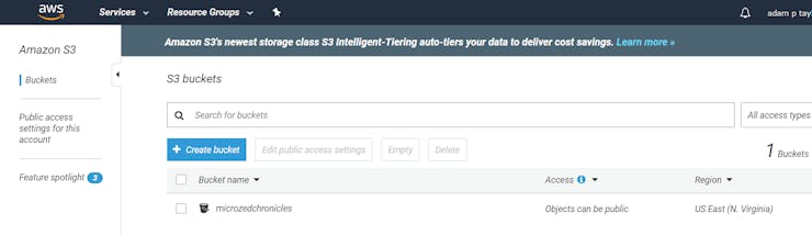

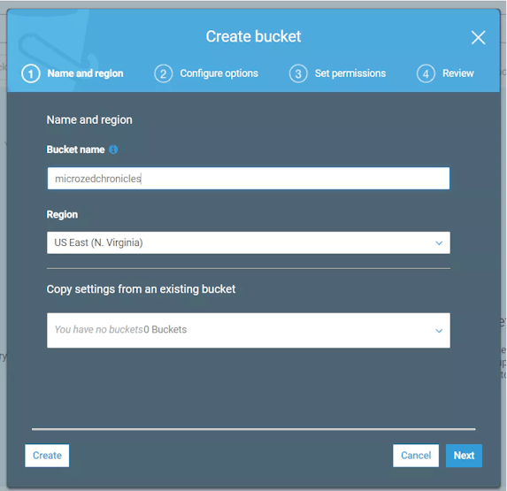

When you open the S3 instance you will see the following screen enabling you to create a bucket.
Creating a AWS S3 Bucket
For this example I called my bucket the MicroZed Chronicles:
Configuring the Bucket
Resultant Bucket
Resultant Bucket

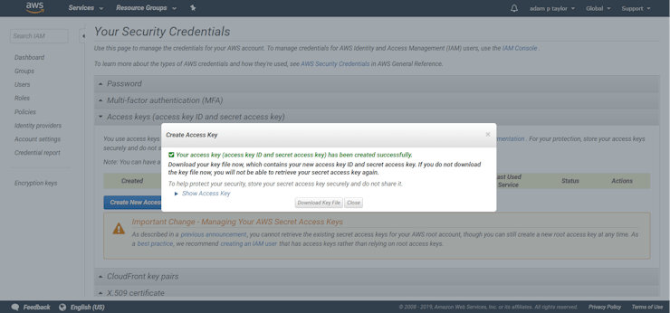

The final step is to generate the keys to enable us to access bucket. Click on your user name on the top right and select "My Security Credentials."
Under here you can create a Key ID and Secret Access Key.
Generating access keys

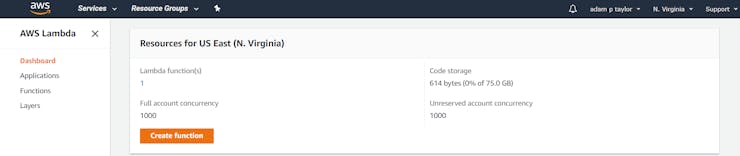

AWS Lambda
Within AWS Lambda, we need to create a function, click on the create function button.
AWS Lambda Welcome page.

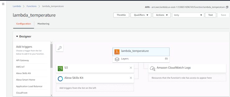

Once the function is created we need to edit it - I called my function Lambda temperature.
AWS Lambda function
AWS Lambda function
The first thing we need to do in the Lambda function is to add in the triggers. In this case these are Alexa and S3 Bucket.
Adding the triggers
Adding the triggers
The next step is to add in the Node.Js code for the Lambda temperature, I used the code below - Remember to replace the KEY and SECRET KEY with your credentials.
exports.handler =(event, context, callback) => {      var prompt = '';     var myParams = { Bucket:'microzedchronicles', Key: 'data.txt' };    varAWS = require('aws-sdk'); var s3 = new AWS.S3();    AWS.config.update({    accessKeyId:"KEY",    secretAccessKey:"SECRET KEY"    });  s3.getObject(myParams,function(err, data) {     if(err) {         console.log(err, err.stack); }    else {         var fileText =data.Body.toString();         prompt += fileText;        callback(null,buildResponse(fileText));        }    });  };  functionbuildResponse(response) {
return {    version: '1.0',    response: {        outputSpeech: {            type: 'PlainText',            text: response,        },        shouldEndSession: true,        },    sessionAttributes: {},    };
Within Lambda we can set up a test invocation to test our responses, and remove any errors without the need to go via Alexa.

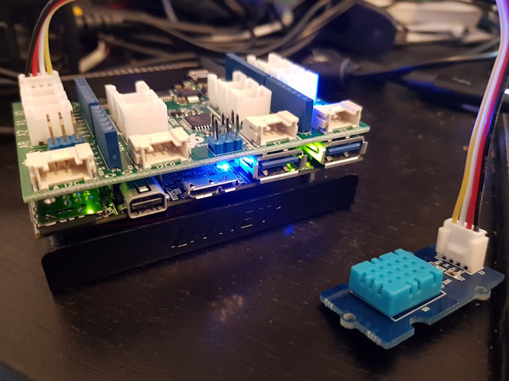

To measure the temperature the Ultra96 will be connected to the grove starter kit for 96 boards and the temperature sensor as shown below.
Ultra96 Configuration

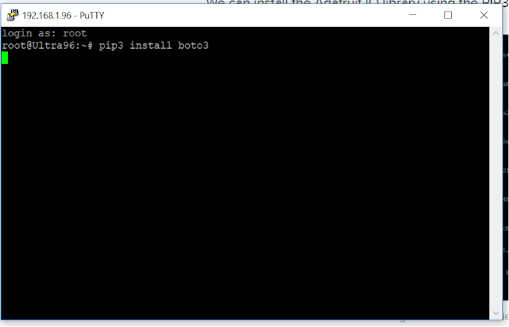

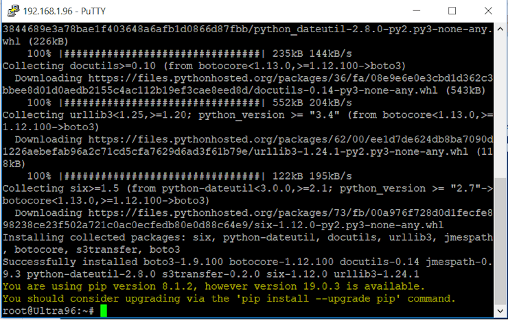

Connect the Ultra96 to a network which enables internet access and SSH into it, we need to download the python packages which allow us to work with the AWS and the S3 Bucket we created.
Connecting to the Ultra96
Complete Installation of AWS Boto3

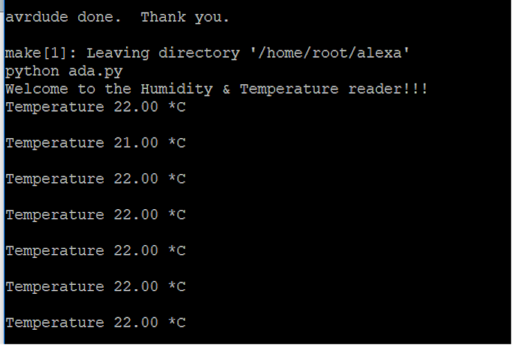

We can run the application by running run_me.sh on our Ultra96
Application Running on the Ultra96

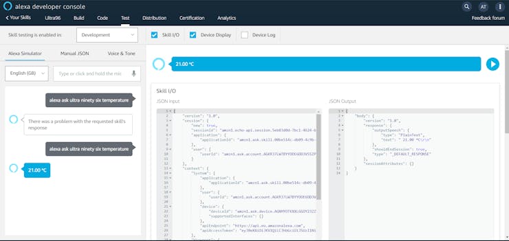

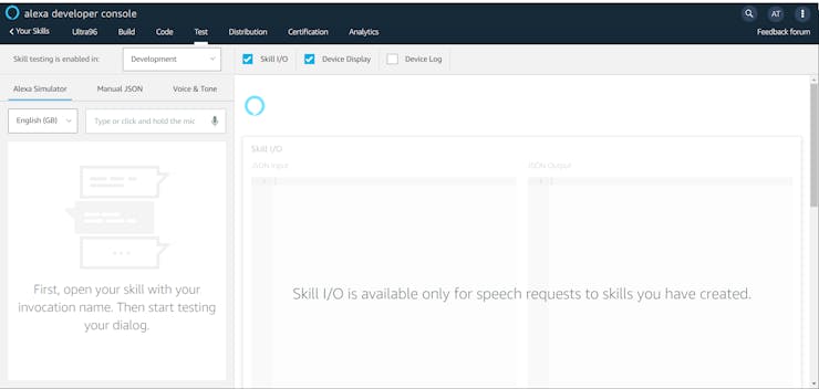

To test the application we can go back to our Alexa skill and select the test application on the test applications tab
Alexa Skill Test
Alexa Skill Test
You will be able to see both the output and response JSON files
Alexa Skill working
Alexa Skill working
When I put this all together I was able to talk to Alexa using the invocation word and obtain the temperature as monitored by my Ultra96.
