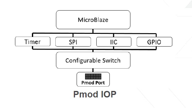

To be able to make use of the Pmod interfaces the PYNQ framework uses Input Output Processors (IOP) within the programmable logic. These are Microblaze processors which are connected to a input / output switch to support several IO standards currently used e.g. IIC, SPI, UART, GPIO etc.
This lets us offload lower level, real-time interfacing to the programmable logic, enabling a more responsive solution.
Concept Diagram
Concept Diagram
All of the IP needed to implement a IOP is provided within either the Xilinx IP or PYNQ IP library.

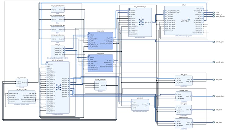

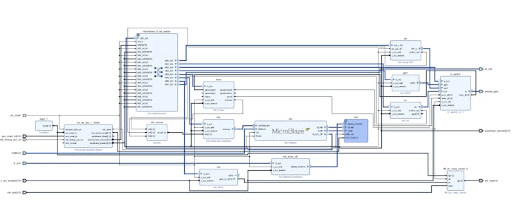

Once this is downloaded we can create the base application using the IP available within the /PYNQ/Boards/IP directory.
In this case the completed design for the Zybo Z7 board can be seen below and includes not only the IOPs but also GPIO for the buttons, switches, LEDS and three color LEDs.
Zybo Z7 Base PYNQ Design
A very important aspect of this solution is the use of the AXI interrupt controller to cascade the interrupts to the Zynq interrupt Generic Interrupt Controller.

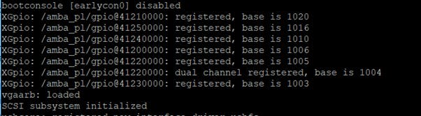

Once the boot is complete using a serial terminal we want to check that we can see the AXI GPIO in the LINUX device tree. From a command prompt we can run the command
dmesg
This will list the boot message and we can scroll through the message until we find the GPIO registration
AXI GPIO Registration in PetaLinux

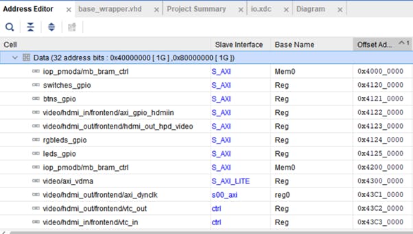

We can compare this against the memory map in Vivado and the addresses should be the same
Vviado Memory Map
Vviado Memory Map

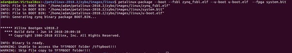

To do this we need t do two things first package the image then the BSP we use the commands
petalinux-package --boot --fsbl zynq_fsbl.elf --u-boot u-booot.elf --fpga system.bit
This will create the boot.bin needed to bot from a SDCard
Packaging the Image
Packaging the Image

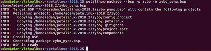

Once the boot files are available the final step in PetaLinux is to create the BSP we do this by using the command
petalinux-package --bsp -p zybo -o zybo_pynq.bsp
NOTE to package the BSP we are outside of the PetaLinux project when we issue the command
Creating the BSP
Creating the BSP

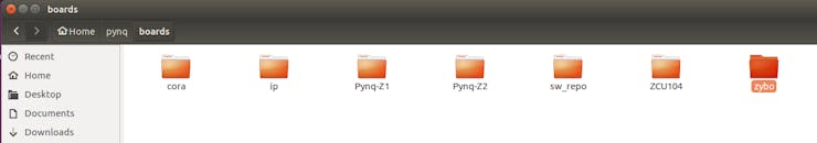

To create a new PYNQ image we are going to first need to create an new board definition in the folder pynq/boards
New Zybo Folder
New Zybo Folder

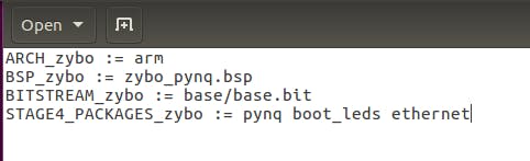

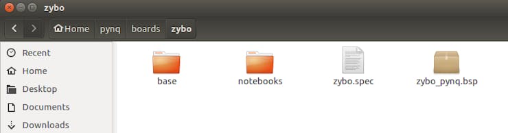

Inside the ZYBO folder we are going to include the BSP, Bit file and a board definition
zybo specificaition
zybo specificaition
It is inside the Zybo specification file that we define the location of the bit file, bsp and architecture.
Zybo specification
Zybo specification

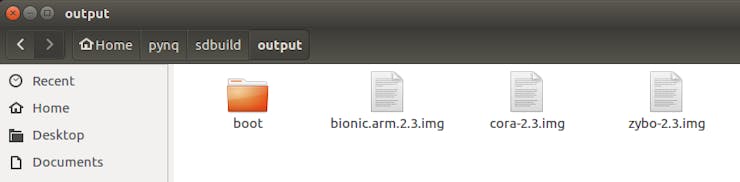

make BOARDS=zybo
This will take a few minutes but once it is completed you will see the image available under
pynq/sdbuild/output
Output Images
Output Images

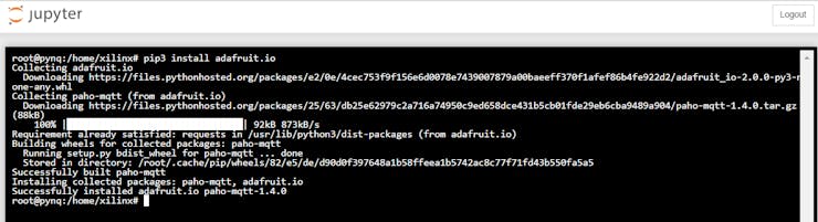

In the PYNQ environment we need to open up a terminal and install the adafruit.io packages using the command below.
pip3 install adafruit.io
Downloading and Installing the Adafruit.io packages
Once we have downloaded this we can use these packages to push data to the cloud.

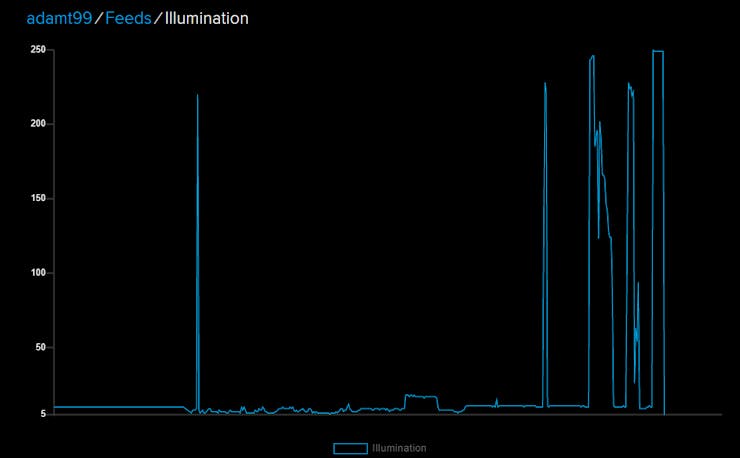

The code will sample the ALS sensor every 5 seconds and push the sampled data to the Adafruit cloud as can be seen in the plots below.
Plotting ALS data
Plotting ALS data
Plotting ALS Data with external illumination

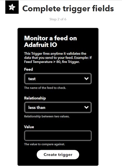

To enable the observed value to take an end effect we use IFTTT which will monitor the adafruit.io cloud feed.
Depending upon the value in the feed the Phillips Hue light can then be turned either on or off.
IFTTT Configuration

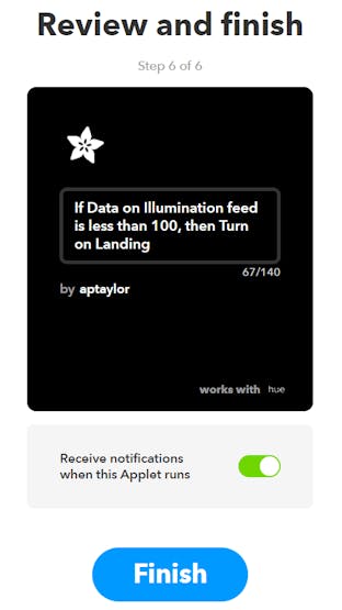

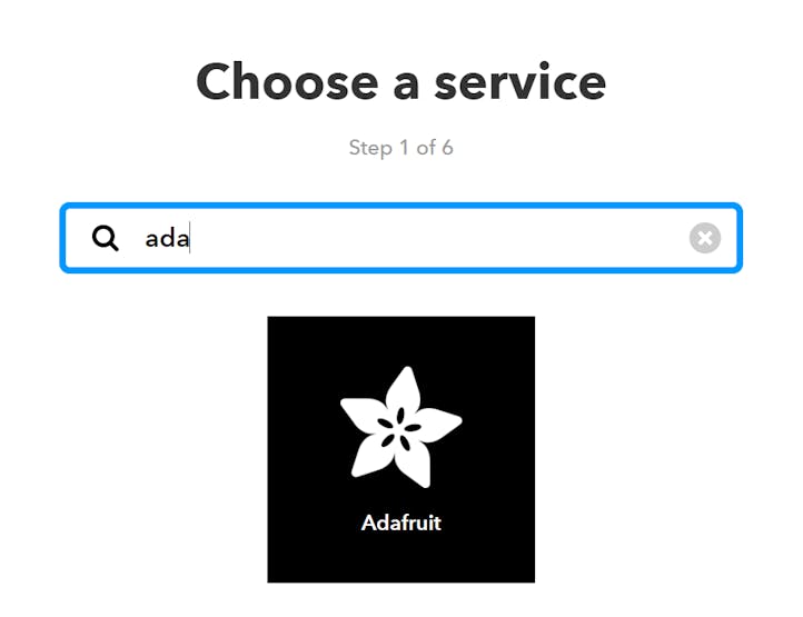

To do this we need a IFTTT account, once we have an account we can create a new applet.
To use IFTTT with the feeds in our Adafruit IO account we need to enable IFTTT integration such that our IFTTT can access our feed. This can be enabled under your IO Adafruit profile, you may need to create an IFTTT account first to connect to it.
This is a six step process, the first thing we want to check is a service in this case it is Adafruit.
Once we have selected the Adafruit service we need to select the feed we wish to monitor and the relationship e.g. equal to, greater than, less than etc.

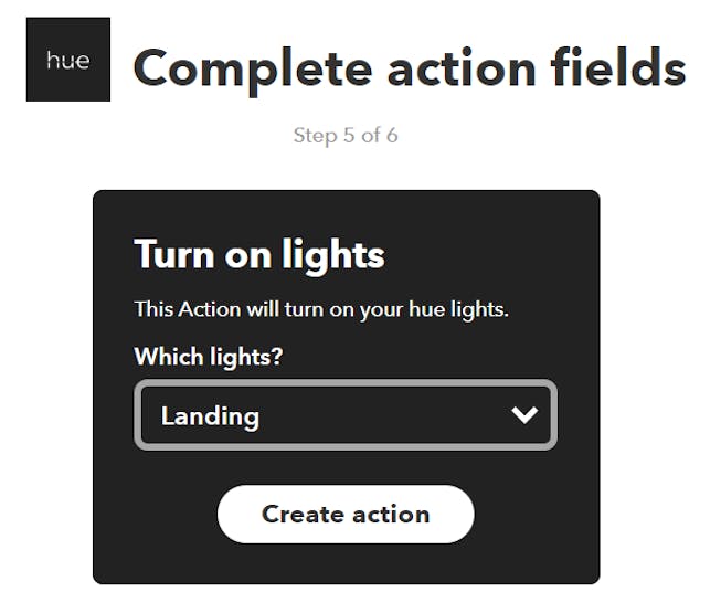

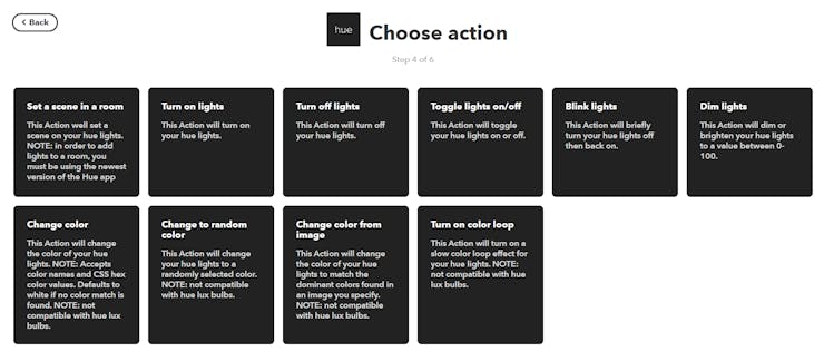

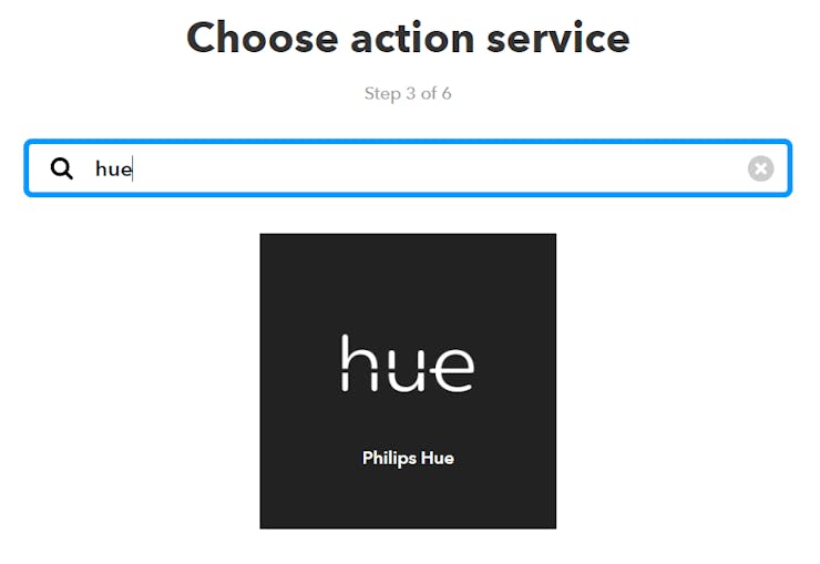

Once we have defined the relationship we need to be able to select the action service in this case it is Phillips Hue. To make ensure we can use the Phillips Hue with our application we do need to authorise IFTTT use in the Phillips Hue management application.
We can now choose the application we desire, e.g. turning a selected light on or off. This allows us to define two applets one to turn the light on if the ALS is below a set value, the other to turn the light off if it is above a set value.
Once we have identified if we wish to turn a light on or off we can select which exact light, a group of lights or all lights.
Once this is selected we have completed the applet creation.
Plotting ALS data
Plotting ALS data
IFTTT Configuration
Running this you will see the light turns on and off depending upon the illumination the ALS is subject too. To change the ALS value I used the flashlight (tourch) built in function on my mobile phone.
