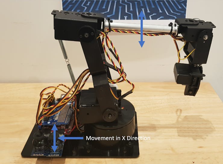

How we use the joysticks is interesting they give direct control over the arm. As such we need to ensure the movement between the joystick and arm aligns.
Of the two joysticks the first one is connected to JA and the second the JB.

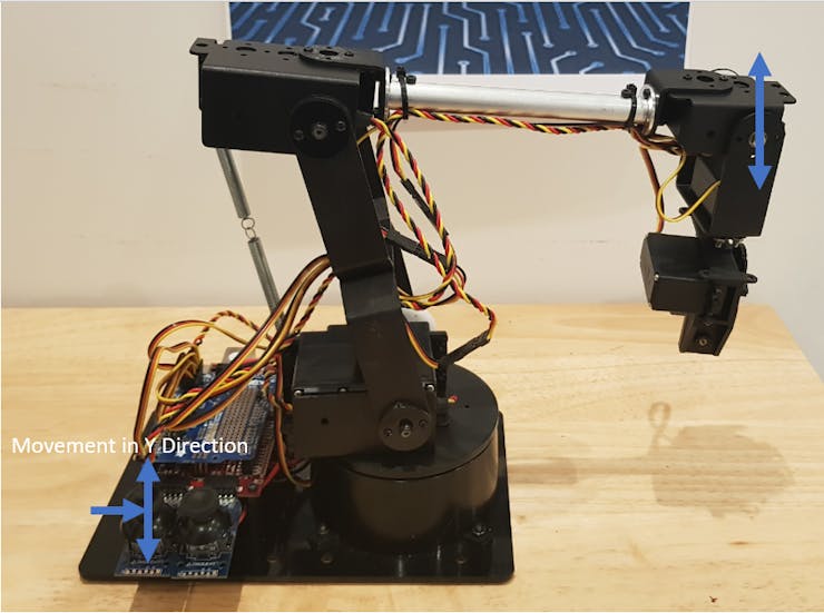

JA when moved in the X direction will move the arm forwards or backwards, when moved in the Y direction it will move the arm up and down.
Moving JA in the X Direction moves the Arm forwards or backwards

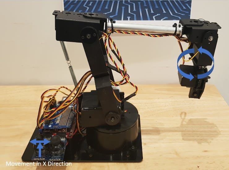

JB when moved in the X direction will rotate the wrist, while moved in the Y direction it will move the wrist up and down.
Moving JB in the Y direction tilts the Wrist
Moving JB in the X direction rotates the wrist
If you are paying close attention you will be thinking that we have not addressed the rotation of the arm around its base or the operation of the gripper.
We control these by using the triggers however, when the Pmods are connected to the Arm it is difficult to reach the triggers below.
Instead we will be using pushing down on the joystick itself. If we press down on JB then the end gripper will close and stay closed until we release it.
To rotate around the base we use the same trick pressing down on JA and the rotating in the Y direction will rotate the Arm around its base.

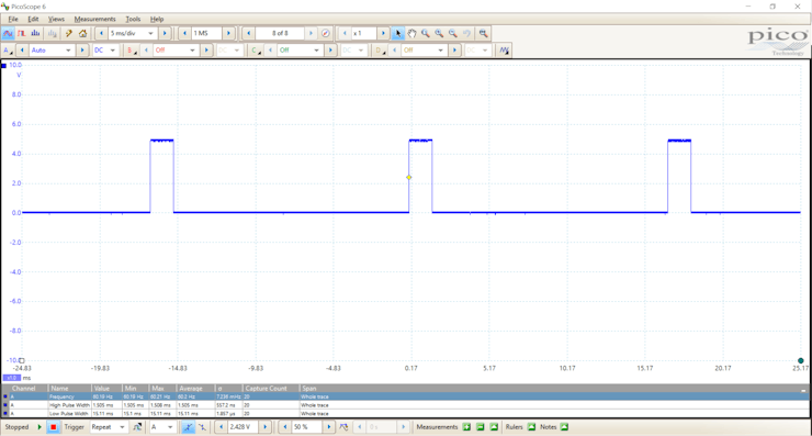

Once the Vivado build and initial software are available the next step is to ensure the software is capable of moving the servo correctly. I did this before I connected the servos to the PWM shield just in case I had something incorrect.
Using a oscilloscope I was able to measure the PWM signal as I moved the joystick about.
The pulse width moved from 0.5 ms to 2.5 ms gradually as the joystick was moved.
Nominal Servo Driving 1.5 ms
When I put this together the arm worked as expected and we can control it however desired within the envelope of movement.
