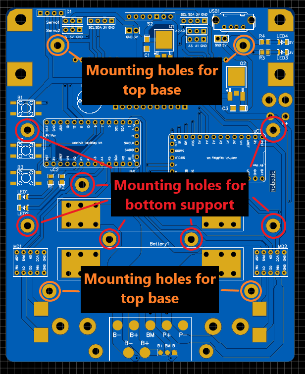

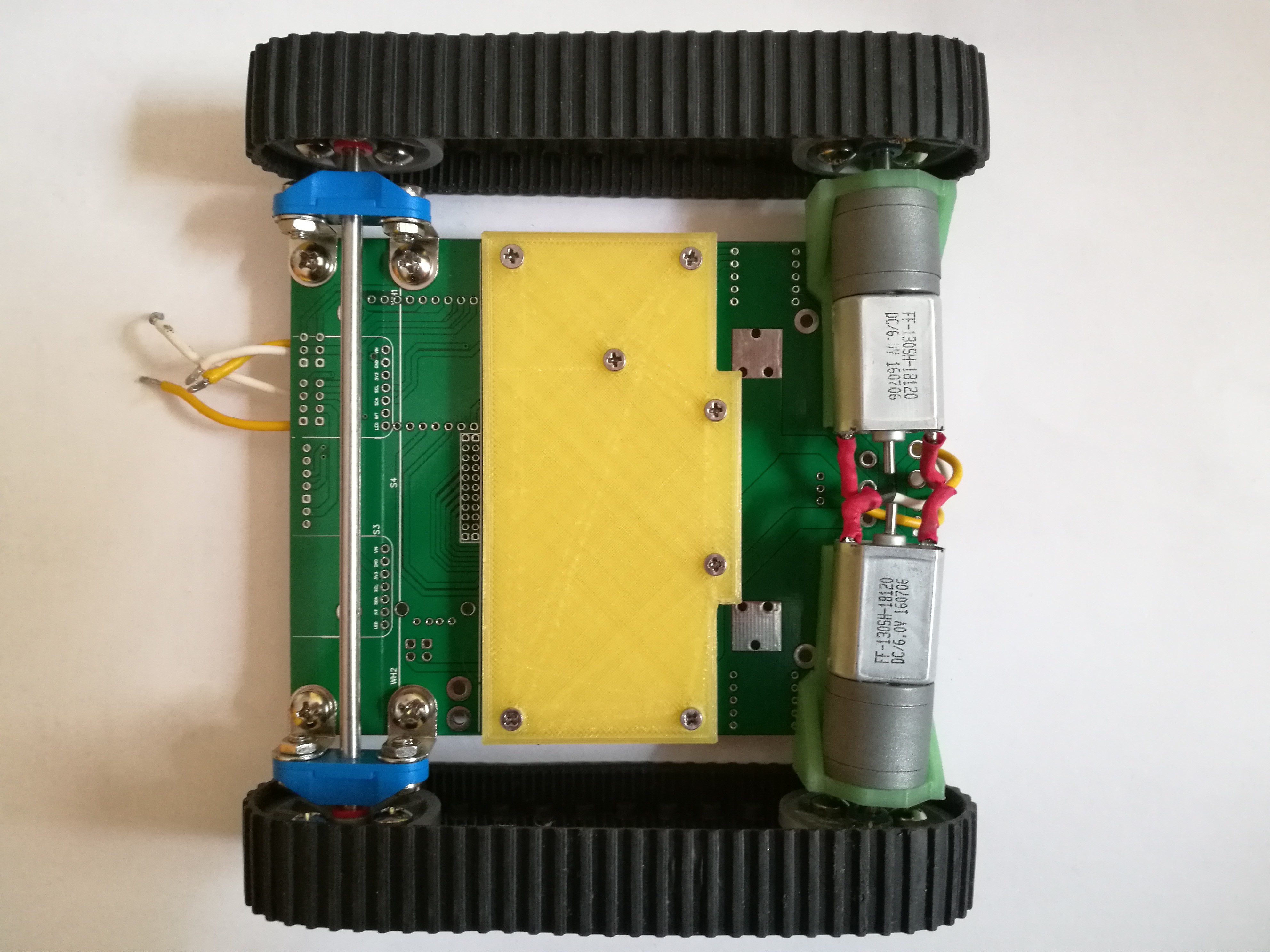

The robot has one big PCB as a base where everything is mounted to (sensors, motors and the remaining electronics) instead of an 3D printed base. This allows to directly solder the sensors to the PCB instead of using many cables.
On the top of the PCB will be a 3D printed base mounted (with distance sensors and servos) to rescue the victims in the evacuation zone.

Robot (bottom) with motors, green support plate and sensors

    First we've fully assembled the new PCB and tested it. Everything worked as expected.
    We improved the support plate and designed a new motor mounting bracket which is now more stable, made custom brackets for the shaft of the front wheels and designed new wheels which are better compatible with our tracks.
    For the color sensor to detect green we had to cut 2 small pieces of a black rubber tube and glue it on the color sensors. We also glued a plastic plate between the color sensor and the light sensor to prevent external light interference.
    On the software side we programmed everything to follow the line, detect green points and the obstacle. The only thing that is left to do is to prevent the robot from detecting green points which are directly after the black line placed.
    With the 3 buttons we can start/stop the robot, change the direction where it turns to when it detects the obstacle and we can re-calibrate the light sensor array (calibration data is saved on the flash).
    I will make a new log when I made some further progress on the robot in some weeks.
  • PCB V1.1 Ready
    GameArea15807/13/2019 at 13:03 0 comments
    PCB V1.1
    PCB V1.1
    This is Version 1.1 of the PCB. I only need to do some minor changes until I order this board in a few days.
    I have fixed all errors and made some improvments.
    The biggest change is that I now use 2 Adafruit ItsyBitsy M4's instead of one and an ESP-32.
    Also there is now space for a buzzer and there is a voltage divider circuit to measure the battery voltage.
  • PCB V1 (Some errors)
    GameArea15807/13/2019 at 12:55 0 comments
    PCB V1
    PCB V1
    This is Version 1 of the PCB. I already tested it. Everything fits correctly but I have made some errors. The biggest problem is that I have used a 0.2mm spacing instead of the 0.1 inch spacing for the holes at the light sensor array.
    I'm now working on V1.1.
