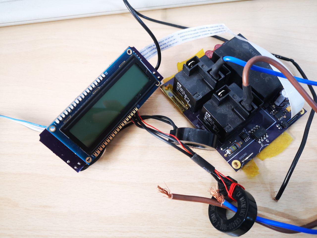

Yep, I'm mentioning that on my article too, I'll definitely check your schematics :) BTW, your name sounded familiar, so I dug up my OpenEVSE and found out I'm your customer too! :) http://www.mastrogippo.it/wp-content/uploads/2019/09/photo_2019-09-30_23-24-39.jpg
