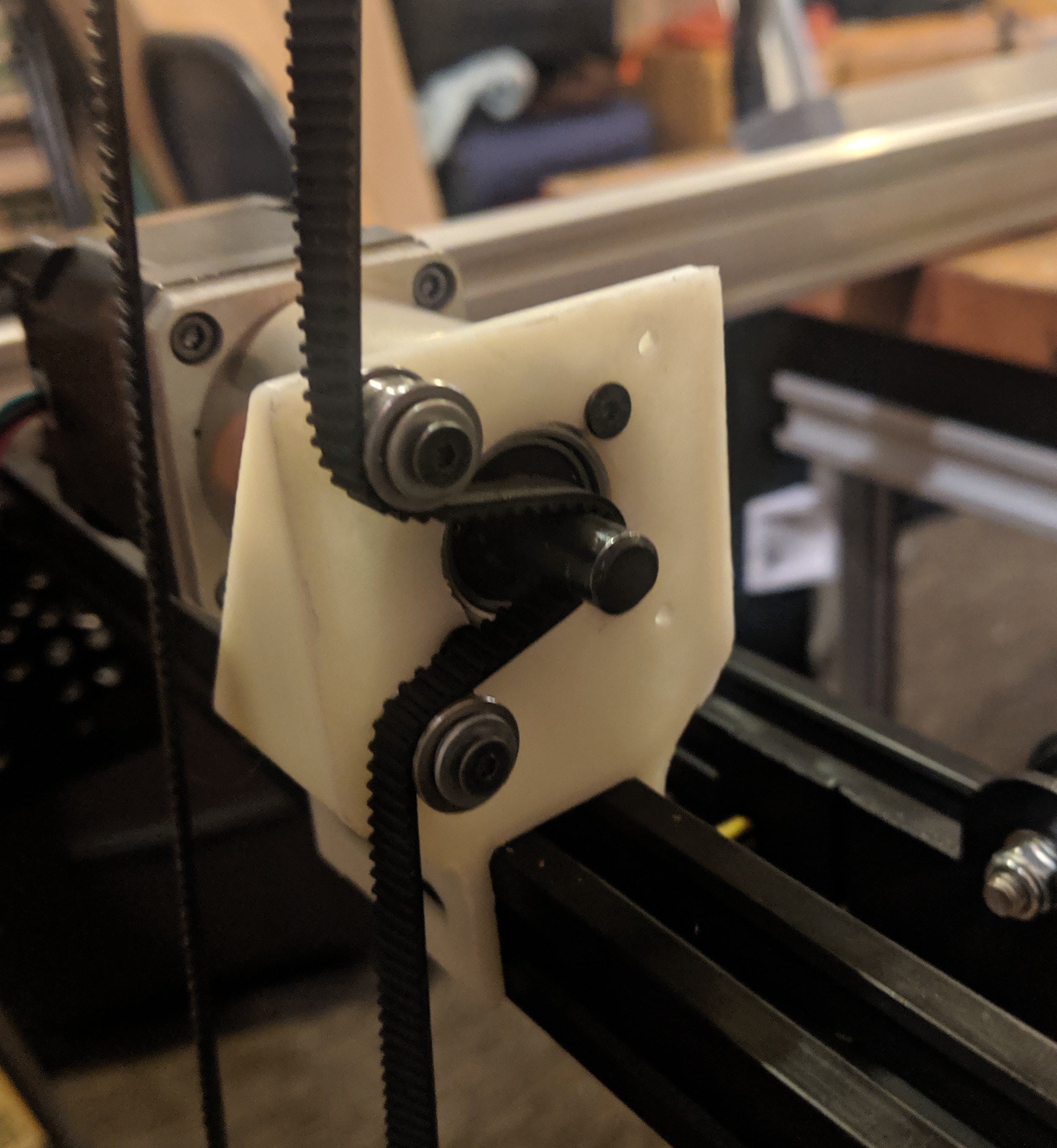

    Z axis mount is both machinable and printable. Because the goal is to have a heated chamber print in a high temp plastic like ABS or better PC, PEEK, Ultem etc. Depending on mounting it is possible this mount will not have any direct heat within the chamber. More on that later.
    Potential mounting solution. Still searching for a 6mm ID GT2 belt.

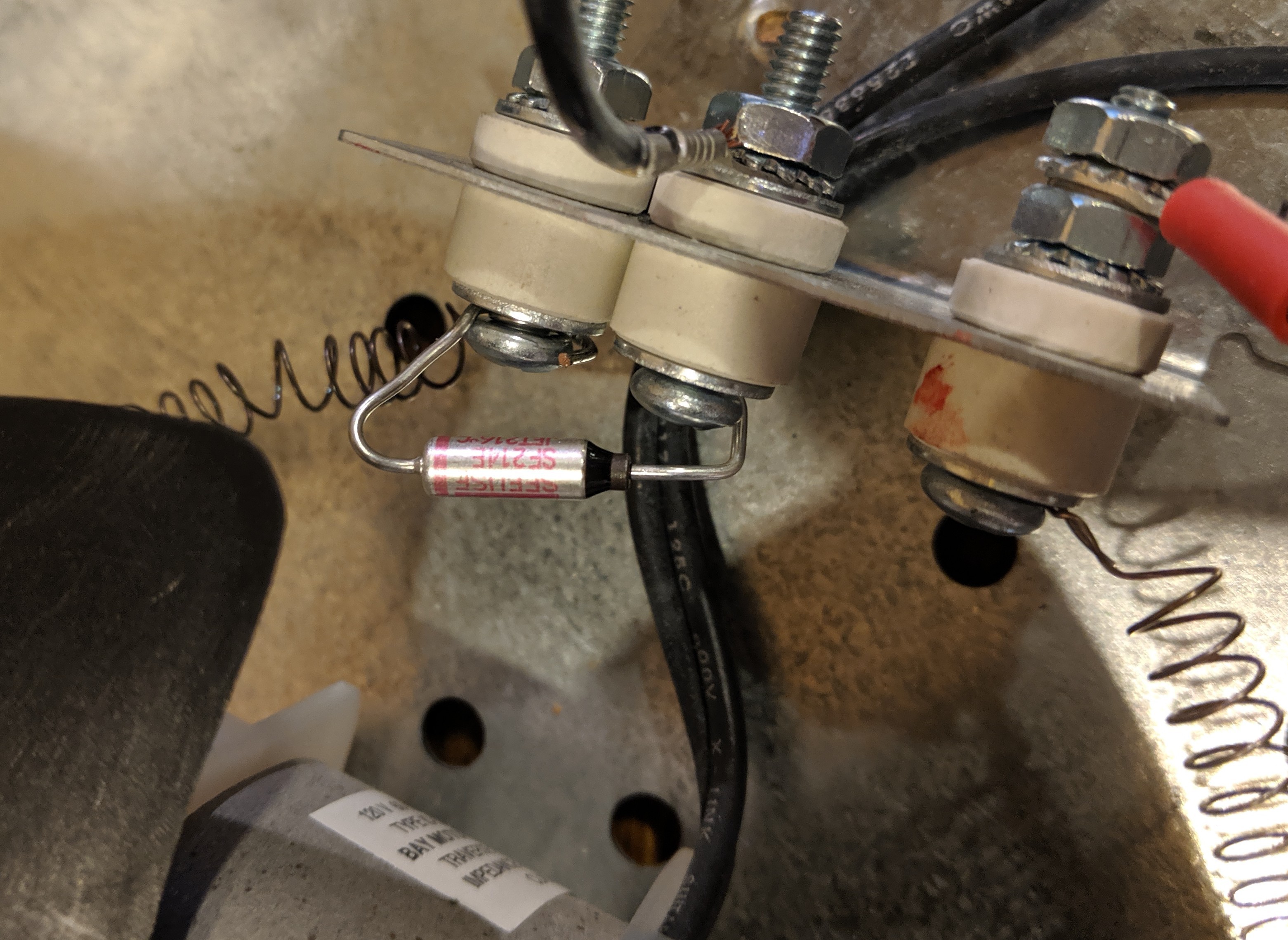

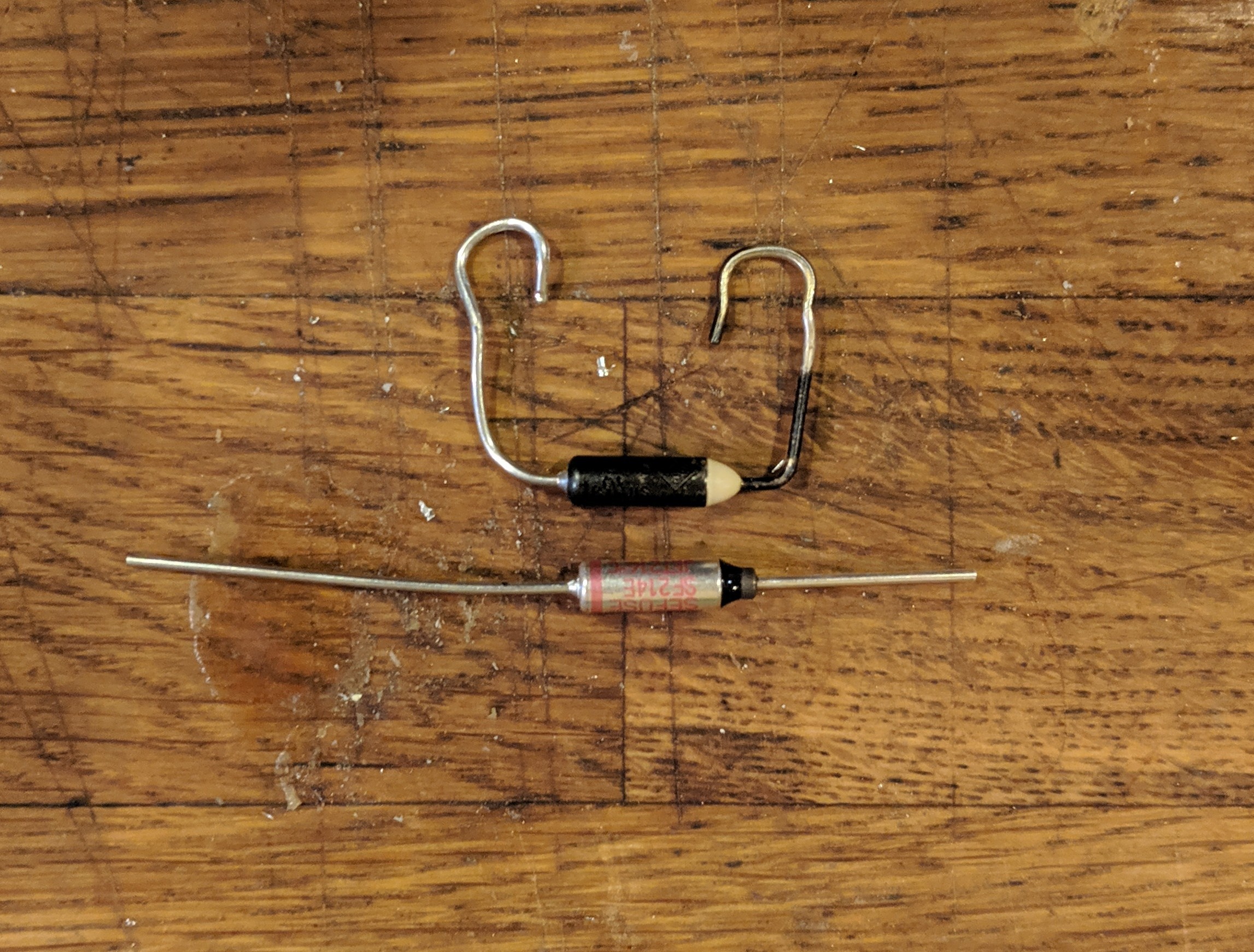

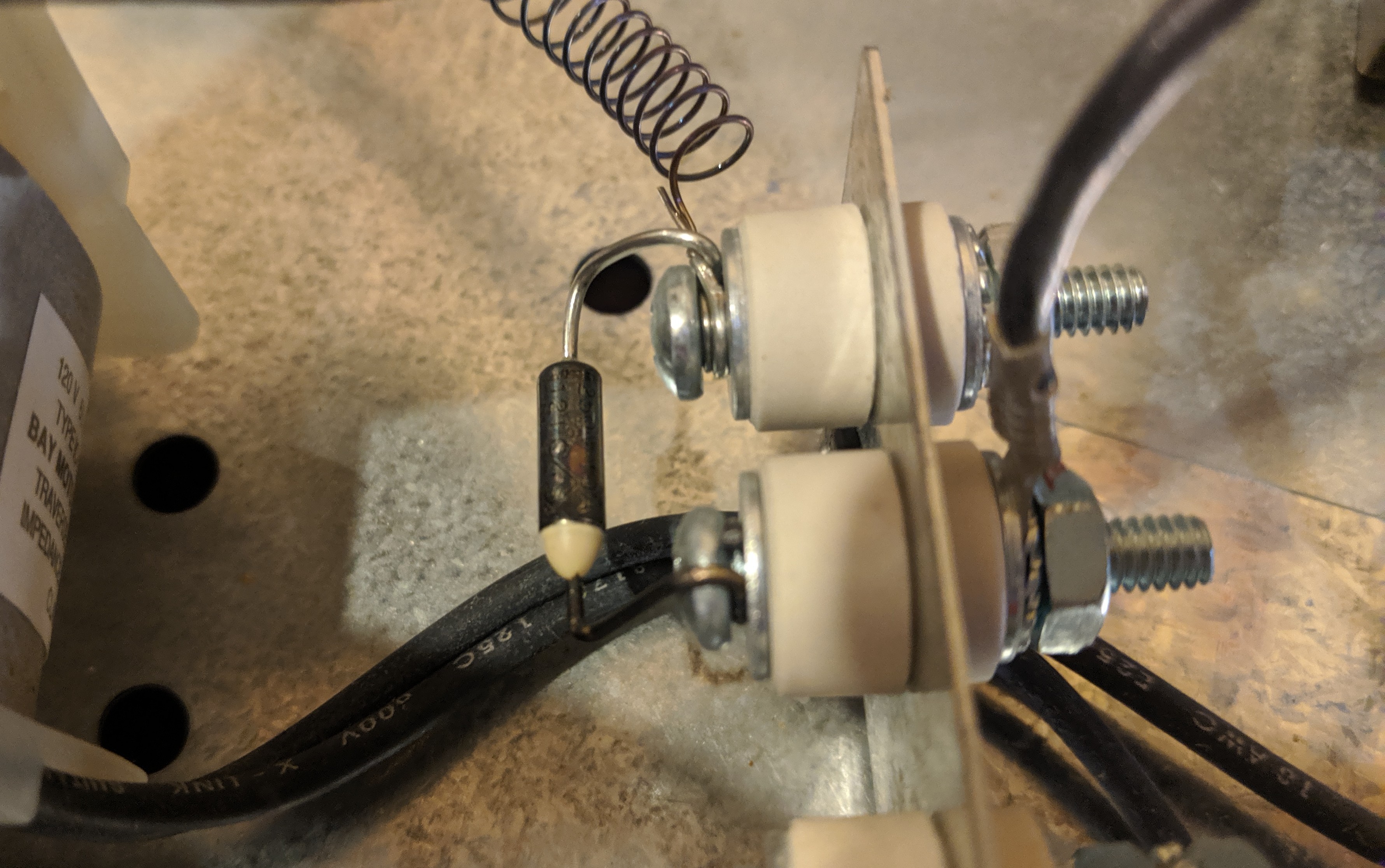

    Food dehydrators, toasters and many other coil driven heating systems have very simple circuits. The upper limit of the system is controlled by a thermal fuse and have a potentiometer for adjusting temperature. For this loaner unit original fuse was rated for about 80c. Perfect for pla and petg which have lower then 80c glass transitional temps. Because this build is focusing on the higher temp ABS the requirements are for at least 110c. Opting for a much higher rates fuse a 216c fuse was selected so further testing at higher temps can be tested. DISCLAIMER AND WARNING! This is so far untested and might burn out if full power is used. Please use caution when altering heating devices!

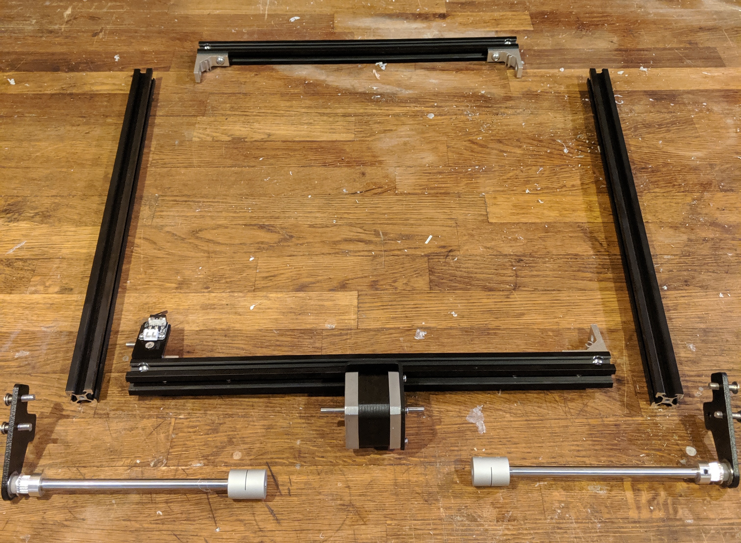

    Start disassembling your ender5. You want to remove all electronic wires and set the lower portion aside leaving what you see here.

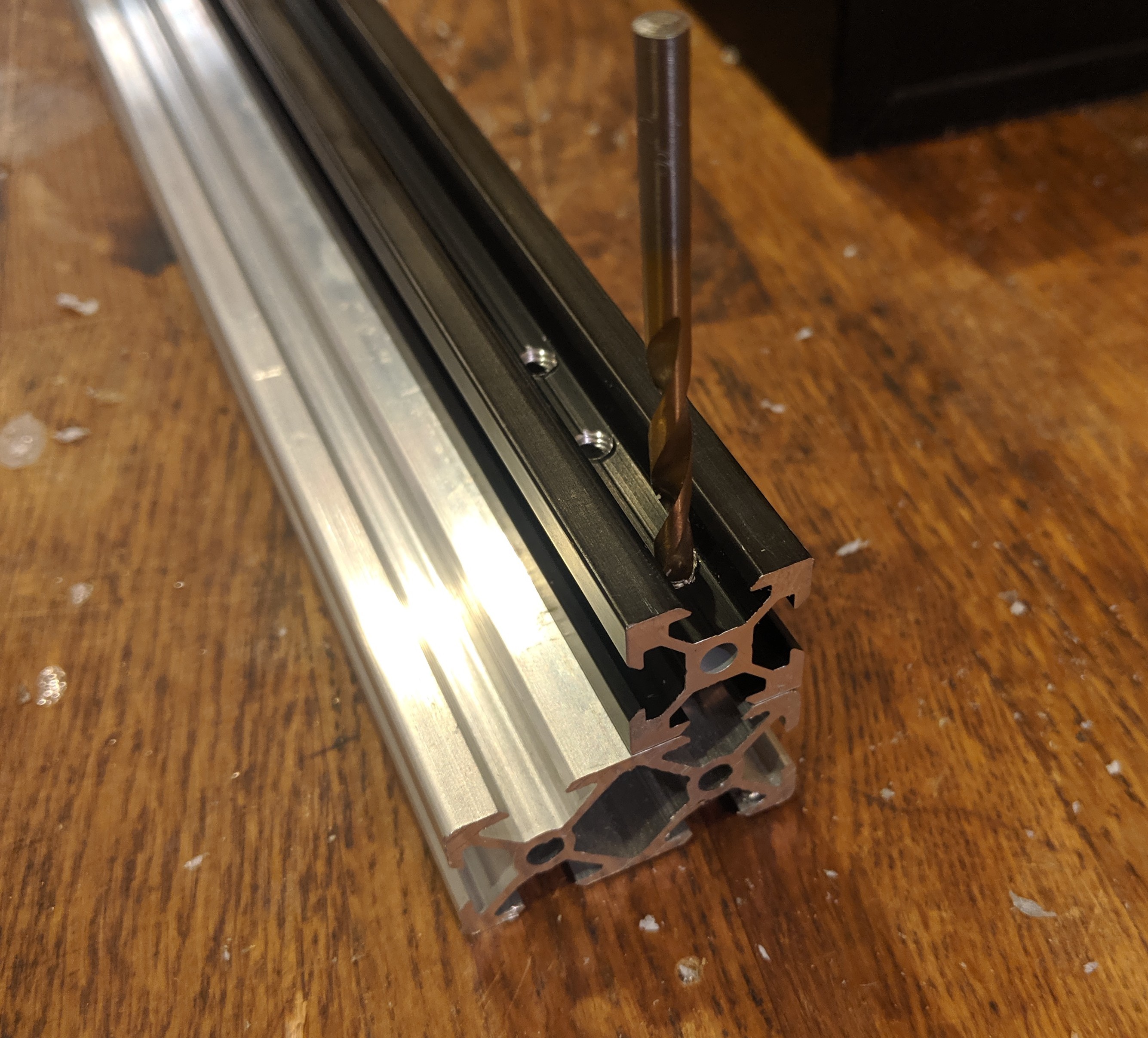

    Use the side rails as a drilling guide. As shown below. Notice for this build 2040 extrusion was selected but is not required. The ender5 has 3x M5 threaded holes on one end and the other is a single M5 threaded hole. The drill bit should be properly sized for threading. Because in the US it is expensive to source metric drilling bits the imperial equivalent is 0.161 inch or a #20 if you have a full drill set.
    If you have clamps great grab them and lock that firmly to the end. If you don't and have been printing with ABS you can use ABS juice to hold the extrusions down making temporary glue for drilling.
    Your drilling should be very close to factory. Don't worry about the remaining glue it rubs off without any challenge.
    Now let's do the same to the other side.
    Next tap all 4 holes you just made with an M5 thread tap. At the same time glue your next extrusion down so it has time to set while you tap threads.
