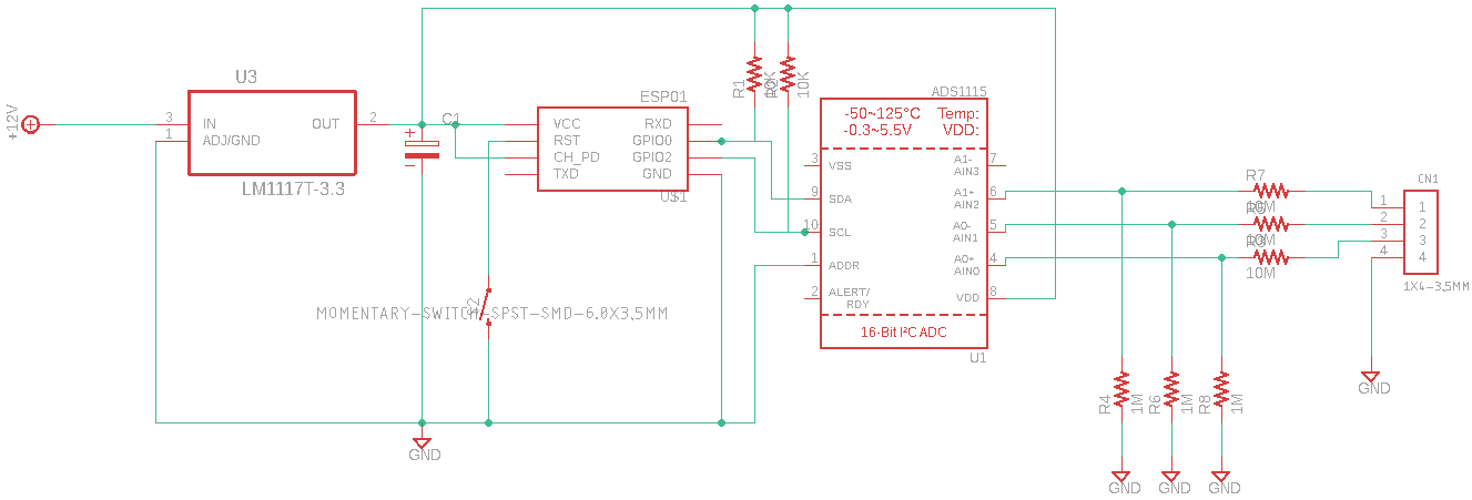

The plan is to utilize an ESP-01 and a ADS1115-4-Channel-16-Bit-I2C to read the voltage of both of the RV house batteries as well as the engine starting battery and send a status email if any of the voltages become too low while the RV is in storage.
