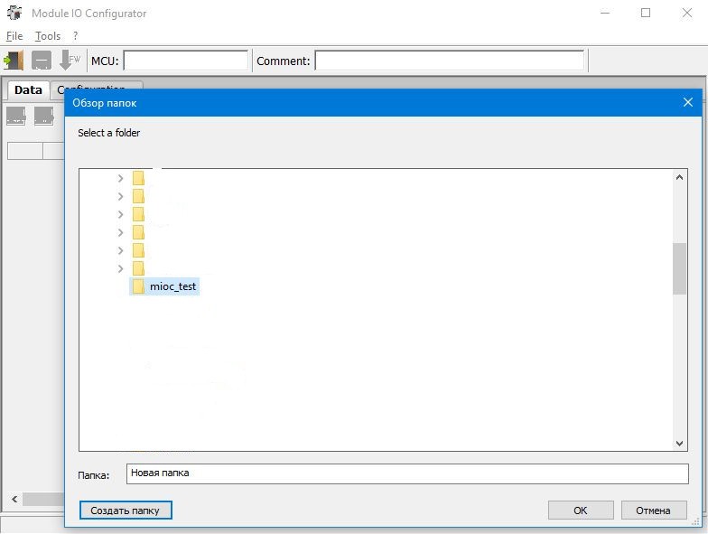

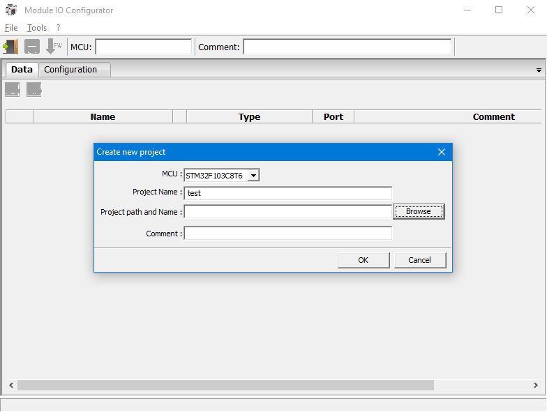

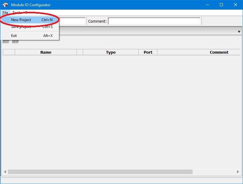

Create a project:

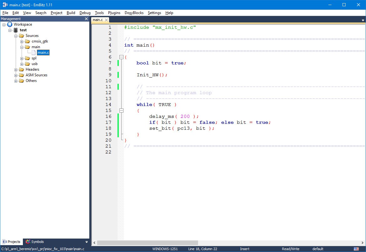

In the main.c file, write the following:
(To increase the size of the image, open it in a new tab)

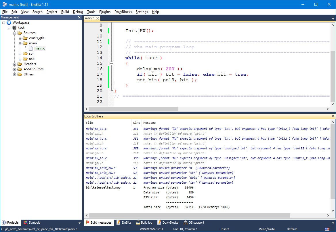

In EmBitz, press F2, after the information window appears, press F7, compilation will be performed. Pressing F2 again will hide the information bookmarks.
Download to the microcontroller, look how it works.
