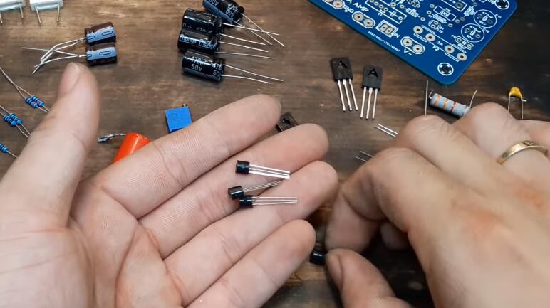

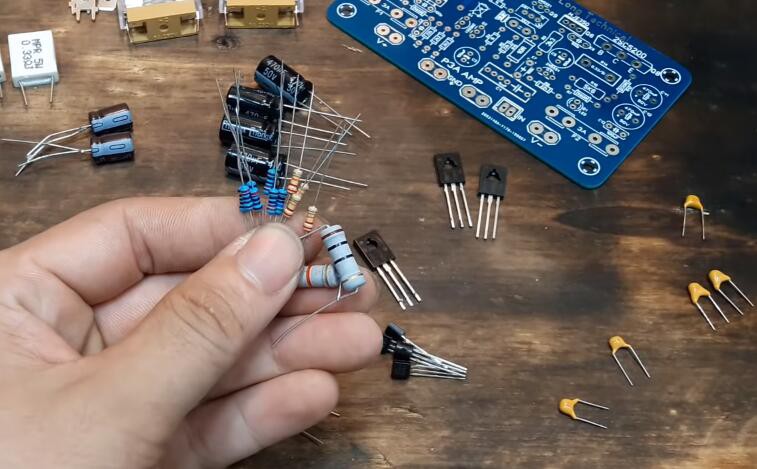

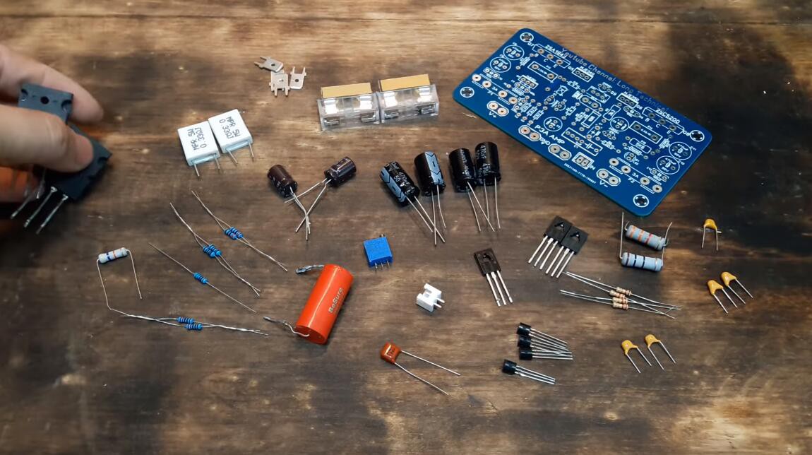

1. Parts we need in the project.

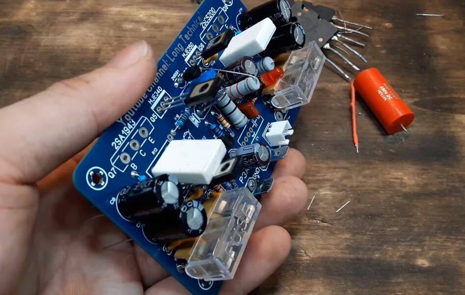

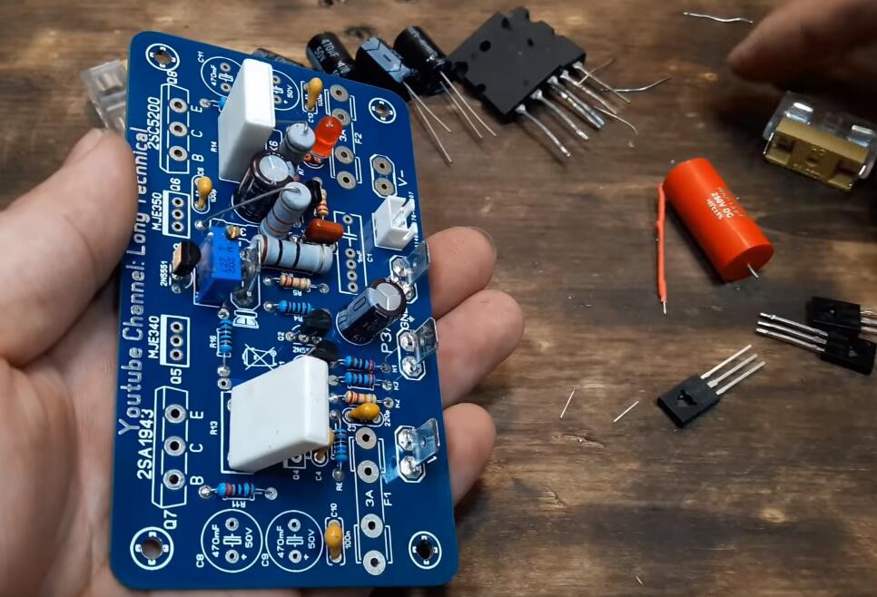

2. Solder the parts on the board and solder.

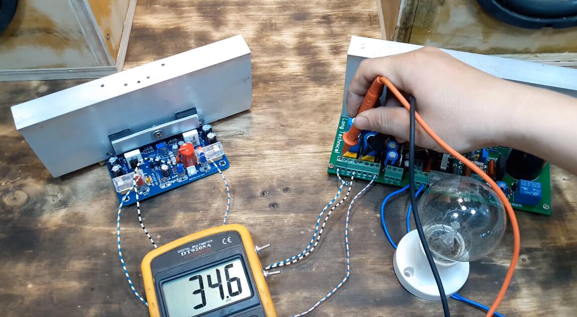

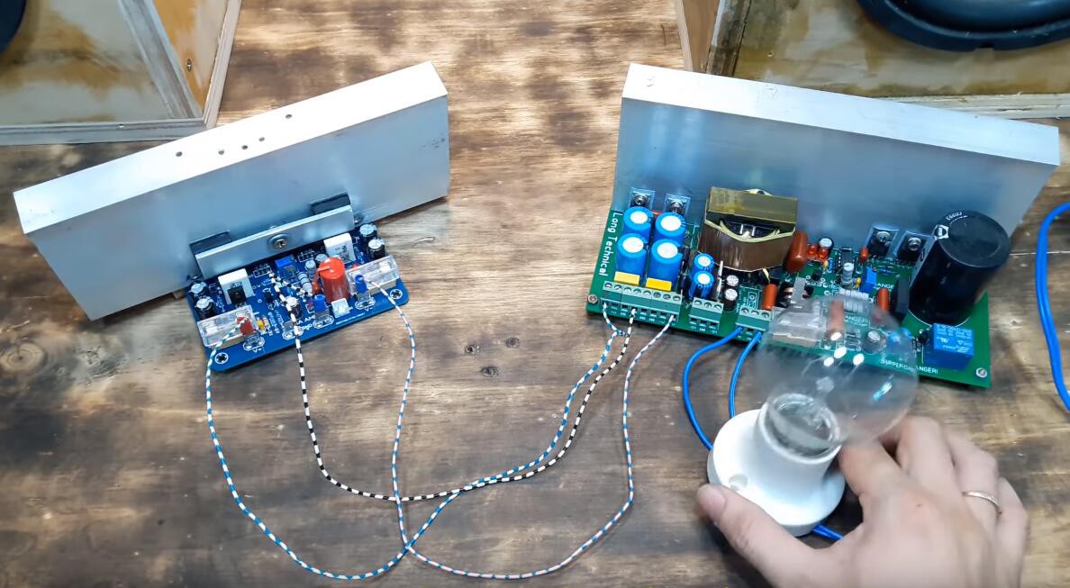

3. Test and adjust VR.

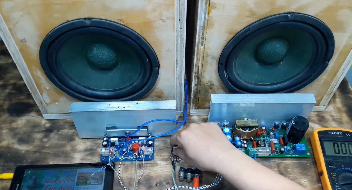

4. Finished and test it with audio.
Product lists:
Transistors:
• Q1, Q2, Q3, Q9 - BC546 - 4 pcs. http://bit.ly/2FpTGNV
• Q4, Q6 - BD140 or MJE15035 or MJE350- 2 pcs. http://bit.ly/2HC9qPC
• Q5 - BD139 or MJE15034 or MJE340- 1 pc. http://bit.ly/2F6QENs

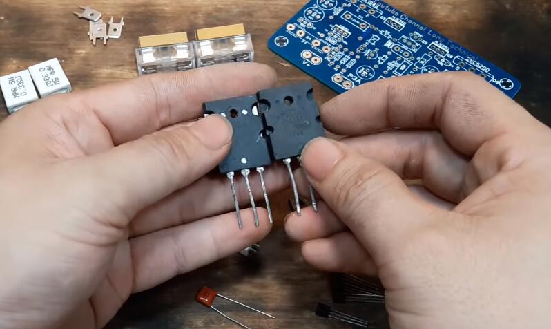

• Q7 - MJL4302 / MJL21193 / MJW1302/ 2SC5200 - 1 pc. http://bit.ly/2FiPlMV
• Q8 - MJL4281 / MJL21194 / MJW3281/2SA1943 - 1 pc. http://bit.ly/2O8mLR4
Resistors:
• R1, R3, R4 - 1k - 3 pcs. http://bit.ly/2XXF9R3
• R2, R8, R5 - 22k - 3 pcs. http://bit.ly/2soUICX
• R6, R7 - 560R - 2 pcs. http://bit.ly/2FurJo2
• R9, R10 - 3k3 - 1W - 2 pcs. http://bit.ly/2OVtmP3
• R11, R12 - 220R - 2 pcs. http://bit.ly/2YYRKUu

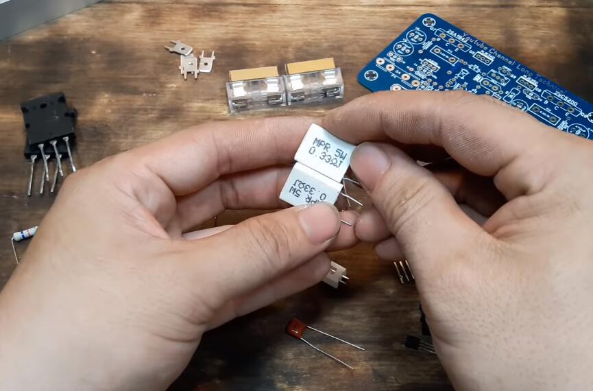

• R13, R14 - 0R33 / 5W - 2 pcs. http://bit.ly/2FvsUUr
• R15 - 10R / 2W - 1 pc. http://bit.ly/2GmIgeP
• R16 - 1k - 1 pc. http://bit.ly/2XXF9R3

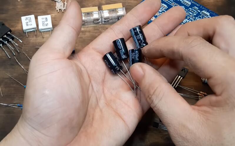

Condensers:
• C1 - 4,7mF / 25V - 1 pc. (on C1 - 1mF non-polar / film board) http://bit.ly/2Cp86f0
• C2, C4, C6 - 100pF - 3 pcs. http://bit.ly/2WqdBlZ
• C3, C5 - 100mF / 50V - 2 pcs. http://bit.ly/2X6Kg4M
• C7, C10, C13-100n - 3 pcs. http://bit.ly/2QK6ph7
• C8, C9, C11, C12 - 470mF / 50V - 3 pcs. http://bit.ly/2V58Xck
• D1 - LED 5mm - 1 pc. http://bit.ly/2IkuH1s
• Fuse 3A + block for mounting on the board - 2 pcs. http://bit.ly/2XdYc9g
