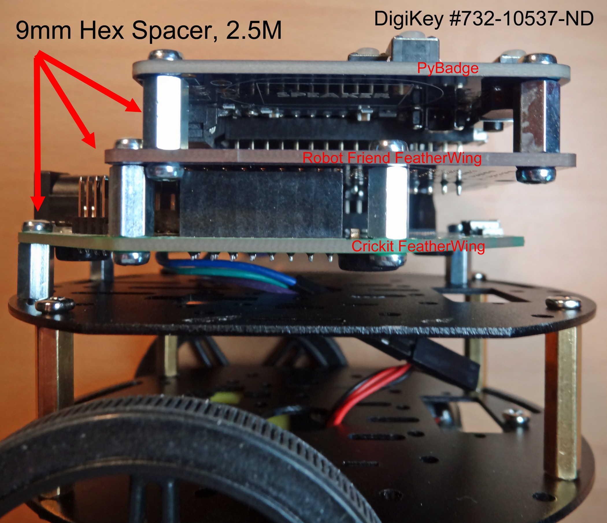

Update: The 9mm spacers worked nicely
A project log for Cedar Grove Robot Friend FeatherWing
A passive FeatherWing adapter for stacking an Adafruit PyBadge or PyGamer onto a Crickit FeatherWing.
CedarCedar 11/22/2019 at 02:180 Comments
Replaced the 8mm nylon with the 9mm steel hex spacers. Also replaced the nylon M2.5 x 0.45 screws with their metal counterparts. The steel spacer diameter is slightly larger than the nylon causing a tight fit, but with a little care, no issues were encountered. The DigiKey part number of the spacers is 732-10537-ND.
