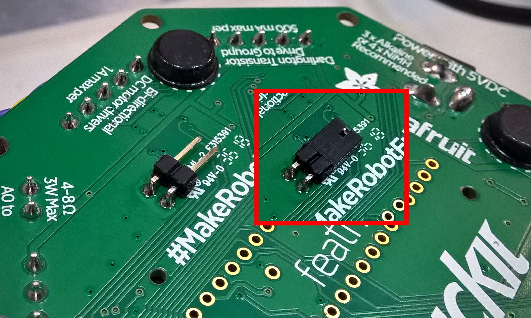

Using the Adafruit Crickit FeatherWing's on-board audio amplifier requires installation of the Audio jumper to connect the attached Feather's A0 pin. The jumper doesn't need to be permanent if a pair of 0.1-inch angled header pins are installed on the underside of the Crickit PCB.
