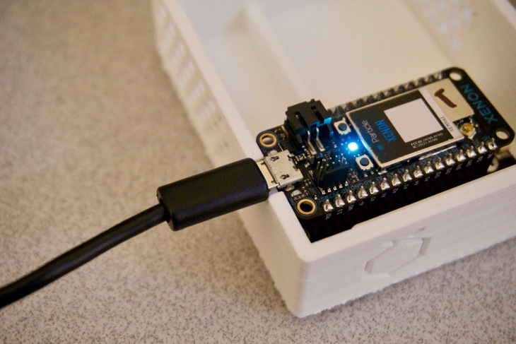

Using USB - connect a Micro-B USB cable into a port that can supply at least 500mA. That will ensure that it will power your Particle Mesh Board as well as the Air Quality Wing. If you are using a Boron, make sure that the source can provide at least 1A of current.
Power using USB

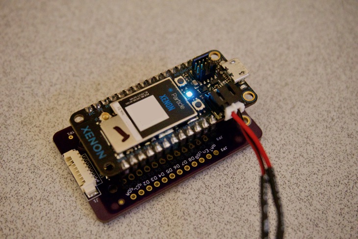

Using battery - similarly, you will have to size the battery to how long you want to run the Air Quality Wing for. At the very least, it’s recommended to use a lithium battery larger than 100mAh. This will ensure that the HPMA115 will get enough current to take measurements.
Power using battery

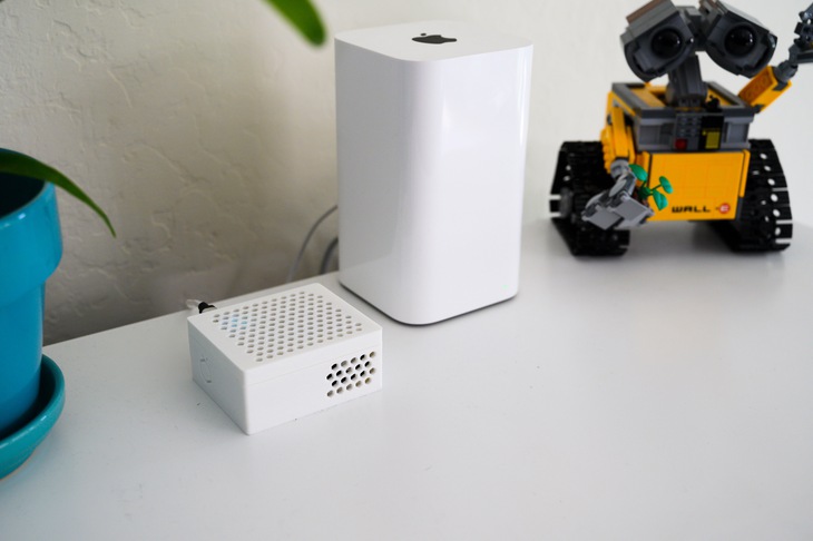

    If you’re wondering, yes there’s an enclosure! Many thanks to the designer, Nicholas, for taking the time to make this amazing enclosure.
    Air Quality Wing Enclosure
    Provided courtesy of Nicholas.
    You can print your own by downloading the STL files in this Github repository.

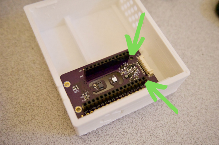

    Side note: as of this writing, there are some issues with holes lining up with the holes on the board. Only the stand-offs should be used:
    Installation tip 1

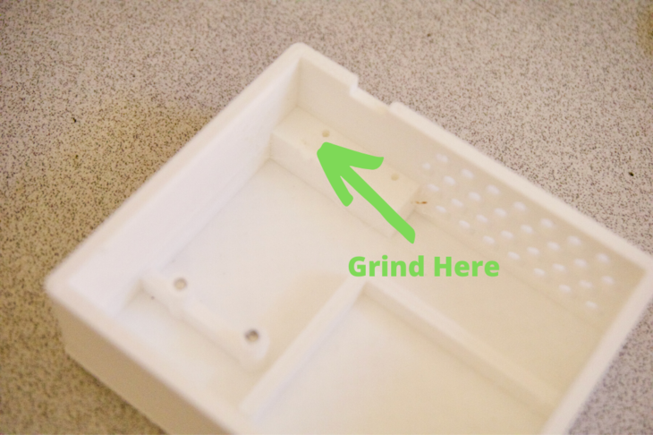

    Also you may have to grind away at the area closest to the USB connector.
    Installation tip 2
    This is due to the header bits extending beyond the bottom of the board.
