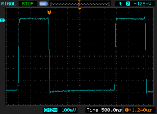

The gate drive waveforms are very good (scale is 1/10x):
The above trace is the top gate waveform. The trace below is of the bottom gate.
These traces show very little ringing associated with parasitic, or stray, inductance.
