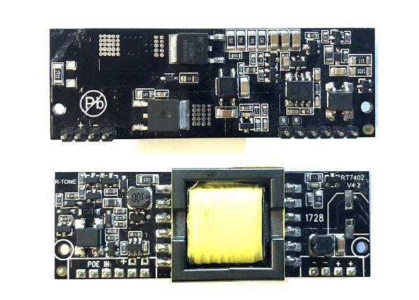

we design PoE function for BPI-R64 ,so easy to add PoE module to support PoE function,PoE modue can support 12V/3A to power BPI-R64
BPI-7402 PoE module on BPI-R64:
BPI-7402 PoE module wiki page:http://wiki.banana-pi.org/BPI-7402_IEEE_802.3at_PoE_module
