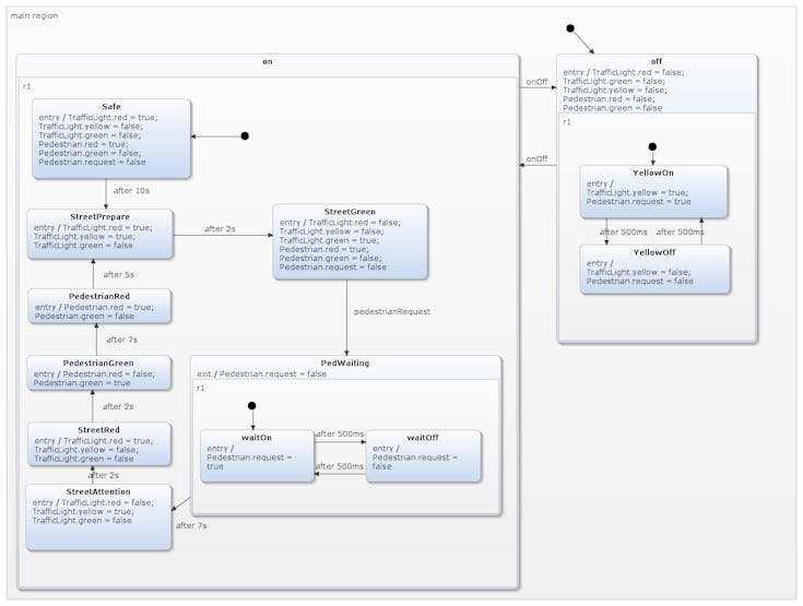

The model looks like this:
YAKINDU Statechart Tools
So, as you can see there are two main states with composite members - state on and state off. You can switch between both states by using the event onOff, which is wired to the ON/OFF button. In the initial state, the off state, both yellow LEDs start blinking every second. Once the traffic light has been turned on, it starts in the Safe state. After 10 seconds the typical behavior of the traffic lights will be handled. The red and yellow LED will be turned on in the StreetPrepare state and the traffic light turns green after 2 more seconds. From now on, the state machine is waiting for the pedestrianRequest event, which is wired to the second button. After sending the event the request will be indicated by toggling the yellow LED every second in the PedWating state. 7 seconds later the traffic light will be switched to yellow first and then to red, until the pedestrians get the signal to go in the PedestrianGreen state. After this the PedestrianRed is activated and the cycle repeats. This can only be interrupted by turning the traffic light off again.
